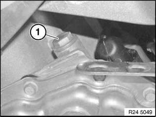

Remove exhaust bracket (1).
See pic 1

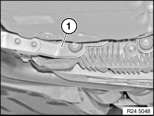

Topping up transmission oil after a repair:
See pic 2
Stand vehicle on a level surface and secure against rolling off.
Undo oil filler plug (1).
Installation note:
Replace the sealing ring.
Top up automatic transmission fluid until it emerges from oil filler opening.
Start engine.
Screw in oil filler plug (1).
