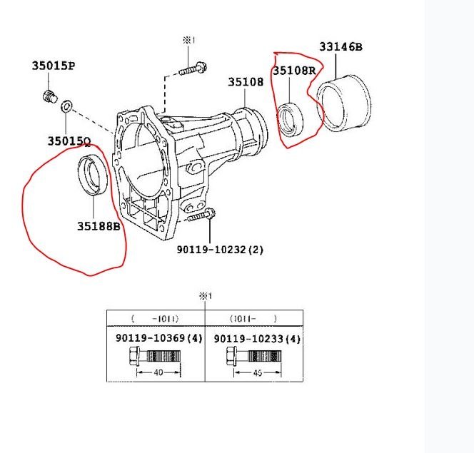

Does transmission extension have a bushing?
2007 TOYOTA TUNDRA
140,000 MILES • 5.7L • V8 • 2WD • AUTOMATIC
TANYABRO123

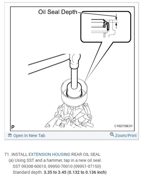

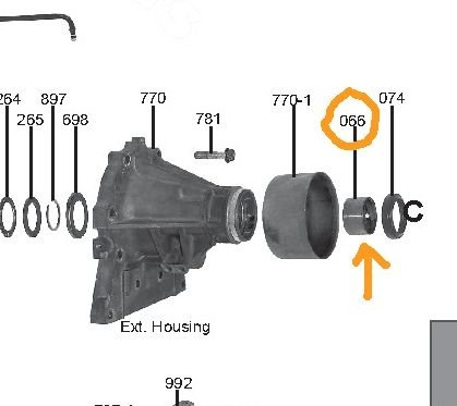

Need to replace the seal but if it has a bushing, I’ll replace that too.
Oct 6, 2021 at 6:52 PM
STEVE W.
  • 15,349 POSTS
The service information doesn't show it, but Toyota calls out part 35188-35010 as an extension housing bushing retainer so it has one. However, it looks like it isn't replaceable unless you remove the extension and remove the retainer that is inside the housing. Precision lists the bushing as part IPN6-86251.
