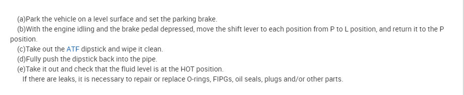

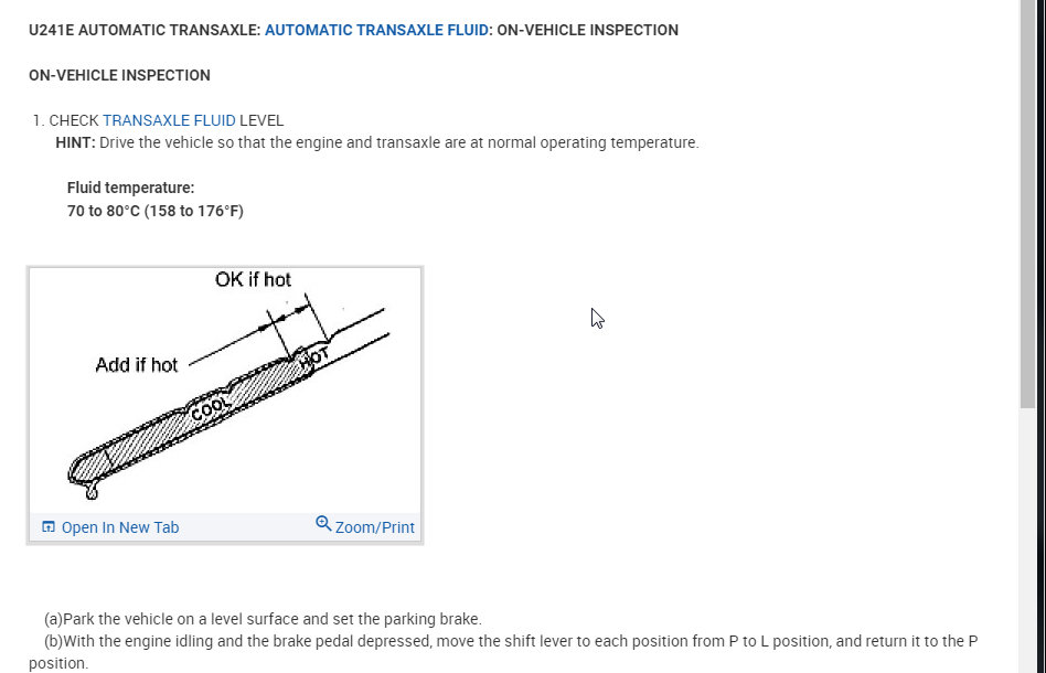

Thank you. This helps a lot I actually drive it this morning to drop my wife to work then when I got back I decided to check on the fluid again. So I parked with the car still on and in park. I pulled the transmission stick to check the level as the car was warmed up. The stick was over hot. So i dipped back in and pulled out again this time it was dry, no fluid on stick. i also noticed the car when driving is fighting to push forward. It seems like it's going but something keeps holding it back at times . I will accelerate and the car would go but it's not going 100% .
Nov 29, 2019 at 9:19 AM
Okay. The first time you pull the stick out you need to wipe it off because this will have fluid on it due to it splashing up on it. When you wipe it off and dip it again, that is the accurate reading so you are low on fluid and need to fill it. This may be the only issue so if it is, I would go ahead and get it serviced.
