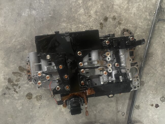

while removing the valve body to change 2 solenoids, the e-module broke as the harness connector was stuck to the case. I need to get another. What do I need to do? program it? I know if I get a TCM I have to program it but is there an option to program this part only if that is all I buy? the piece is what is in the picture

Service info says you replace the module and the control module does the rest. No programming needed.

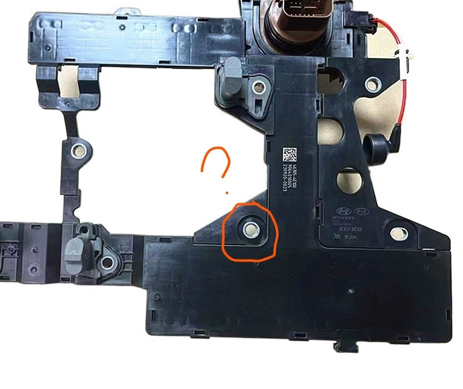

can u check the tsb below and go to step 10 and tell me if you see a circle like they say? it says to insert the short bolt there

Sorry for the late response, site has been having issues. Looked at the TSB from a few sources, the only thing that looks like a circle is the recessed bolt in the original. The one I circled in this image. What you could do is take a piece of wire, run it into each hole where it bottoms, then use it to find the shallower hole.
