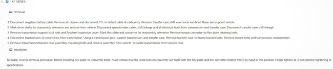

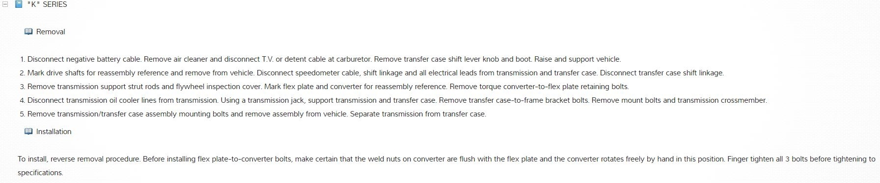

Drop the transmission pan and see if there is a lot of debris in the pan, if so it had to come off something and fallen down there, most likely a clutch disc has burned up.
If there is no debris, have the transmission rebuilt or install a new or re-manufactured one even a salvage one.
There is obviously something wrong within the transmission.
