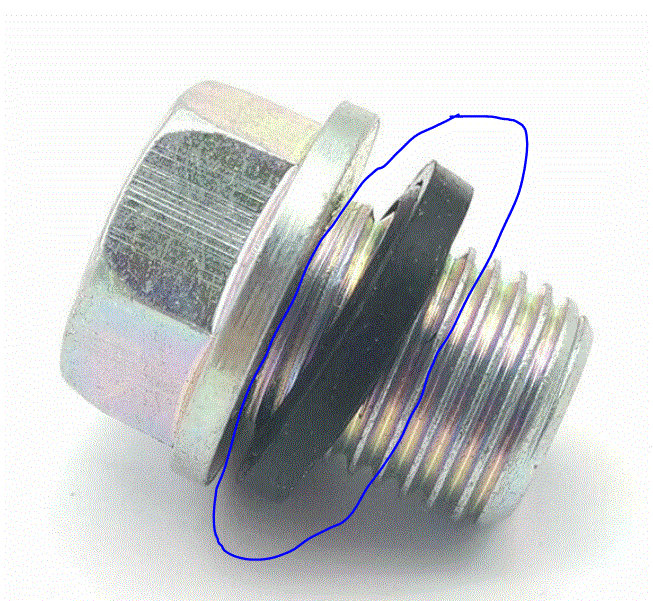

Did you replace the drain plug gasket/o-ring? See pic below. Let me know if that was replaced.
Oct 22, 2021 at 12:10 PM
FARR2007
  • 244 POSTS
I replaced the metal crush washer yes.
Oct 27, 2021 at 11:56 AM
  • 110,248 POSTS
If you replaced the washer/gasket and it still leaks, inspect the area around the plug for evidence of cracks. Also, spray everything down so it's dry and clean. Then confirm the leak is from the drain plug. If there are cracks causing it, you should be able to see the fluid seeping through them.

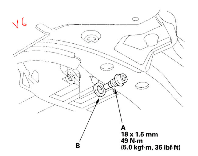

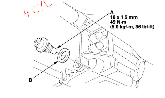

how tight do I tighten new crush washer and plug?
Oct 28, 2021 at 3:57 PM
  • 110,248 POSTS
If you look below, there are two pics that include the torque specifications. I'm not sure if the vehicle has a 4 cylinder or a 6.
The first pic shows the torque for a V6 and the second pic is for the four cylinder.
Let me know if this helps.

If you replaced the gasket and torqued it to specification, there has to be a crack we are missing. You have confirmed the leak is from the drain plug, correct? I know you were originally questioning possible cracks.
Also, when you replaced the metal crush washer, was it only metal? You may want to try a nylon or composite washer/gasket in place of the crush washer.

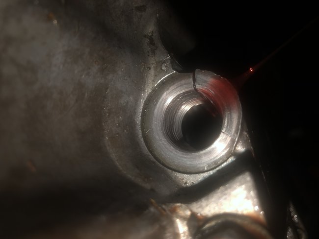

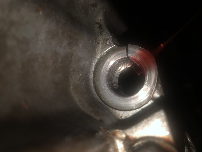

I don’t know for sure if this is the crack you are referring to, but I have attached pics. please advise me on how I can repair?

So, went out to check vehicle and the bottom half of transmission bolt hole where crack looked to be is now completely broke off and, on the ground, is there a transmission pan for this car or does it come apart to where I can just replace the side where bolt goes in?

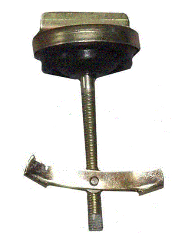

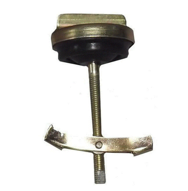

There isn't a pan. As far as the crack, that is part of the case. What I would do is this. First, you need to find someone that can weld aluminum and have that part welded back into place. Then they make "pan savers" that you can use to seal it. (See pic 1 below)
To replace that portion of the case, the transmission needs to be taken apart. I would at least try to do it this way.

It's what I mentioned a few posts back. I reattached the pic below. If you weld it back together, either you will need to drill and re-tap the threads or use a pan saver. It basically works like a toggle bolt. See pic below.
If the weld is done properly, the absolute best thing is to drill and re-tap the threads and use an oversized pan bolt, but the pan saver will work as well.
