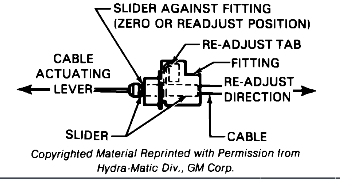

Okay, there is only a solenoid for the overdrive or lock up for the converter.
The shifting is controlled by the throttle cable from the throttle body to the transmission.
I attached the procedure for you to adjust the shift points. By moving the adjustment back and forth, it will change gears higher or lower.
1. Ensure ignition is in the Off position.
2. Depress and hold metal adjustment tab at engine end of T.V. cable, Fig. 4.
3. Move slider until it contacts fitting, then release tab.
4. Check cable for sticking or binding and road test vehicle. Recheck cable after engine has reached normal operating temperature, as cable may appear to operate properly with engine cold.
