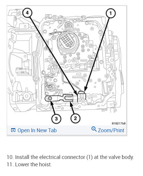

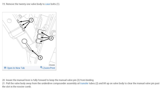

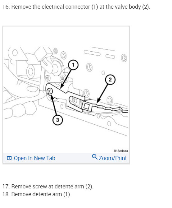

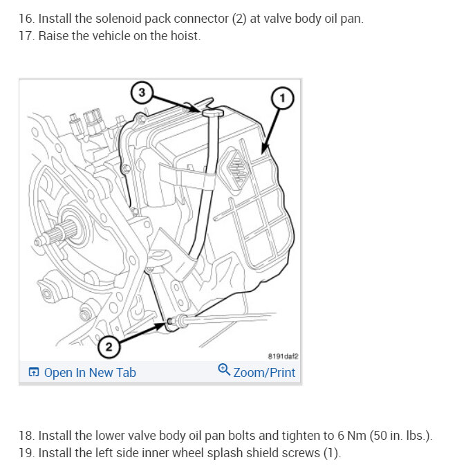

So, i had problem in my van listed above, I can’t get the transmission to reverse i pressed the side button in the shifter I'm pushing it up it basically doesn't move I'm stuck at the D shift and the manual transmission part only, so I need someone to help me with this.

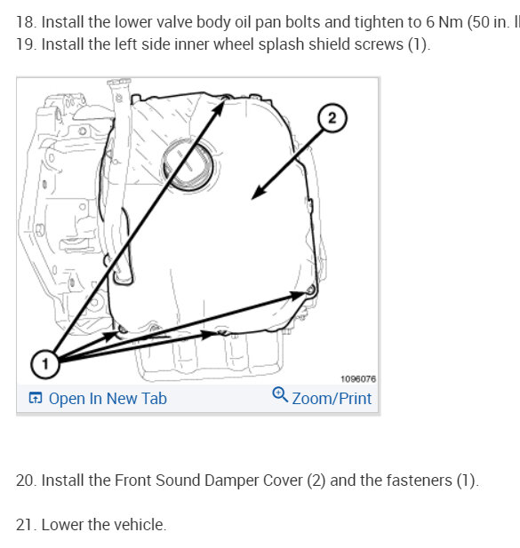

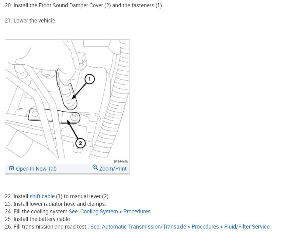

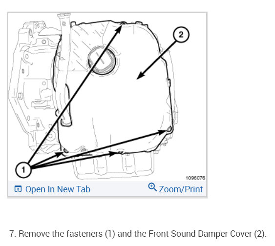

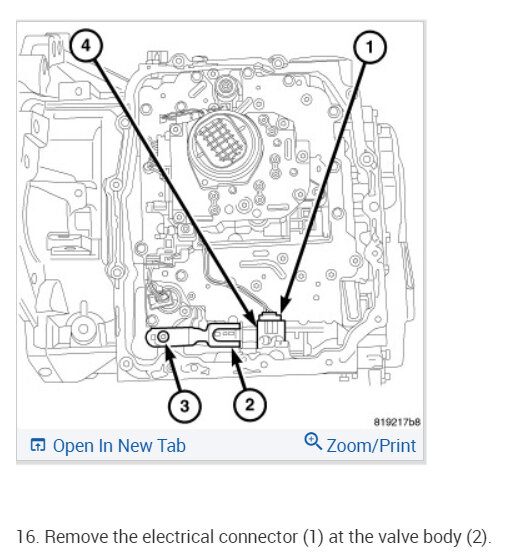

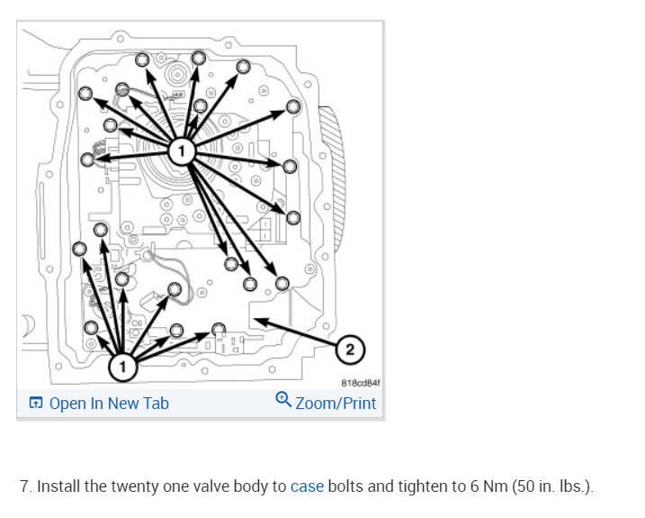

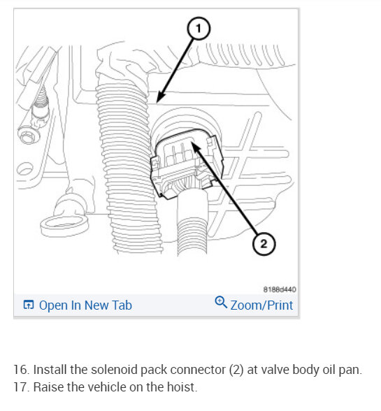

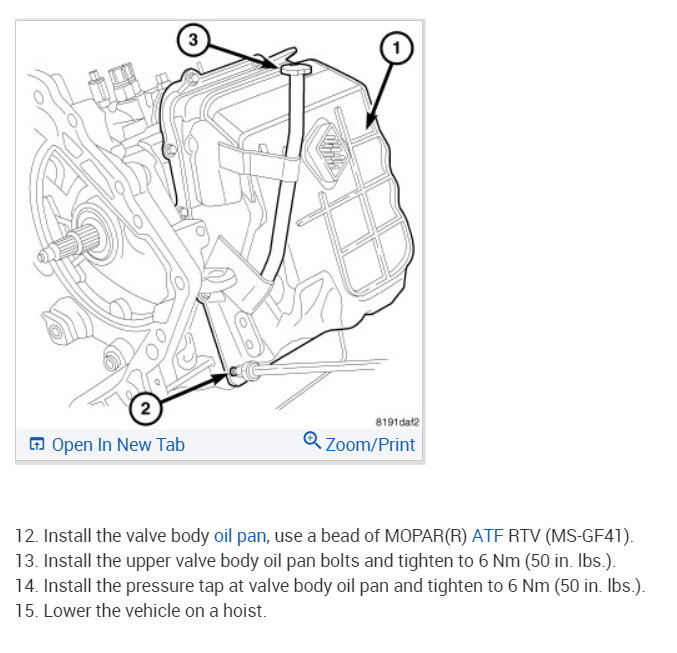

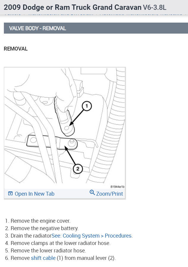

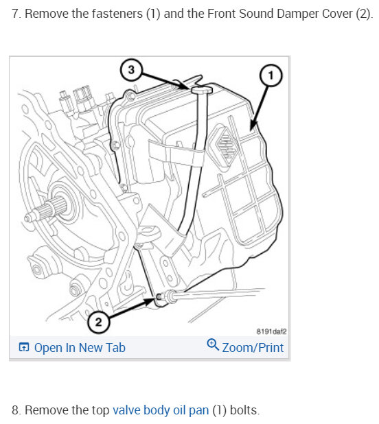

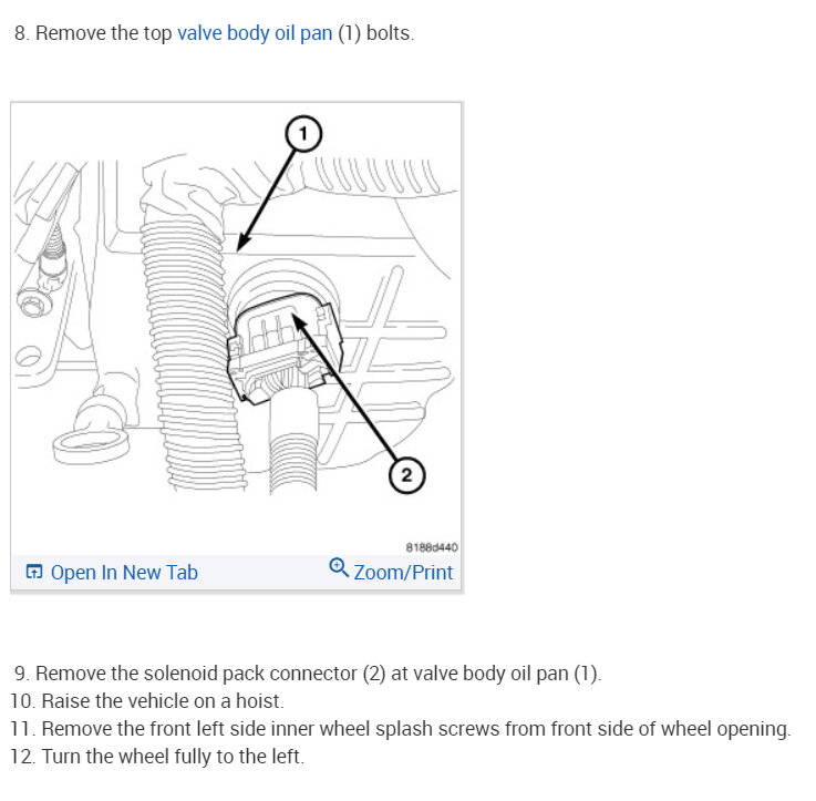

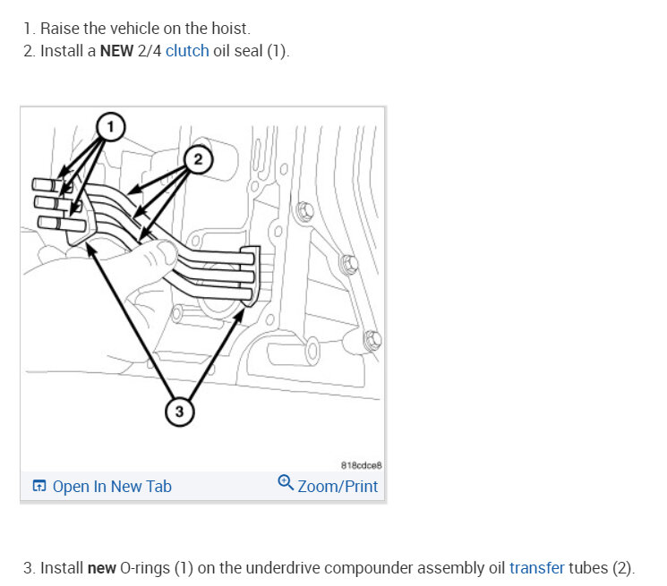

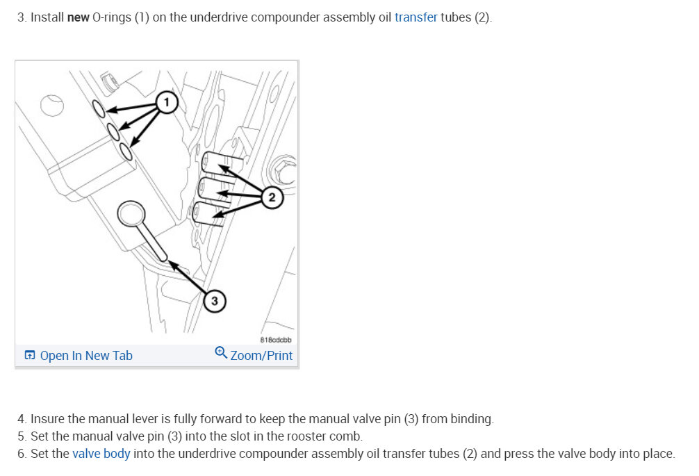

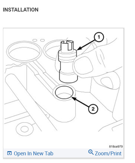

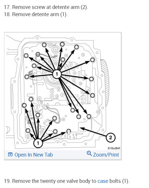

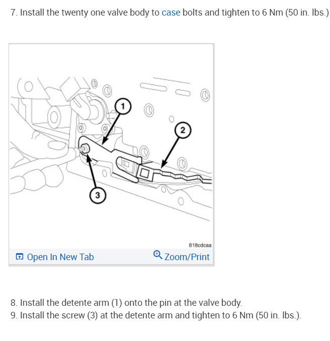

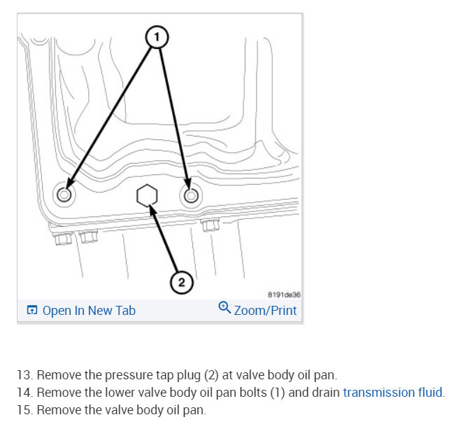

It sounds like the transmission solenoid TRS assembly has gone bad, but we should run the codes to see if any are stored, here is a guide and I have included how to change the transmission solenoid TRS assembly in the images below in case there is a code for it.

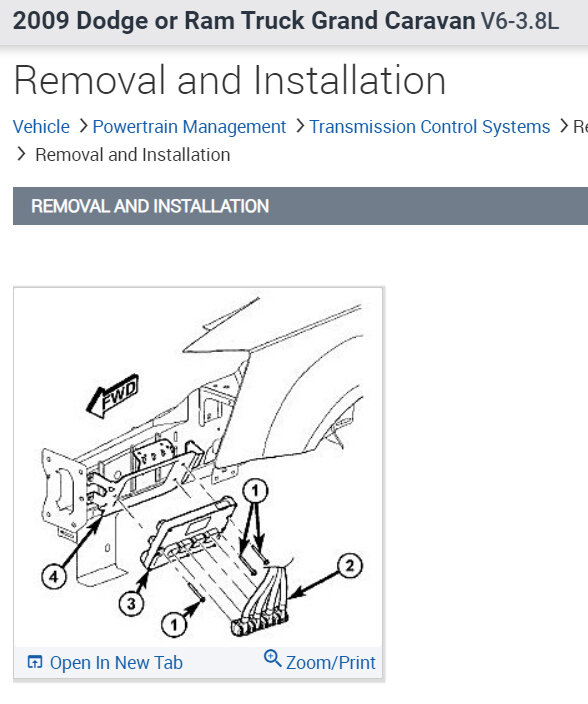

I have also seen the TCM's electrical connectors get wet and corroded so I would check that as well. I have included the location of the TCM. Check out the images (below). Please let us know what happens.
