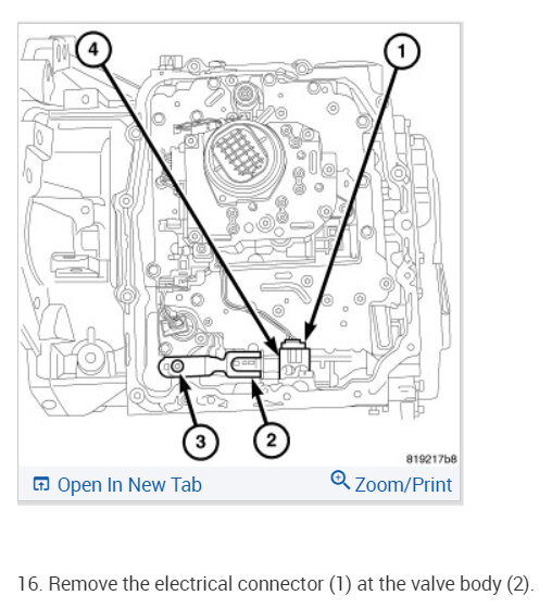

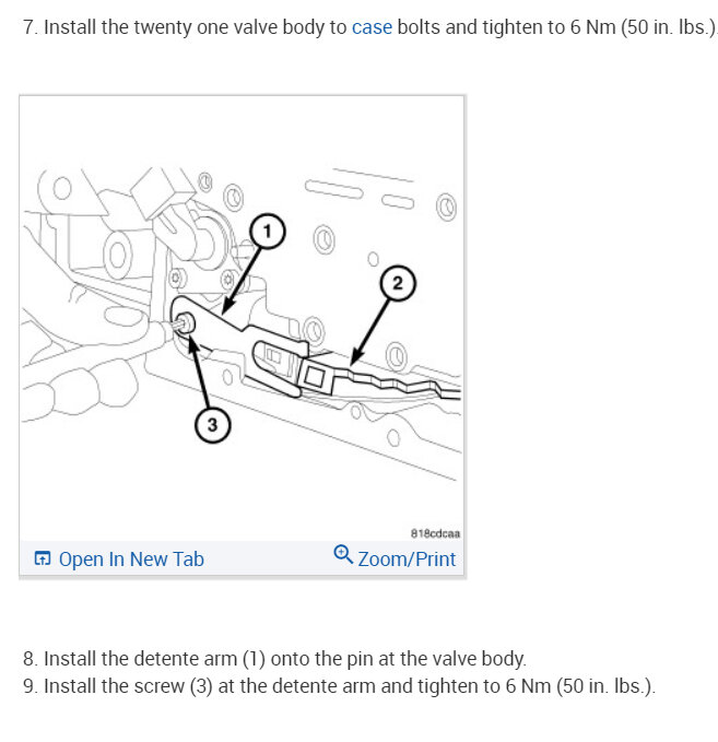

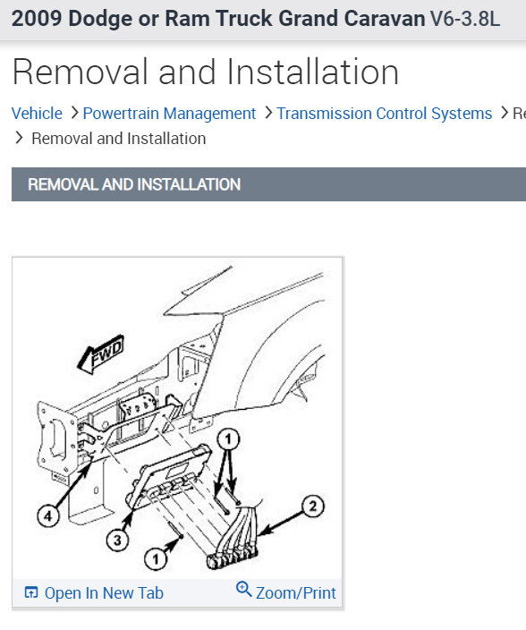

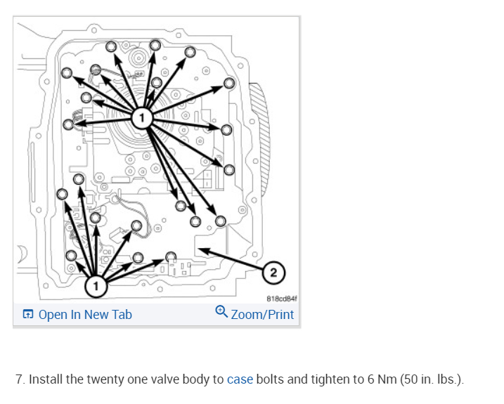

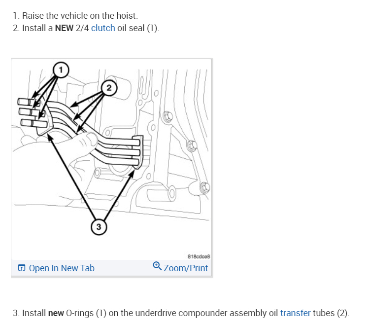

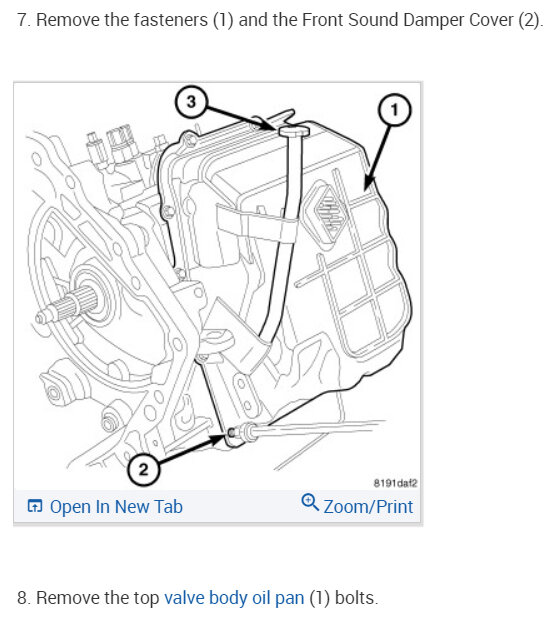

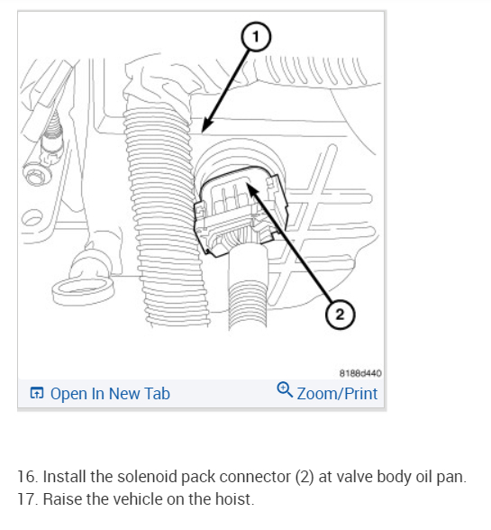

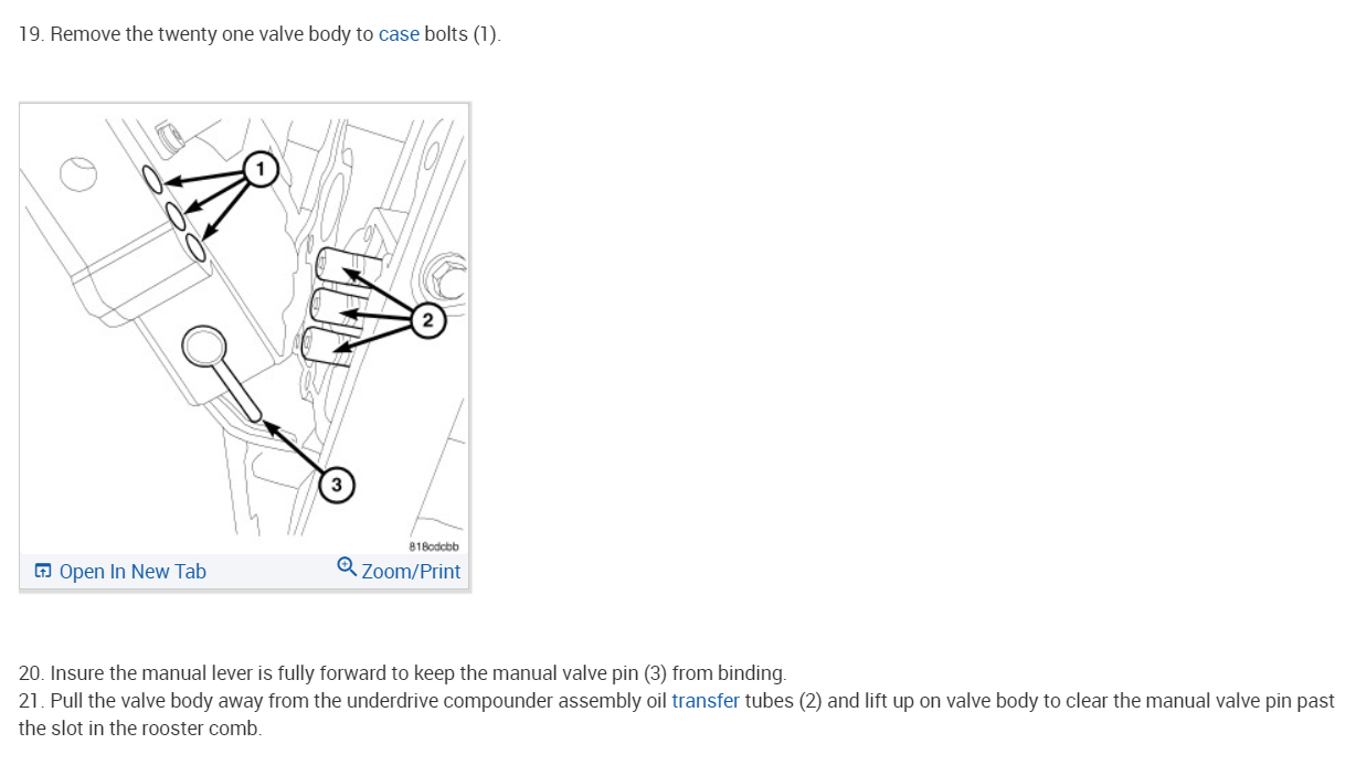

So, i had problem in my van listed above, I can’t get the transmission to reverse i pressed the side button in the shifter I'm pushing it up it basically doesn't move I'm stuck at the D shift and the manual transmission part only, so I need someone to help me with this.
Oct 15, 2023 at 9:19 PM
  • 55,433 POSTS

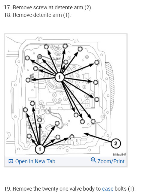

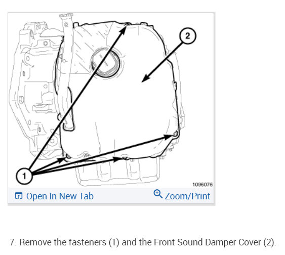

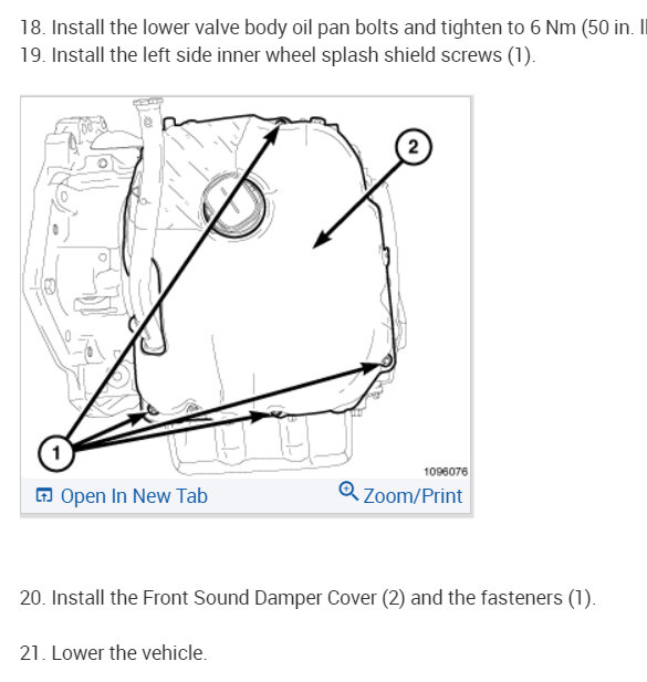

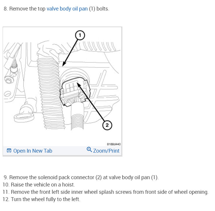

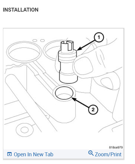

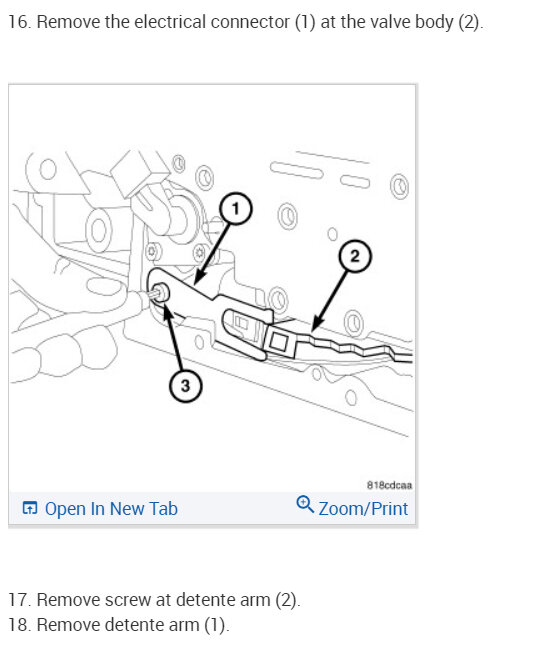

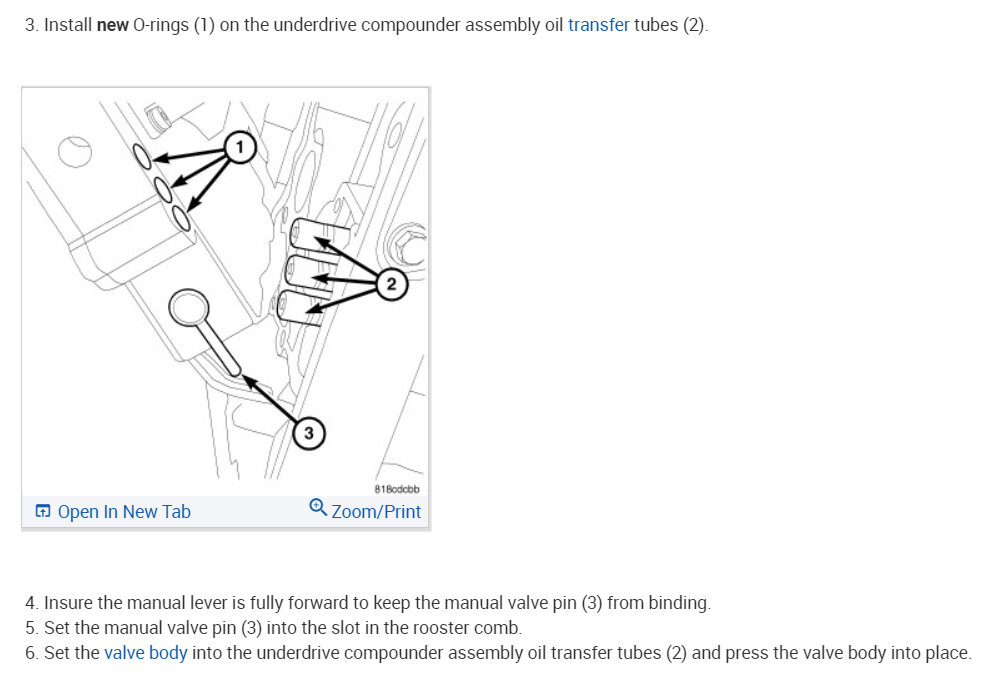

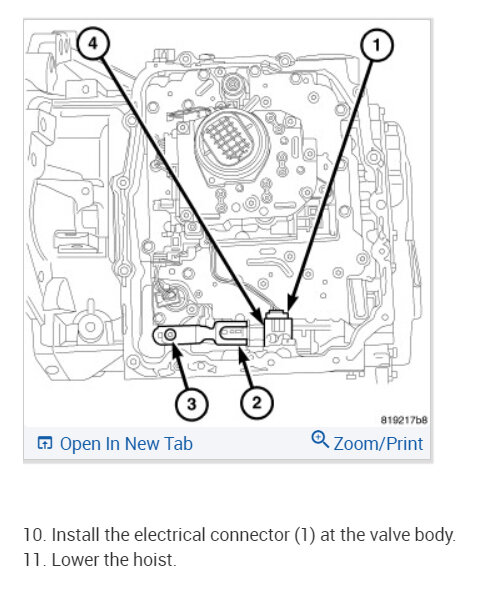

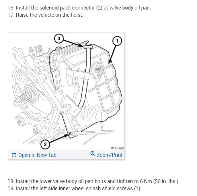

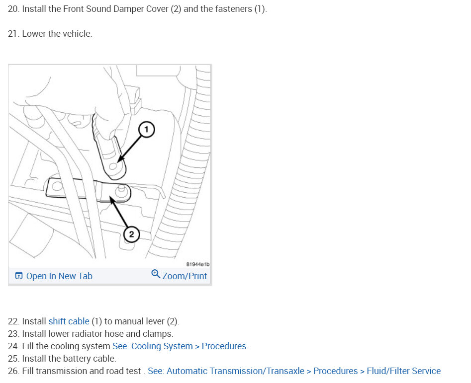

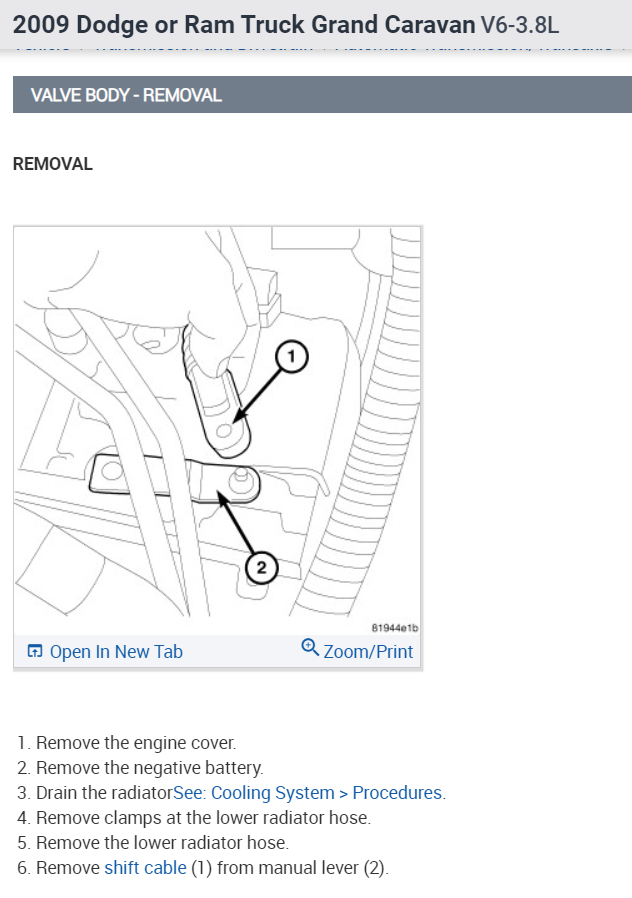

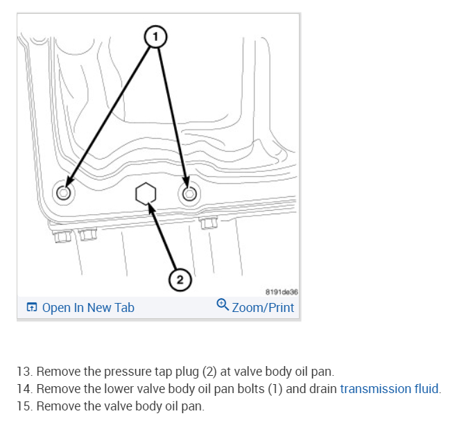

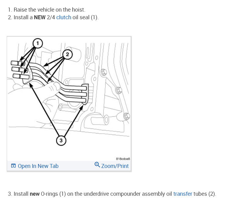

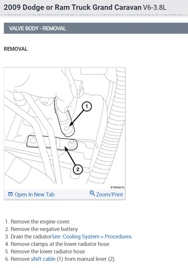

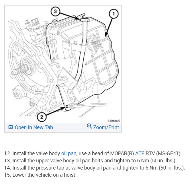

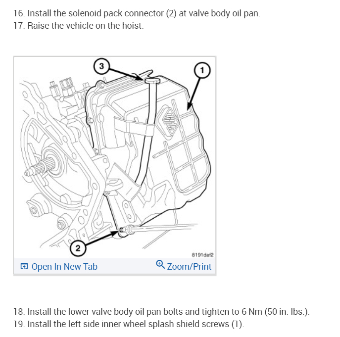

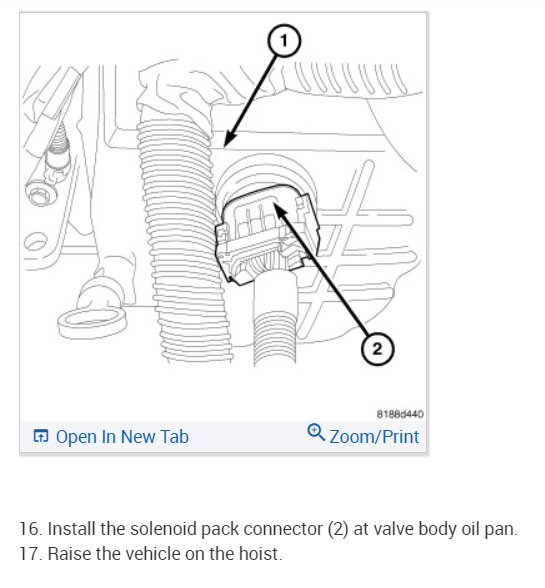

It sounds like the transmission solenoid TRS assembly has gone bad, but we should run the codes to see if any are stored, here is a guide and I have included how to change the transmission solenoid TRS assembly in the images below in case there is a code for it.
I have also seen the TCM's electrical connectors get wet and corroded so I would check that as well. I have included the location of the TCM. Check out the images (below). Please let us know what happens.
