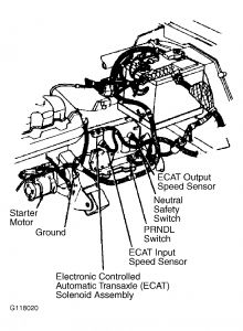

Ok, when was last tranny service?
Your New Yorker has 2 sensors one is an Input Speed Sensor and the other is an Output Speed Sensor. To replace these to sensor will cost less than $50. Could fix your problem. I have found these sensor are the cause in about 80% of the vehicles I have worked on.
There is also a Shift Solenoid Pack. Of course this will cost more.

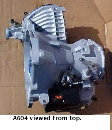

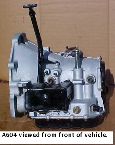

Ok, I am pretty sure the tranny is a Chrysler A604-FWD, 4 Speed, Automatic Transaxle which is Also known as the 40TE; 41TE; 41AE.
Picture 1 is the filter for it so if you take a look at the tranny pan and count the bolts (should be 14) and notice the design and if it matches up then it's a A604.
Pics 2 and 3 are of the A604 Transaxle.

It matched up, so I do have the a604 transmission. Thanks car2pros!

Got the tow bar, moved the car. Got the sensors in and output speed sensors, I will order the solenoid tomorrow.

Go ahead and change out the 2 sensors and wait on the installation of the Solenoid Pack. See if the sensor fix it first.

Installed the two sensors today and noiced that on the input sensor the connector was showing wire on both and was twisted like in a way the wires could touch and the base of the connector, so I think cutting and retaping will not work. Junk yard it is. Are these connectors sold DORMAN brand? I'd hate to make the trip to the junkyard and well get junk or being able to buy them for a cheap price new. Ordering the solenoid pack tomorrow. From new york so maybe a week before I see that if I am lucky. Fuel pump for the chyrsler is was paid for on the 07/23 and still hasn't been received by me coming from LA and I am like 200 miles away. So another bummer.
