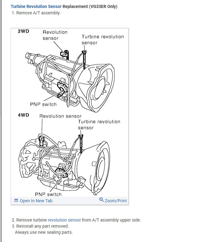

turbine shaft speed sensor location
2002 NISSAN FRONTIER
75,416 MILES • 2.7L • 4 CYL • 2WD • AUTOMATIC
BENYQUARSHIE
the gears shift from 1st through to 3rd, I don't know whether it changes and I don't notice but the engine sounds higher. Secondly I don't know whether its 4 speed or 5. Thanks
Mar 28, 2019 at 1:46 AM
This very wheel could be a speed sensor so I am attaching the info below on how to replace this.
Here is a guide that will help with testing a wheel speed sensor which is clearly a different sensor but the process to test it is the same:
https://www.2carpros.com/articles/abs-wheel-speed-sensor-test
Below is the process from the manual. Please run through this material and let us know what you find. Thanks
Jun 19, 2021 at 11:01 AM
