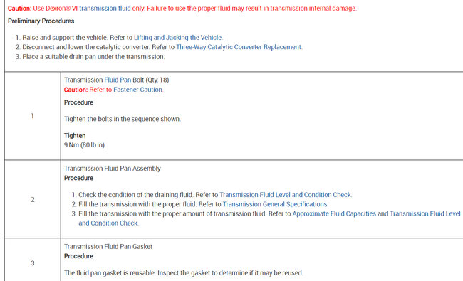

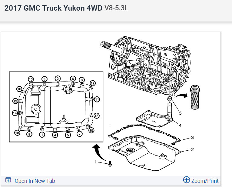

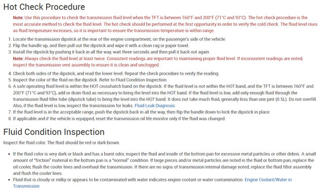

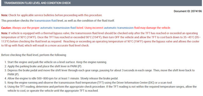

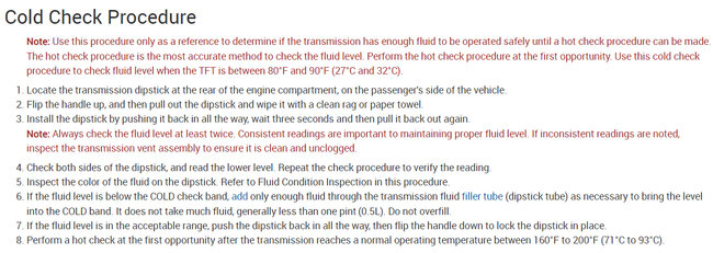

The number one reason for this to occur is low transmission fluid levels, also check the fluid condition as well. Here is a generic guide to help you step by step with instructions in the diagrams below to show you how on your car:
https://www.2carpros.com/articles/how-to-check-and-add-transmission-fluid
Check out the images (below). Please upload pictures or videos in your response to any problems so we can see what to help you with.
