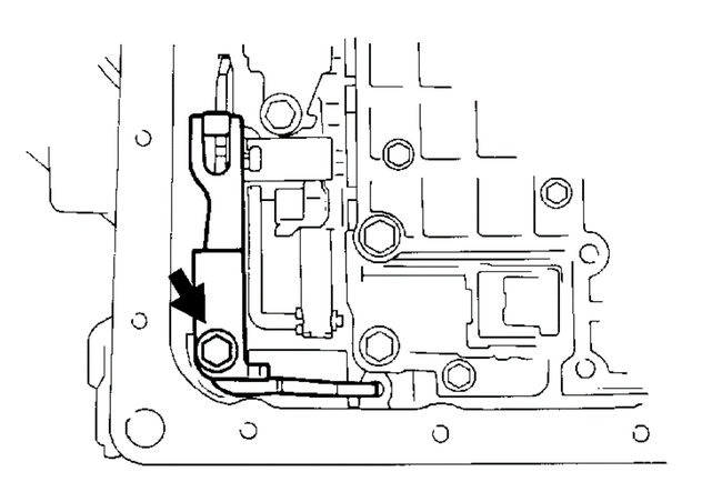

I am replacing the shift and TCC solenoids, when I removed the internal I had the arm? And a three springs with plugs come out . The arm is stainless and notched. I'm looking for a diagram of the pieces inside so I can make sure there installed right . I got the solenoids put back and car won't go into gear. I also have a piece that fell out.

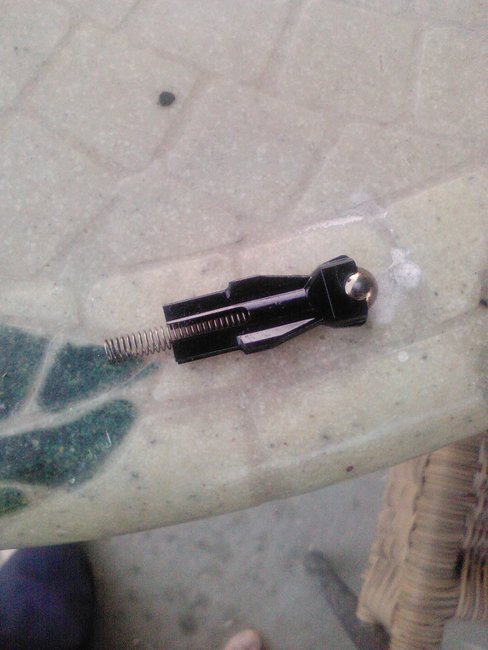

This is the part that fell out with the arm:

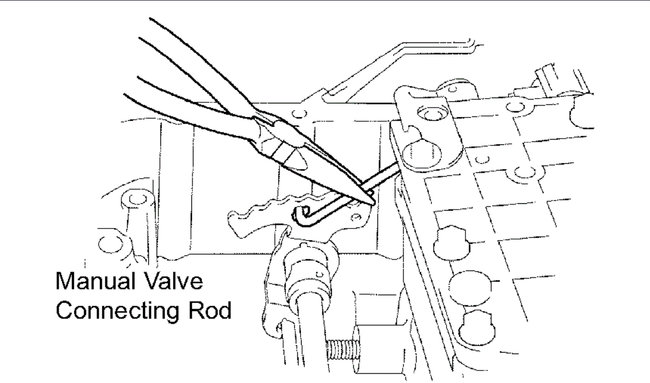

You indicated "...removing the internal I had the arm." Can you explain? As far as the part, it looks like part of the detent spring/ball. That ball rides on a lever that is grooved. See picture 1 and let me know if that is where it came from. Also, picture 2 shows a different view.
Let me know. Also, where did the three springs come from? Do you have pictures of them?

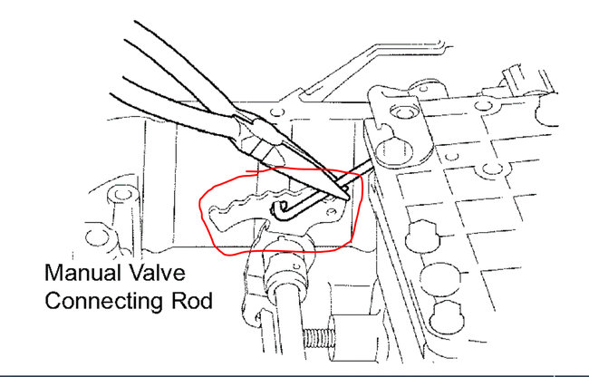

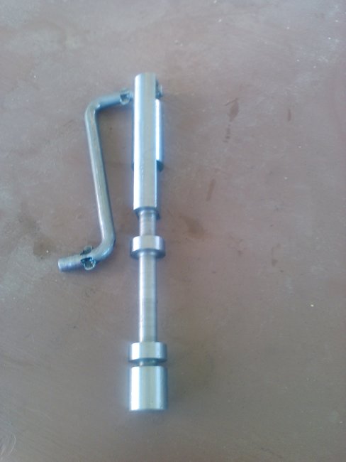

The arm that came out.
May 26, 2021 at 11:11 AM
  • 110,248 POSTS
That looks like the manual valve / lever. See the attached pic and let me know if it helps.
