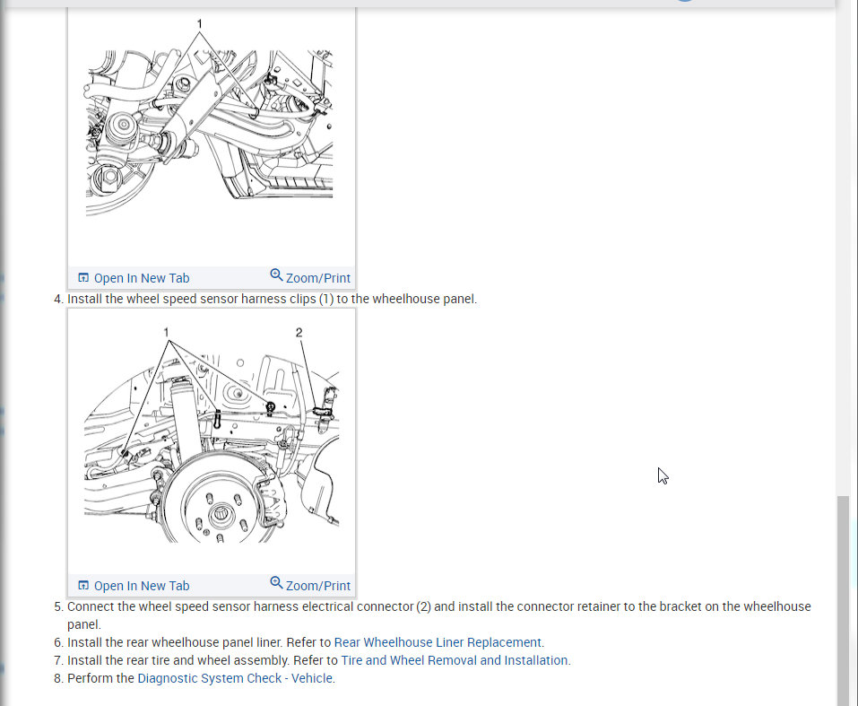

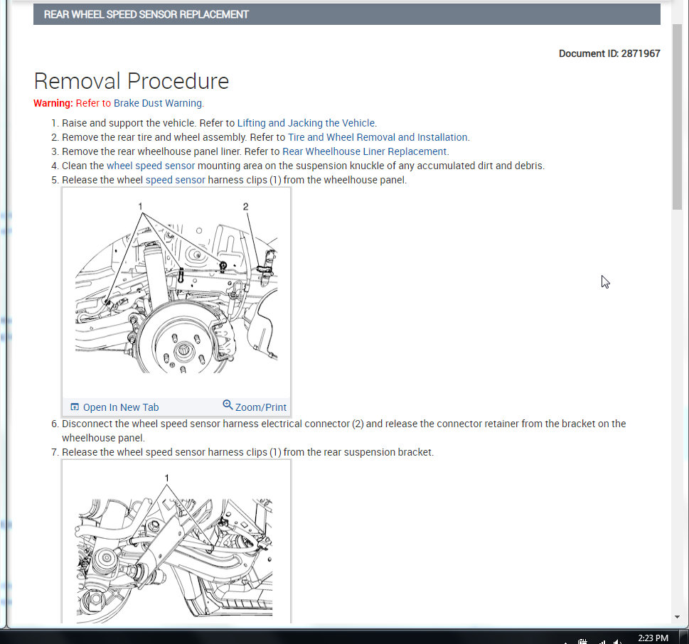

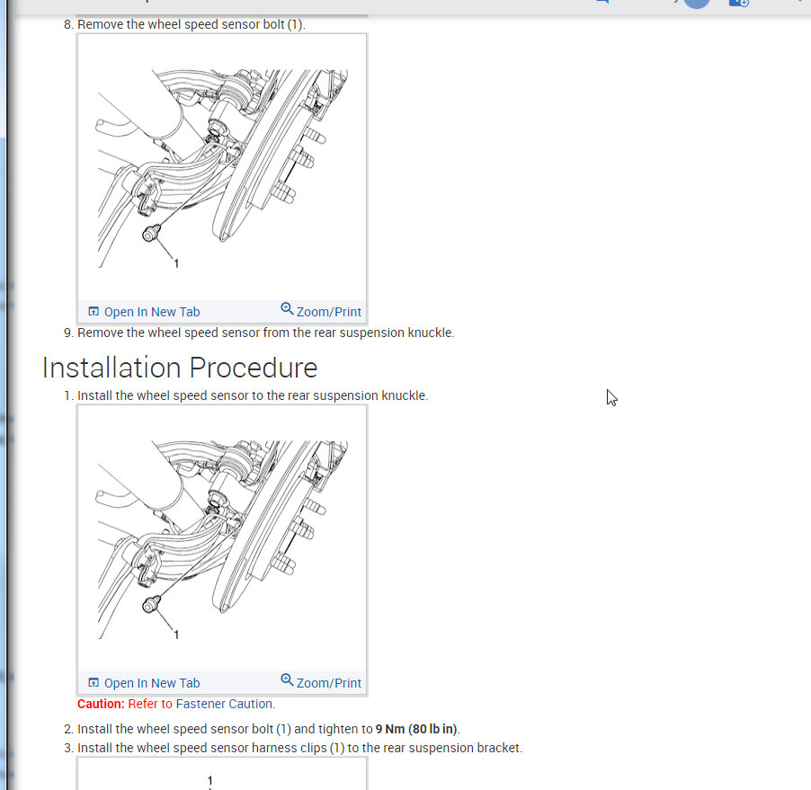

Below is the process for the rear sensors but let's see if we can get more info on this first. Thanks
