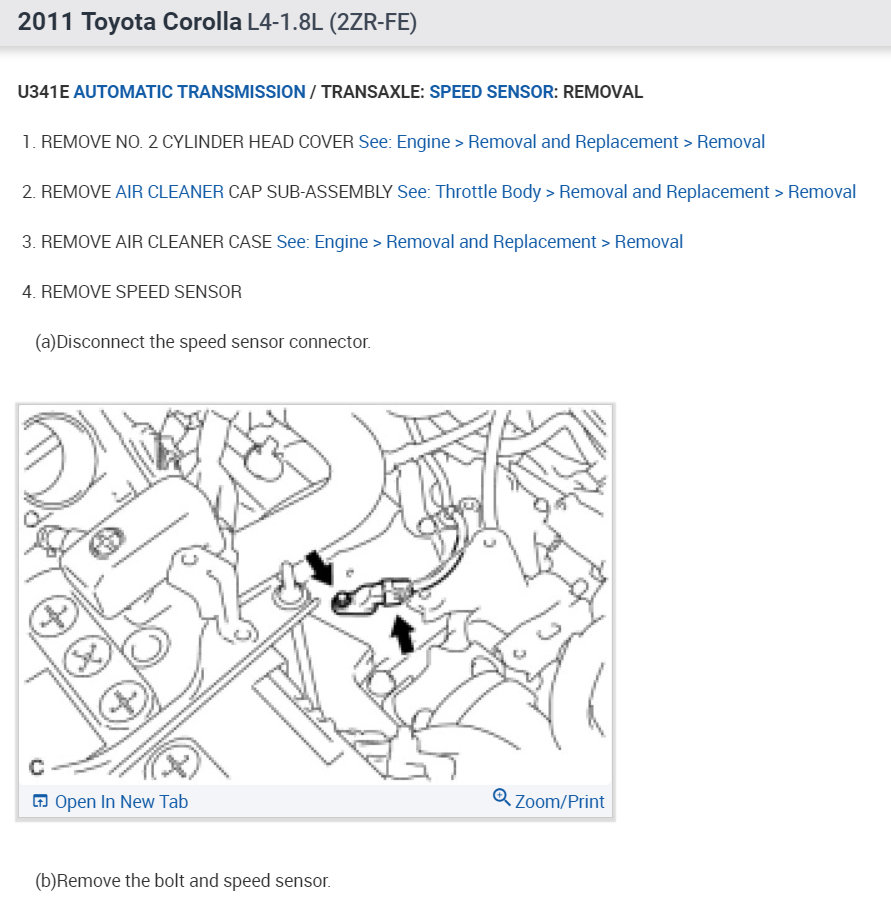

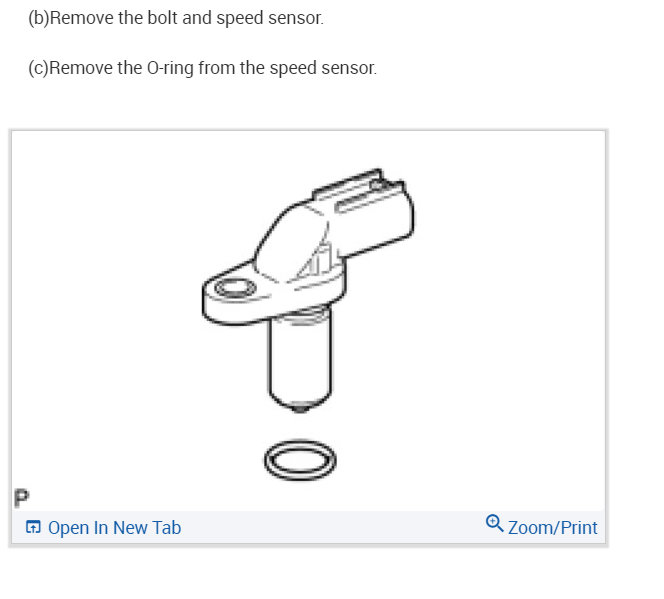

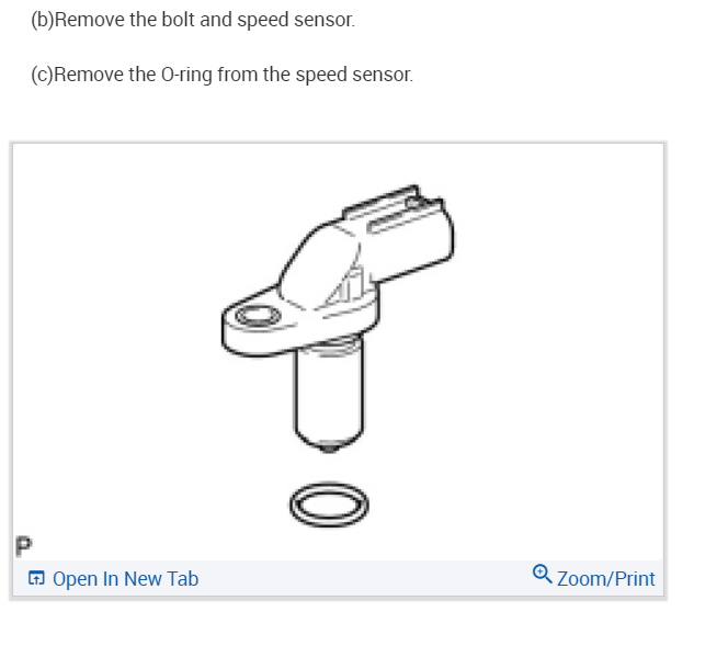

Thanks for the video. I don't think the muffler is the problem. i'm going with the turbine (input) shaft speed sensor. here is the location so you can replace it. Check out the diagrams (below). Please let us know what happens.

Okay, thank you for your input. I really appreciate it I got a new sensor works perfect.
