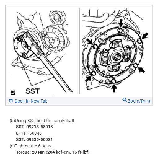

Changing engine so installing old damper assembly on new engine, what torque on these bolts? Please
Aug 8, 2022 at 12:35 AM
  • 110,248 POSTS
As far as the torque is involved, I attached the directions below. The directions include the torque specs.
Take a look at them and let me know if that is what you need.
See pic below.

This clutch looking damper is weird, how do i know which side the plate goes as it can go both ways. If this was a normal clutch i would have figured it out.

Also, what is the part number for alignment tool?
Aug 19, 2022 at 1:10 AM
  • 110,248 POSTS
The part number for the alignment tool is 09301-00210. I'm not sure I understand your other question. Are you using the original flywheel?
Aug 19, 2022 at 3:24 PM
BHAMDOC1973
  • 2,007 POSTS
Same flywheel, same clutch.
Aug 19, 2022 at 9:16 PM
  • 110,248 POSTS
If I recall, it's the same on both sides. However, you want it the same as it was removed. Are there any bolt marks or indicators on it that would help make that determination?
