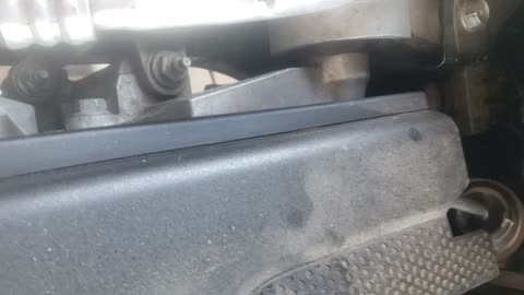

I changed my transmission mount and afterwards I started it to see how it did and coolant was streaming out from underneath it. So, I got under it and can't see where its coming from exactly but it's somewhere by the transmission as for the shifting its doing this just fine in all gears however it's not accelerating passed maybe 10 MPH and revving from 1 to 2 the reason the 2 are combined is because they both became issues while trying to fix the loss of acceleration and RPM issues.

Okay. So, I did the pressure test and bits defiantly coming from the transmission area like maybe the cooler lines if they run through the inside of or on top of the transmission pan. So now I need to know how to repair this without damaging anything else cause my other issues may be fixed because I did a code scan on it and was getting throttle body related codes and when I was taking it apart to get to the throttle body I found I had forgotten to plug its harness back up from when I had changed its gasket recently then I backed out then in my driveway it accelerated it is making a weird sound that I will send a video clip of shortly. I've read though that when your alternator is failing sometimes it will make sounds and cause leaks that mimic a failing power steering pump drivebelt and even transmission. Do you think this can be true cause? It would really explain why I went through 3 new power steering pumps a new high-pressure line replaced the rack and drivebelt and I still here the whine. And have the leaks and nothing i've done to stop has worked. But please inform me of how to replace these transmission cooler lines please and thank you.

We are going to need pictures of what is leaking. Meaning you need to pressure test it and locate the exact leak point and then let us know what that part is. The only reason is, if you have a coolant leak then this would not be transmission cooler lines. The transmission cooler lines will have transmission fluid in them not coolant.
So, we need to find the component that is leaking which means you may need to remove things in order to gain better access.
Unfortunately, we can really only assist by telling you the process to find the leak, but you will have to be the one that finds it and then we can provide the process on how to replace that part. However, transmission cooler lines are not going to be the source of a coolant leak.

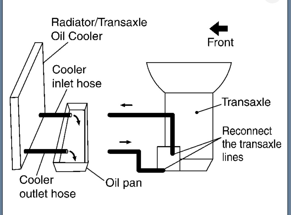

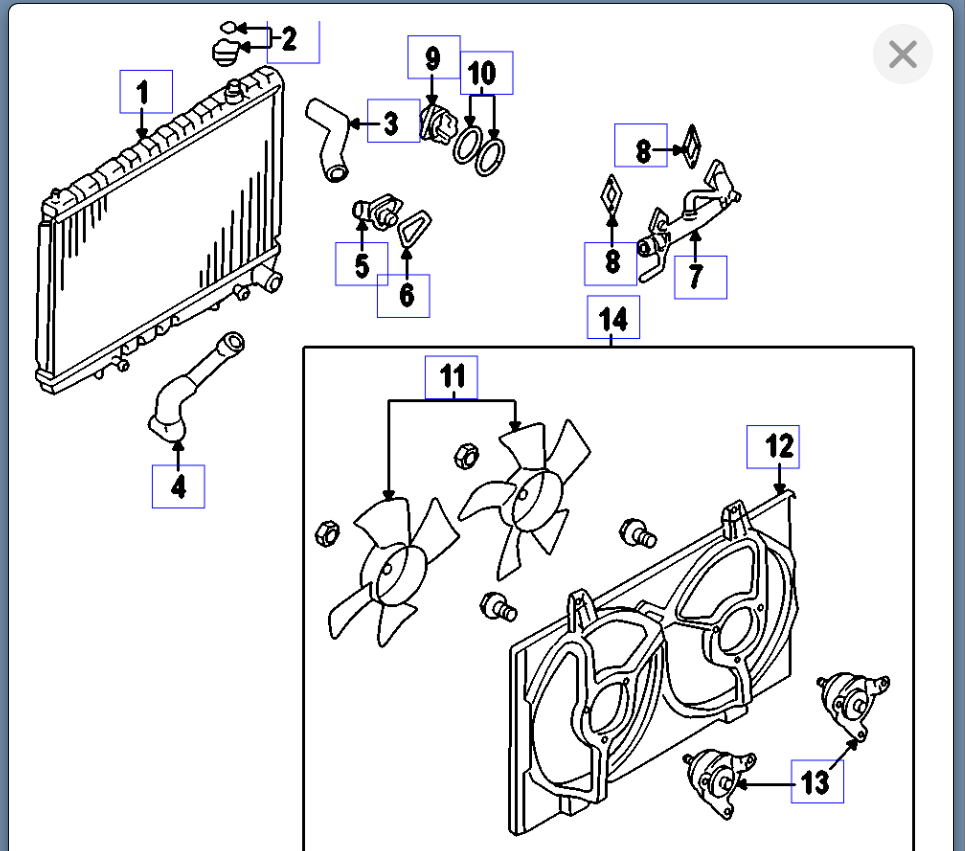

Okay. Is it leaking transmission fluid or is it leaking coolant? You said earlier that it was leaking coolant which is why I am confused why you are wanting info on the transmission oil cooler and saying that you pinched an oil cooler line. The oil cooler is part of the radiator in the front of the engine bay. I attached a diagram showing this.
So, if you pinched a transmission oil cooler line it would be leaking transmission oil.
So, if we have a coolant leak that is why we needed to pressure test it to locate where the leak is coming from.
Unfortunately, I just don't know where this coolant leak is coming from based on this info.

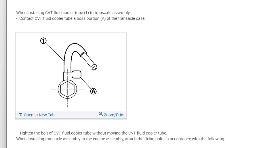

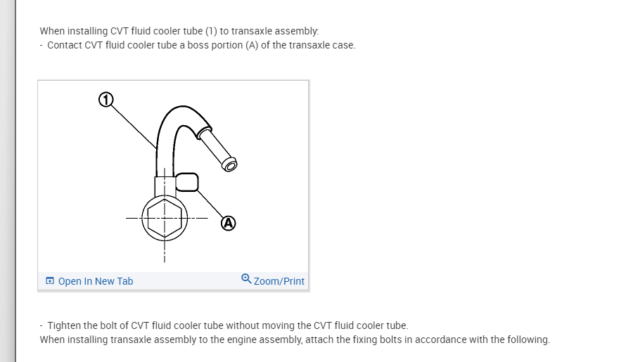

Also, the manual does not have repair procedures on just the cooler lines, or I would provide those as you are asking. Basically, the only thing is what I attached below which is not extremely helpful.

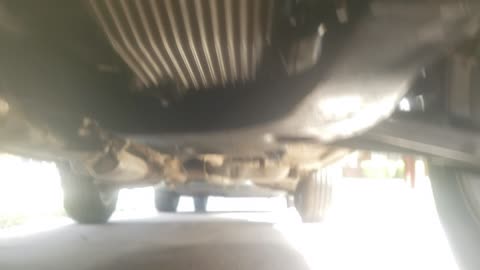

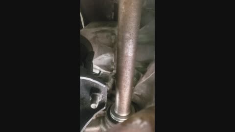

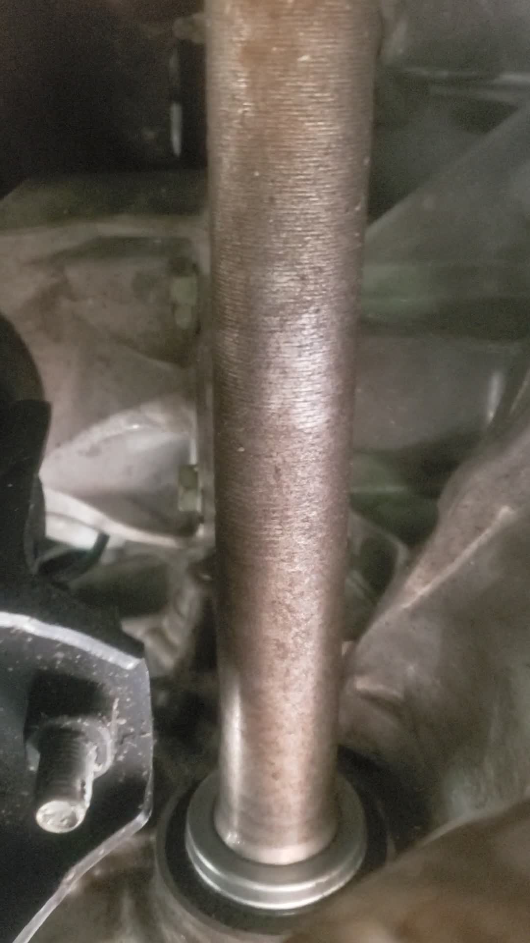

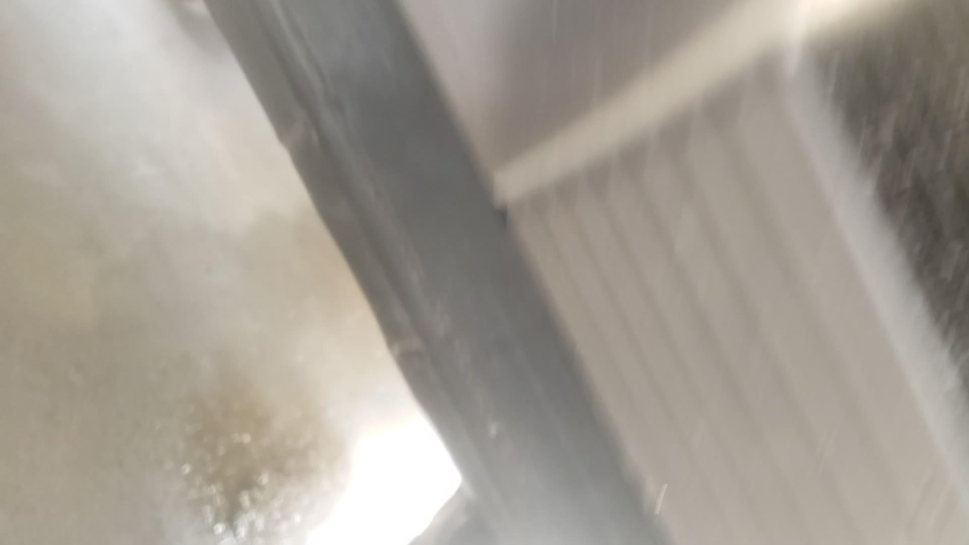

I understand you can't tell me where its leaking from and I got under it and with my hand followed it up as far as my hand could reach which isn't far as I have t-rex arms, lol but as I went upwards I noticed that where the CV axle goes into the tranny from the passenger side just at the entry had what looks to be fluid coming out of the entry is there a seal that may of came off there just curious anyways so I went a bit further up from that point on the back end of the transmission kind of and I don't see any coolant lines in the area. I will get under it and make a video and try to get a better view of it I did however read online about there being a coolant hose that supposedly runs under the manifold to the back of the air intake that can leak and make it seem as though its coming from the transmission area but isn't. It just puzzles me as to what I could of pinched that hi when I jacked it up to do the mount because it wasn't leaking any coolant at all before I changed it. So, I guess until I send the video if you have any thoughts or suggestions so far I'm open to them otherwise I will wait and see after the video, but I did do the pressure test and I couldn't see the leak location ether ttys.
Saturday, April 23rd, 2022 AT 8:07 AM

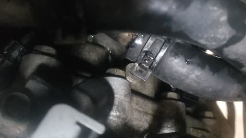

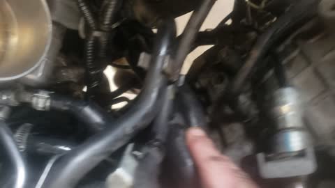

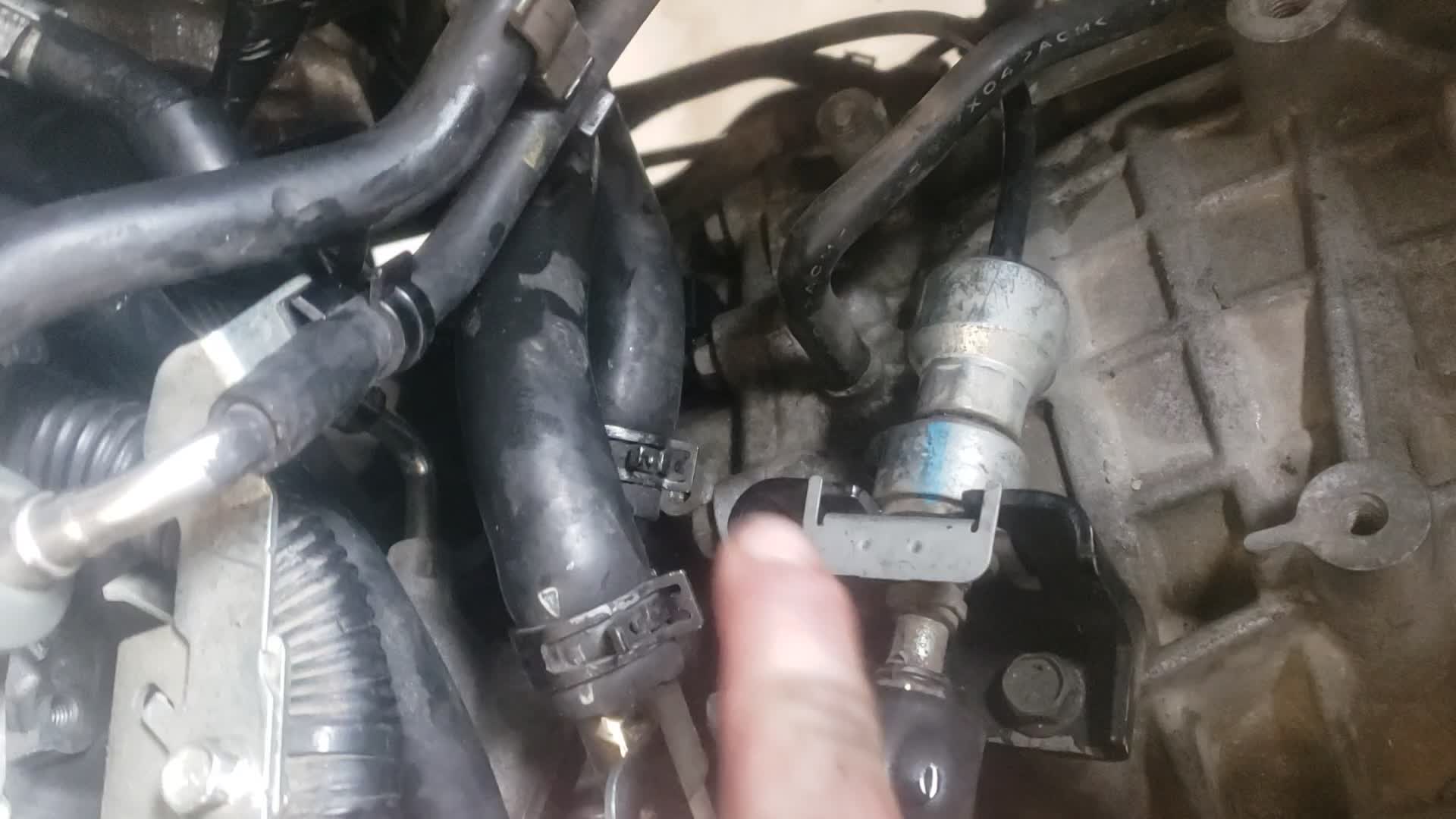

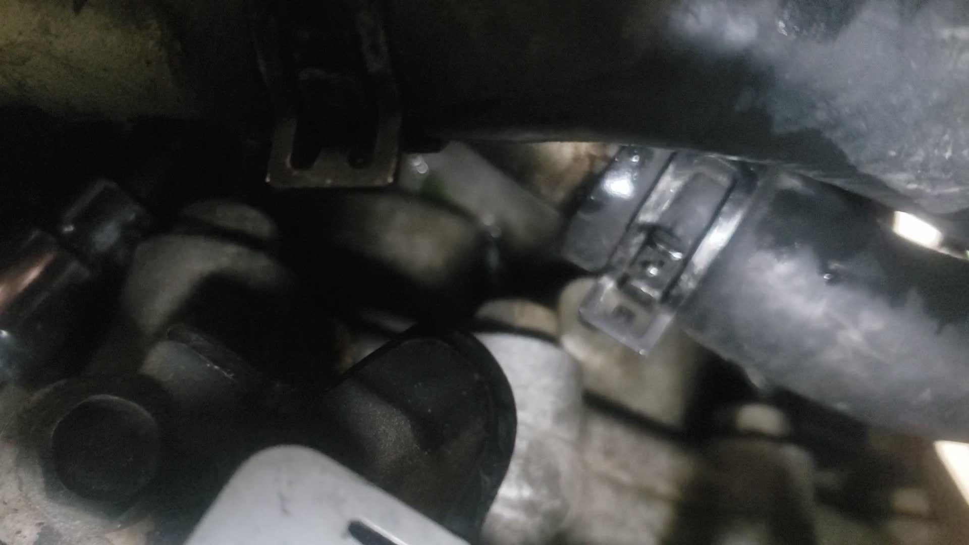

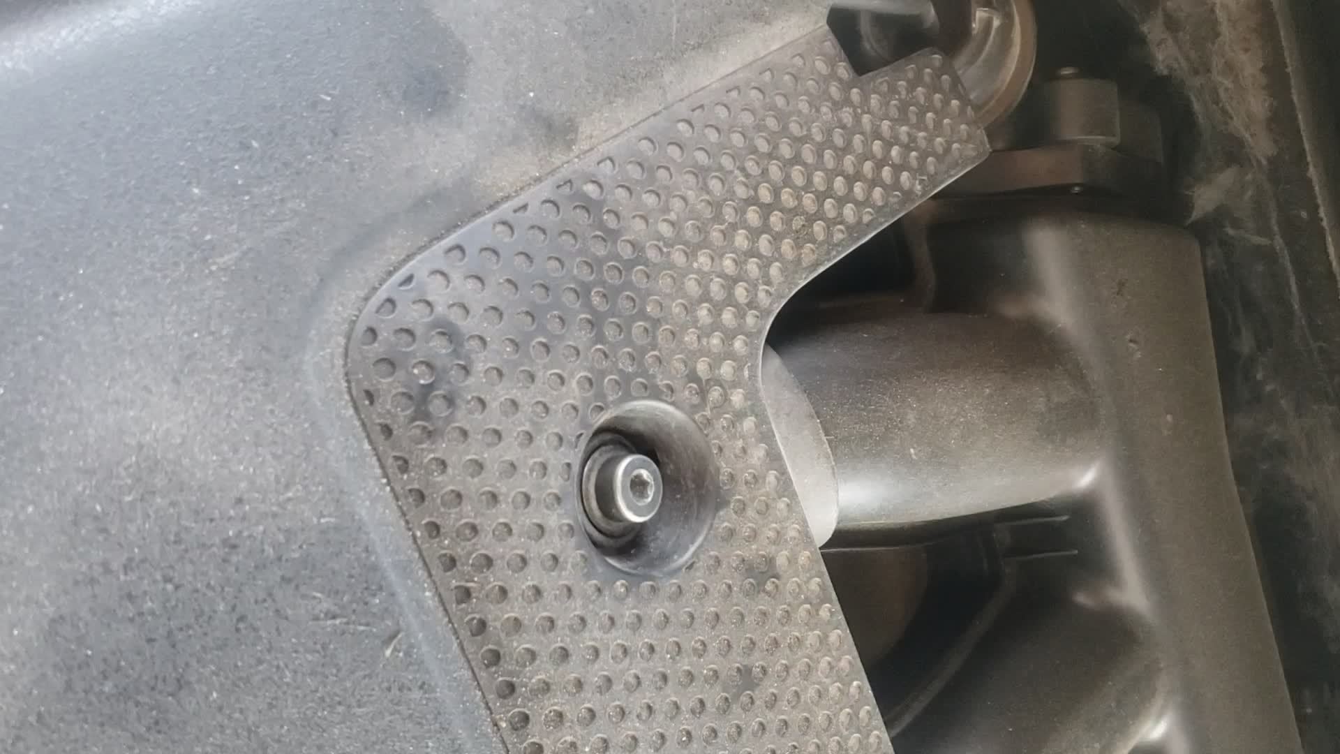

Okay. So, I'm put here on the truck and I took off the air intake and air filter box and found a puddle of antifreeze under it and on top of the transmission kind of that has hoses that connect to the throttle body in the video I included. I will try to talk loud and explain in the second video does this hose looks to be bulging to you or that they may be bad. However, I think that I may of hd the hoses that connect to the throttle body hooked up wrong do I switched them and will put it back together and lyk what I discovered but let me know on the hoses and video 2 on need to replace or not please.
Saturday, April 23rd, 2022 AT 10:21 AM
I don't see any abnormal bulging but the way to tell if a cooling line is failed is to squeeze it. If it is hard and does not feel like pliable rubber hoses, then it is dry rooted and will eventually fail.
As for the leak, you do have cooling lines running to the throttle body so if that is as high up as you are finding coolant leaking then this would be the place to inspect. I would put it back together and run the engine with the air intake off and just inspect all these lines when it is dripping.
Saturday, April 23rd, 2022 AT 6:51 PM
