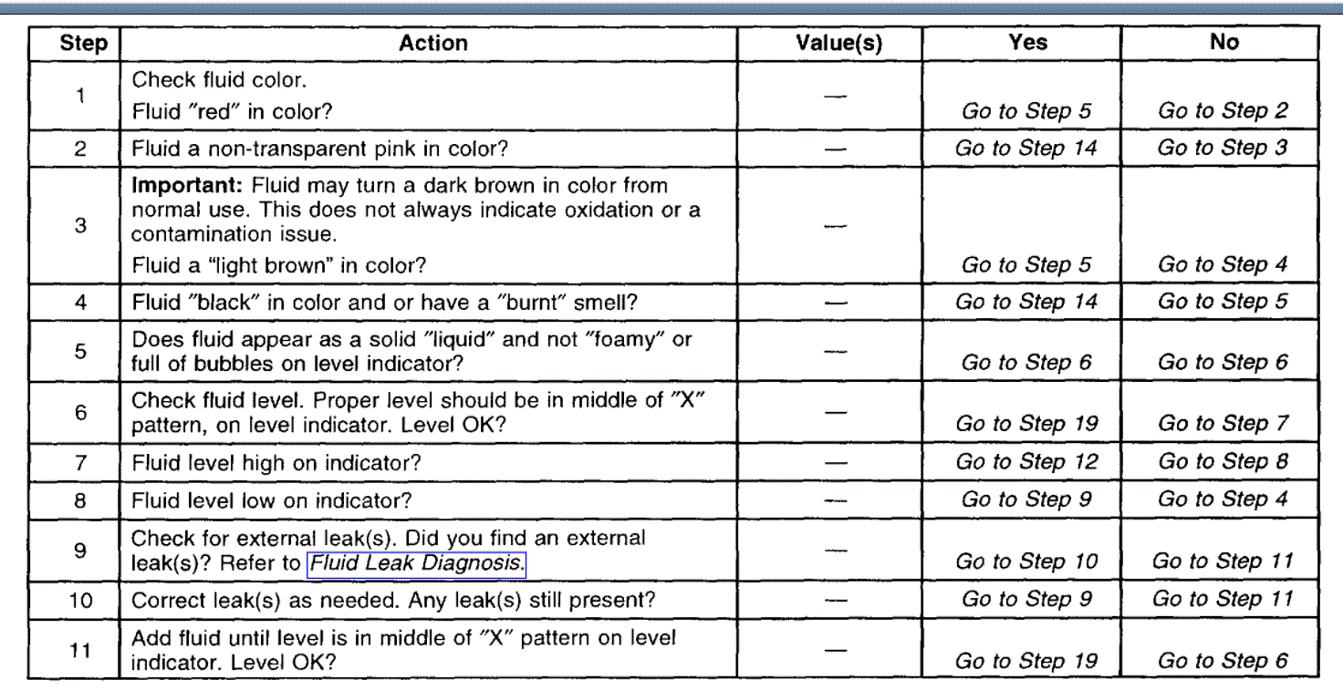

My transmission cooler cracked and has been leaking a couple weeks now. I have found temporary fix solutions by using aluminum epoxy and JB weld but they never fully stopped the leak. I tried a different process that has stopped leaks of all other sources and degrees of severity completely not even a drip, but didn't work work on the trans cooler. I tried it yesterday and today found out how badly it failed. Not sure as to how much fluid I really lost but I believe I lost virtually all the transmission fluid because there was a literal line running down the road from where I was driving along before pulling over. I only pulled over because the truck began shake a little. I tried my old patch that slowed the leak to a drip and put in about 2 quarts of fluid all I had available. Let the truck set an hour for the patch up job to set and tried driving home again. The leak wasn't bad anymore still leaking but more of a slow drip and nothing bad at all, but I had to drive slowly due to vibration and low fluids. The faster I moved along the louder/faster the vibration so I drove the last 1/2 mile home at about 5 mph or so. What could I have possibly done to my truck/transmission? I really hope I didn't destroy my trans when I found out I had an issue I went as easy on the truck as I could in order to get it to a safe place.
Oct 21, 2020 at 11:55 AM
  • 110,241 POSTS
If you lost a lot, two quarts may not have been enough. If it is low enough, it can cause lower pressure in the transmission and allow the clutch packs to chatter. That will cause them to eventually fail.

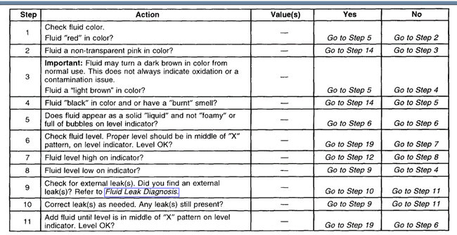

Did you check the level after you added the two quarts? If you haven't, start with that. When checking, the engine should be at operating temp, the engine running in park, and on a level surface. Take a look at pic 1 below. It explains things to look for.

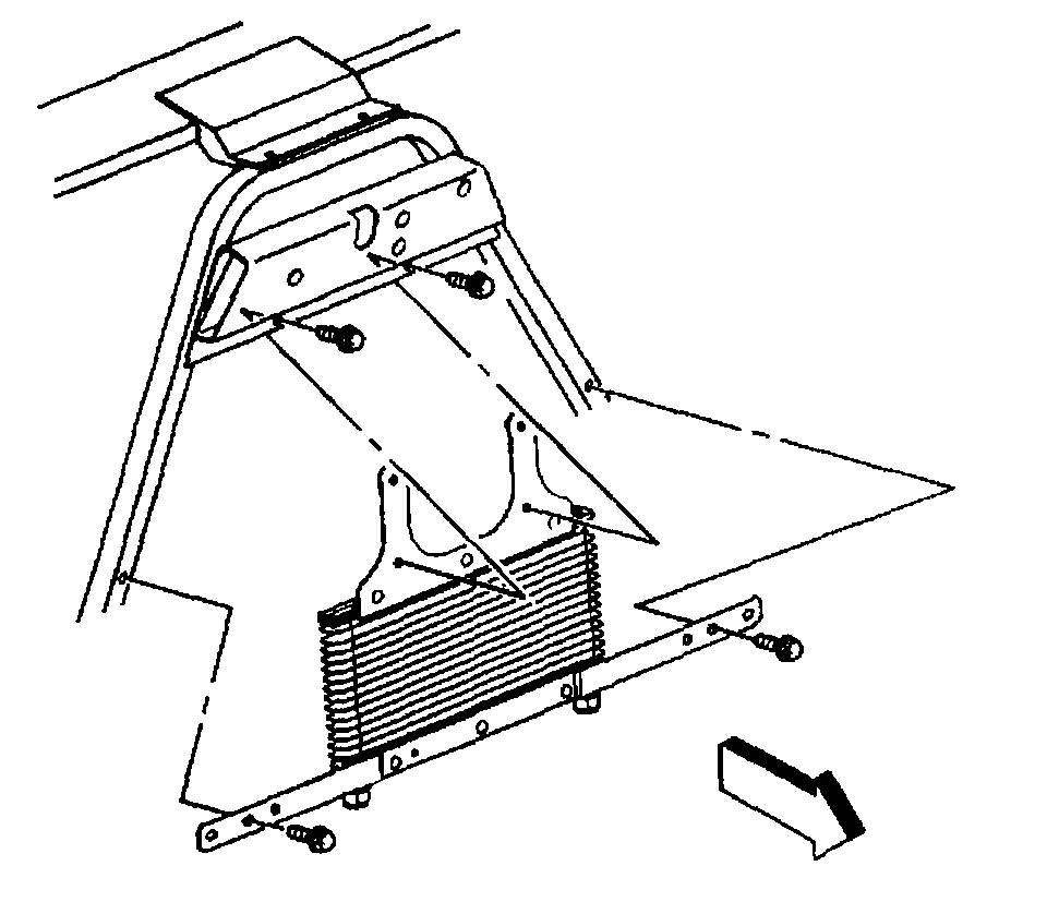

The cooler needs replaced. There is quite a bit of pressure that is in the system. Most sealers won't work and if they do, it's not for long.
There are two different transmissions that could have been used. I will provide the directions for the removal and replacement of the cooler for both.
__________________________
2000 Chevy Truck K 1500 Truck 4WD V8-5.3L VIN T
Transmission Oil Cooler Replacement
Vehicle Transmission and Drivetrain Automatic Transmission/Transaxle Transmission Cooler Service and Repair Procedures 4L80-E Automatic Transmission Transmission Oil Cooler Replacement
TRANSMISSION OIL COOLER REPLACEMENT
Removal Procedure

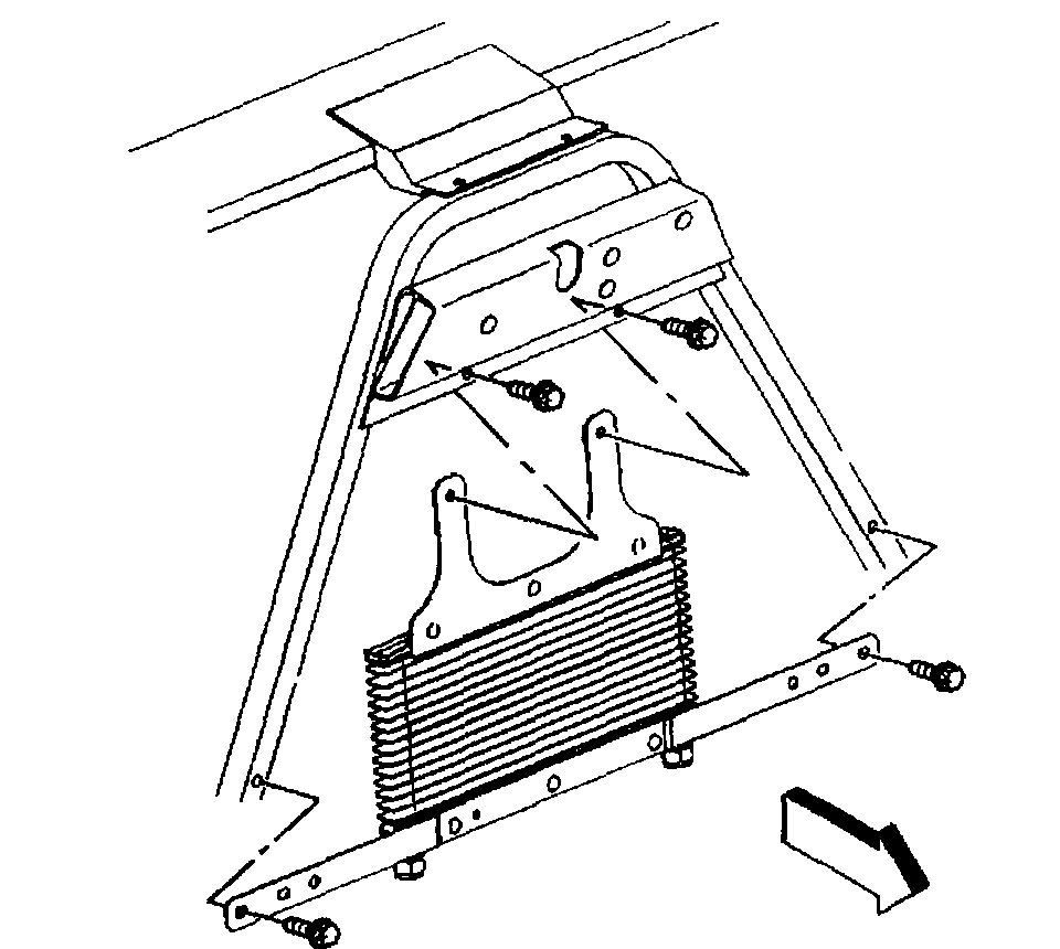

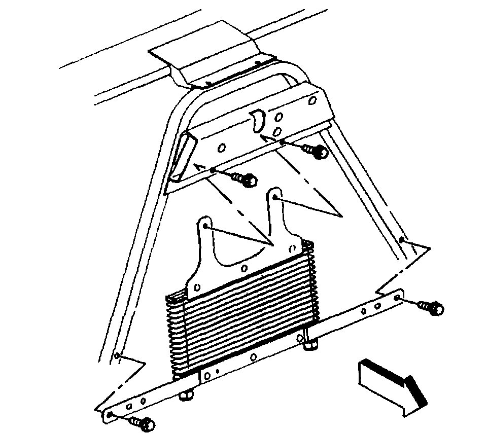

pic 2
1. Remove the two bolts securing the auxiliary oil cooler bracket to the radiator support.
2. Remove the auxiliary oil cooler from the radiator support.

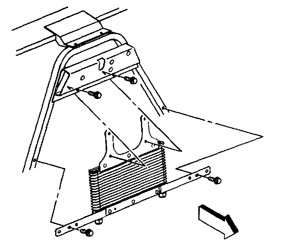

pic 3
1. Install the two bolts securing the oil cooler to the radiator support.
Tighten the bolts to 12 Nm (9 ft. lbs.).
2. Ensure the guide pin bolt is positioned into the support hole.

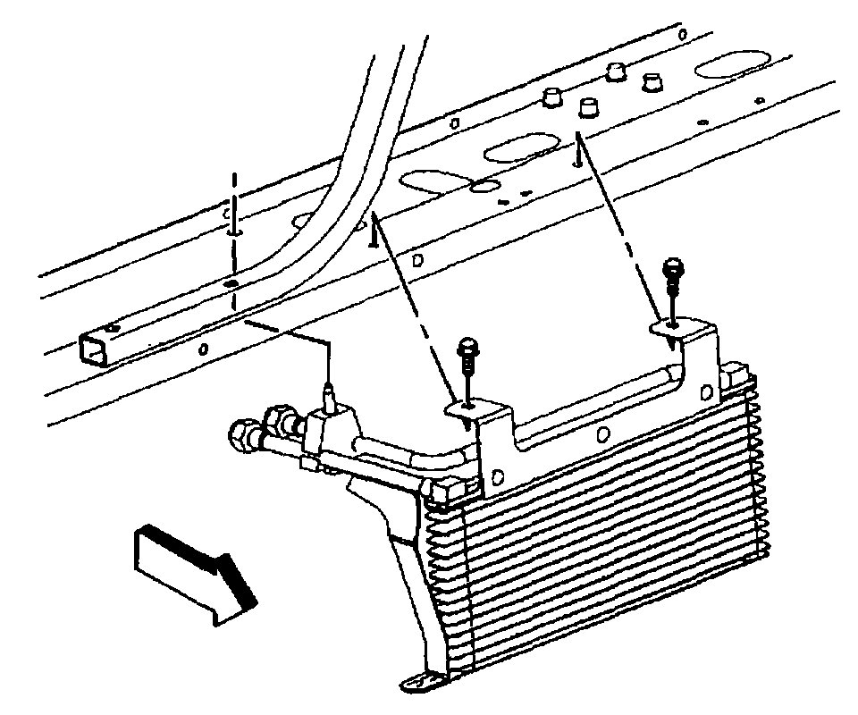

pic 4
1. Refer to grille assembly. Refer to Grille Replacement (Chevy) or Grille Replacement (GMC) in Body and Frame.
2. Remove the two nuts securing the two cooler lines to the oil cooler.
3. For vehicles not equipped with the 4.3L- engine, remove the four bolts securing the auxiliary oil cooler to the radiator support.
pic 5
4. For vehicles equipped with the 4.3LL engine, remove the four bolts securing the auxiliary oil cooler to the radiator support.

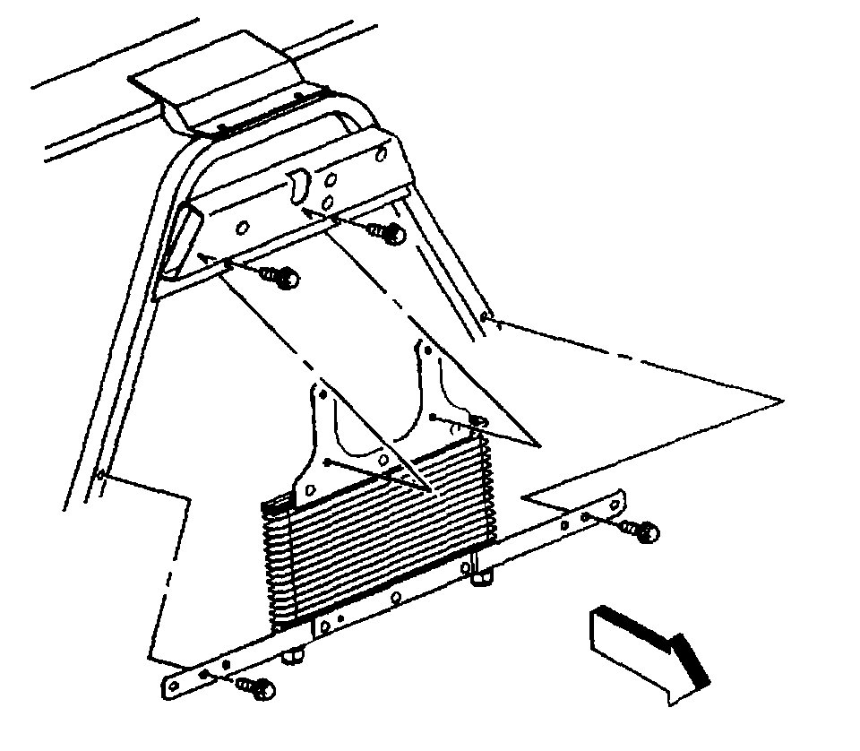

pic 6
1. For vehicles not equipped with the 4.3L engine, install the four bolts securing the oil cooler to the radiator support.
Tighten the bolts to 10 Nm (89 inch lbs.).
