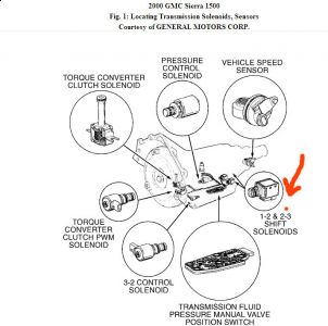

The code 730, seems to skip 2nd straight to 3rd when shifting
Wednesday, September 16th, 2009 AT 3:19 PM
SERVICE WRITER
  • 9,123 POSTS
730 doesn't sound right, not to mention I have no reference in my software for a 730. Should recheck.
I still think is is a shift solenoid acting up.
https://www.2carpros.com/forum/automotive_pictures/30961_sie_1.jpg
