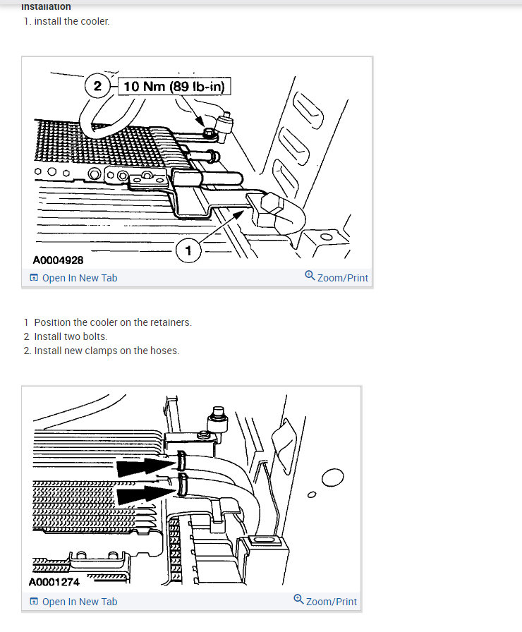

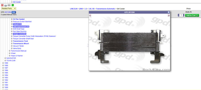

My transmission cooler is located in front of the fan. I am trying to order a new one but there are alot of different sizes. What size came standard on that car?
Apr 25, 2021 at 4:05 PM
Good morning,

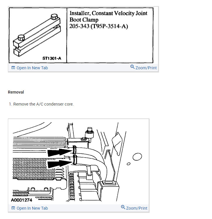

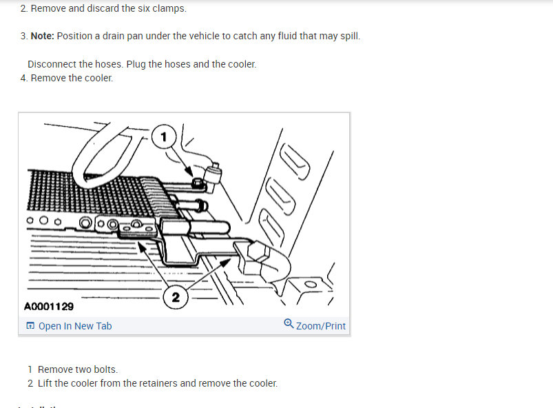

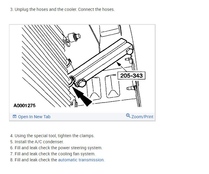

I attached the one for you below for your car from Rock Auto. I attached the procedure below for you for the repair. Check out the diagrams (Below). Please let us know if you need anything else to get the problem fixed.
