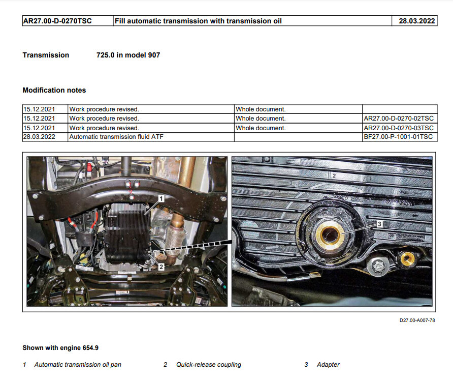

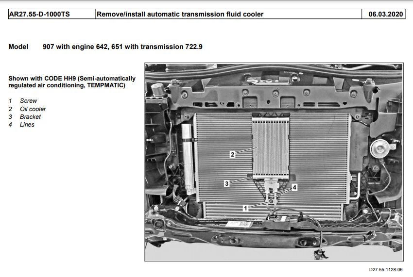

Hello!

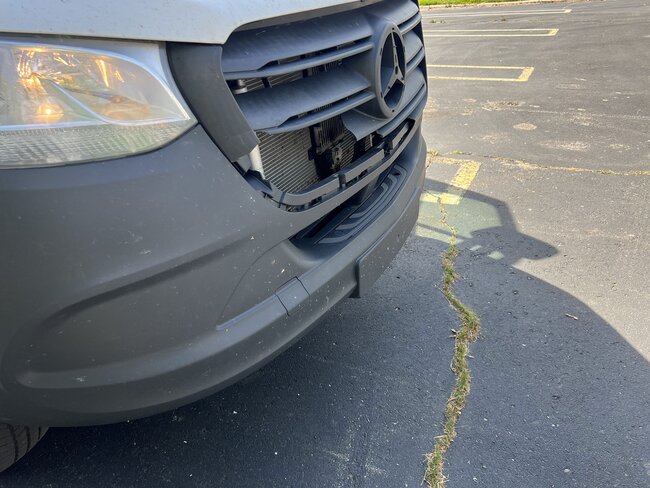

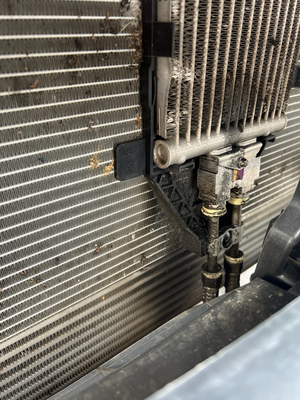

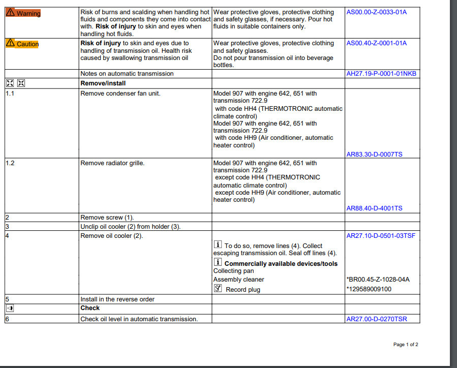

I'm seeking advice about replacing the transmission cooler (radiator) situated in front of the A/C radiator.
There is a small leak caused by a collision with a deer.
I would like to know what types of couplings are there, how to disconnect them, the implication of disconnecting them, how to refill, compensate, the possible lost fluid back in the transmission.
I would also need to check the transmission fluid level. I don't think that the car is equipped with a stick for checking the fluid level.

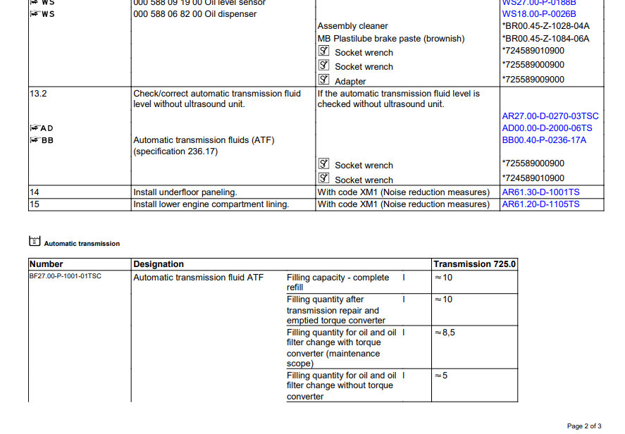

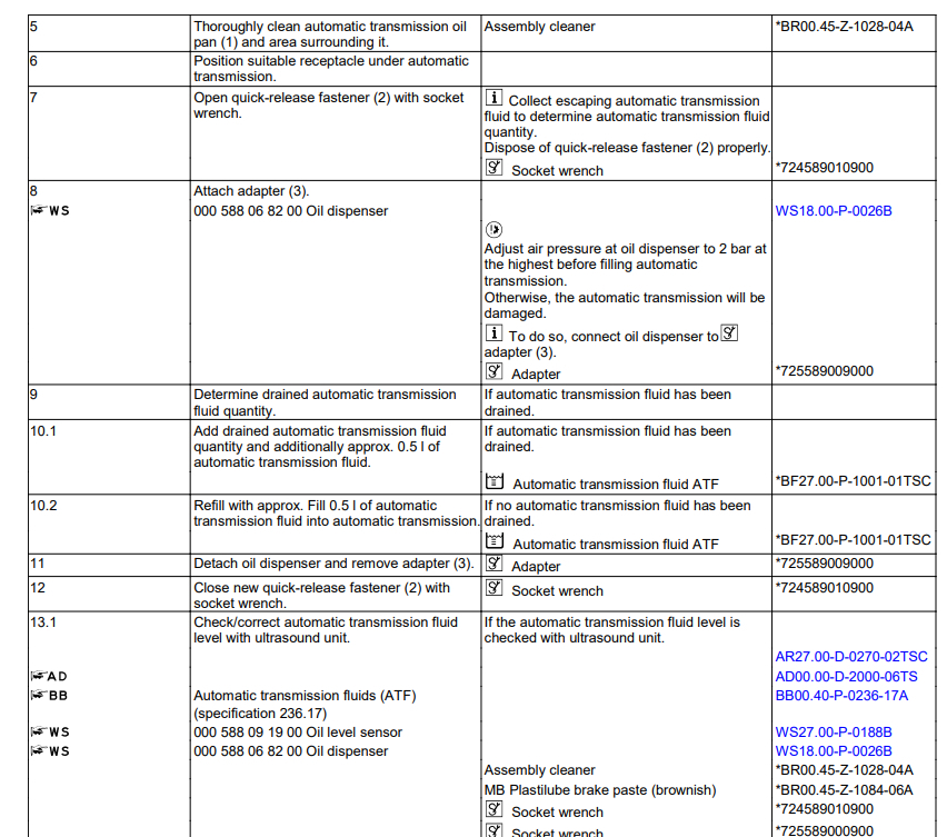

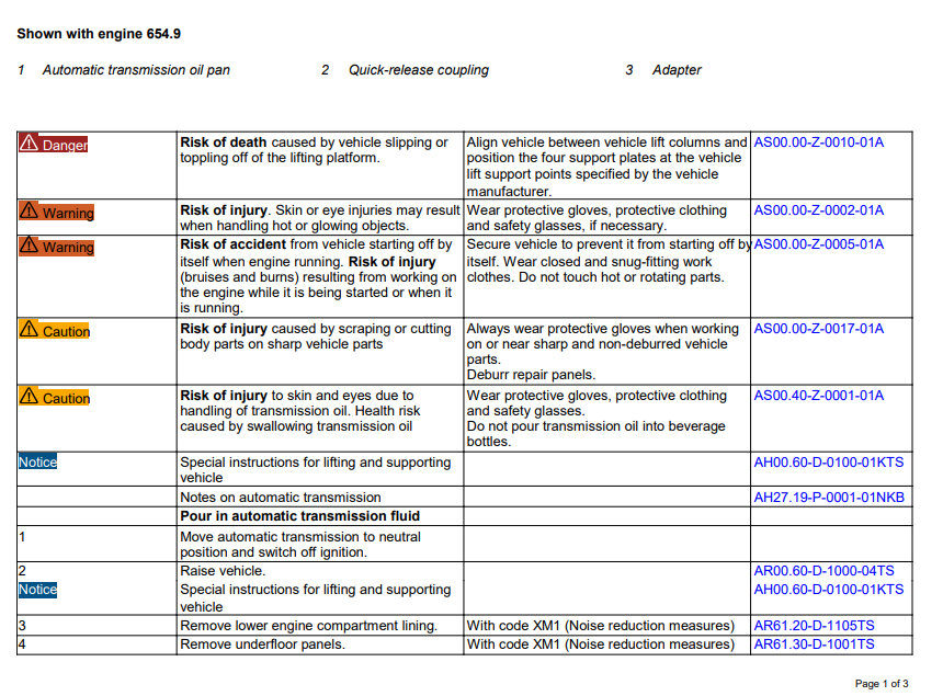

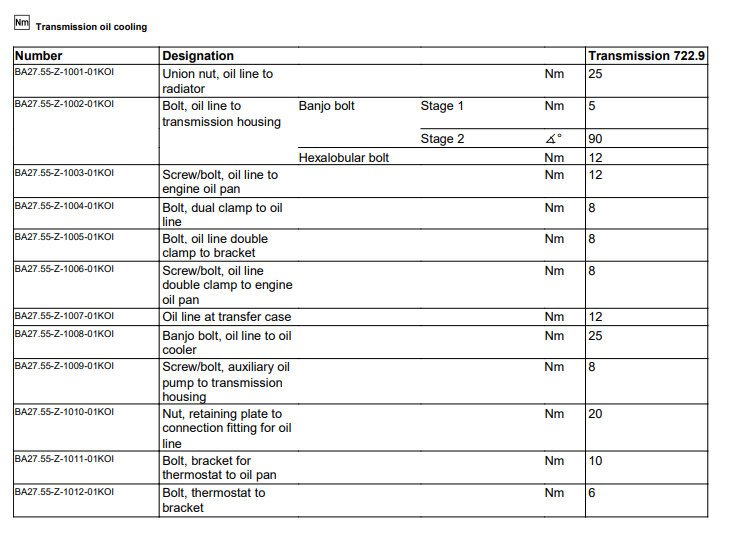

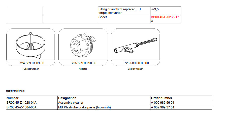

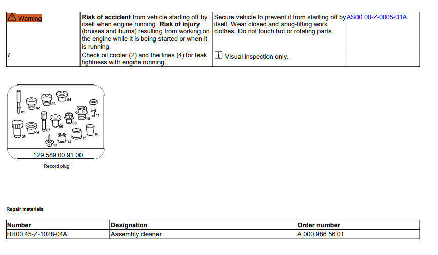

Here are the instructions on how to replace the transmission cooler and how to refill the transmission when completed. Also, I found the part number for the cooler as well.
Oil Cooler
7 Speed Trans 2115001700 $368.00
9 Speed Trans 2115001700 $368.00
Automatic transmission fluid ATF BF27.00-P-1001-01TSC
Check out the images (below). Please let us know if you need anything else to get the problem fixed.

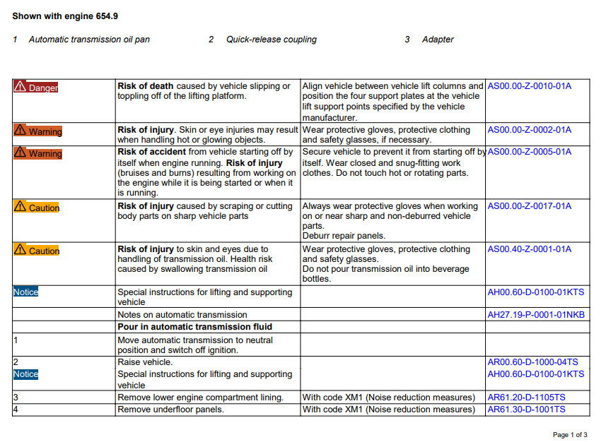

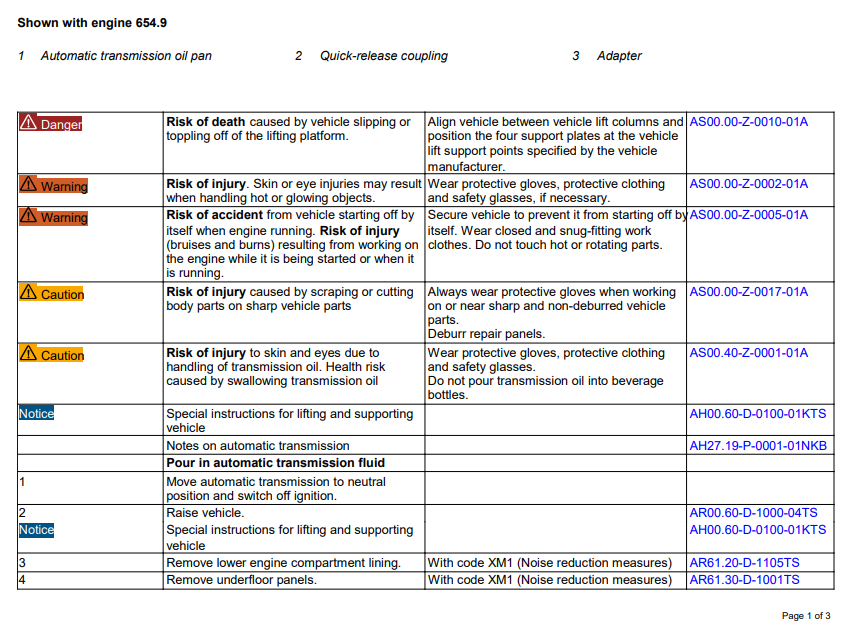

Sorry for being late with my answer. Thank you for your detailed information! Is there a way to check the transmission fluid level? Can you point me, please? What service can I use to access more detailed advice like work procedures? Thank you again and have a nice day!
Jul 5, 2023 at 12:17 PM
  • 55,399 POSTS

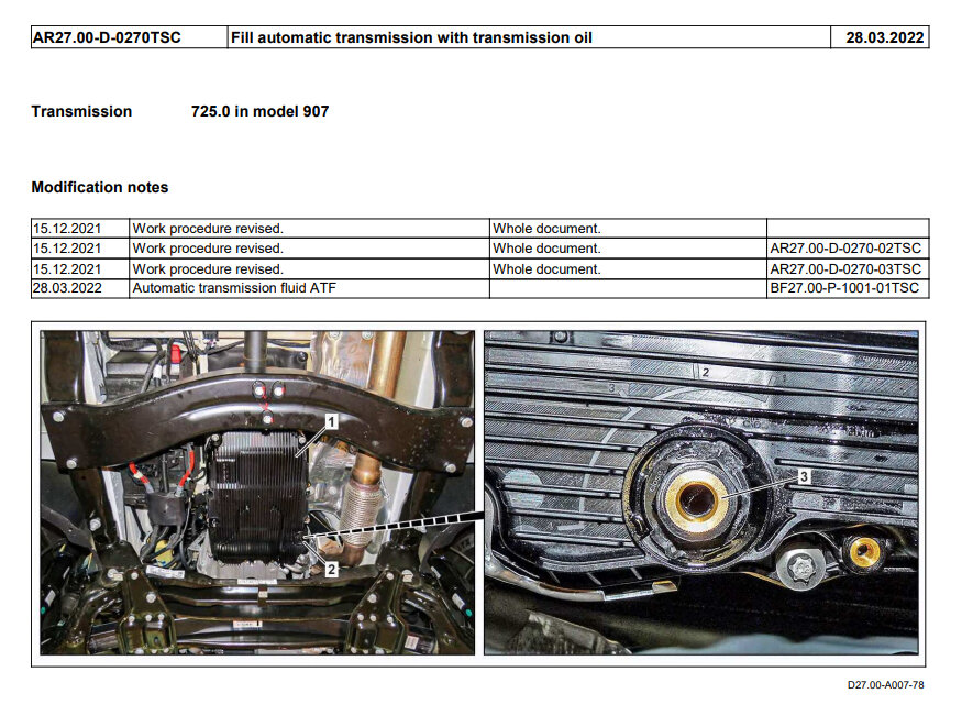

Nice work getting the job done. here is how to fill and check the transmission fluid level which is basically like this guide shows. Here is a generic guide to help you step by step with instructions in the diagrams below to show you how on your car:
https://www.2carpros.com/articles/how-to-check-and-add-transmission-fluid
