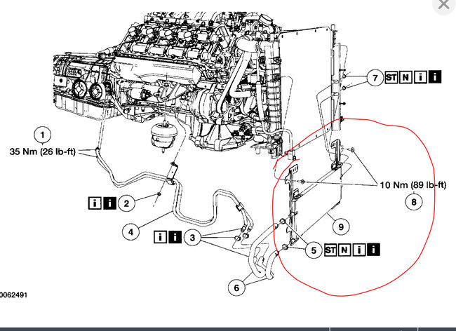

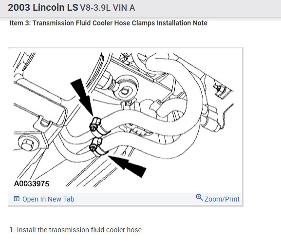

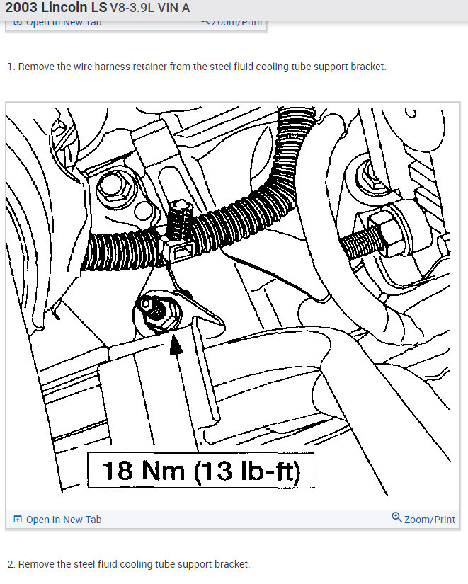

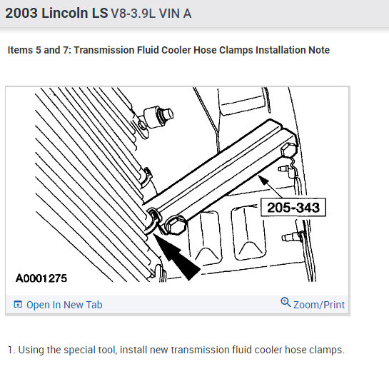

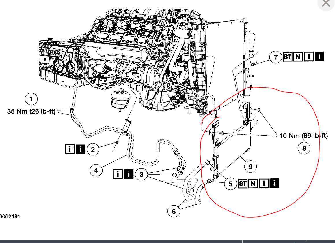

Thanks Jason for your response. The coolant lines are connected to the radiator right?
Sep 14, 2021 at 4:08 PM
SQM
  • 6,383 POSTS
Your LS should have a external transmission cooler. Located in front of the radiator (see diagram below).
The lines are connected to that cooler and not the radiator.
