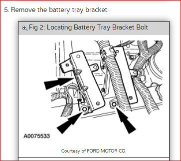

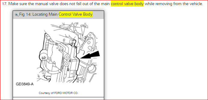

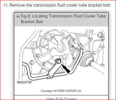

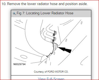

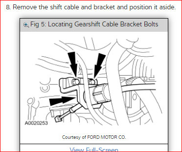

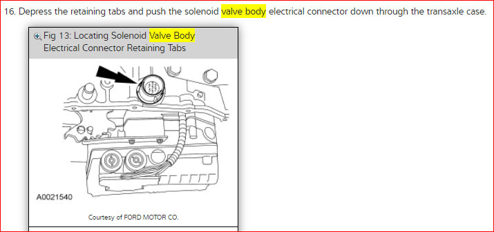

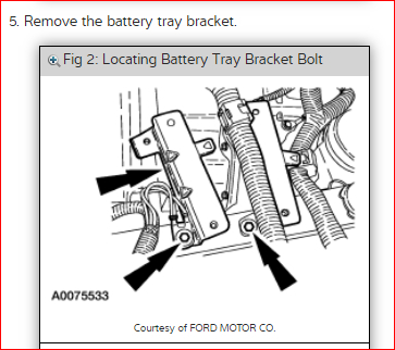

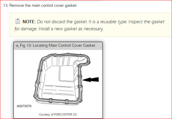

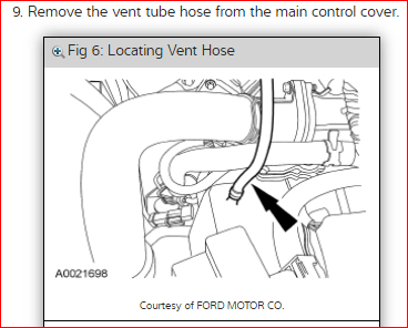

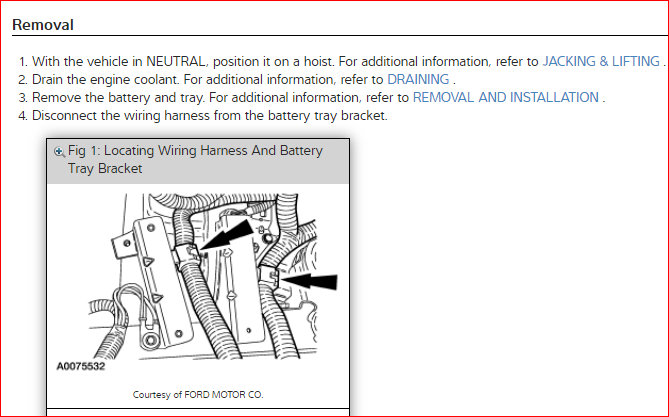

I need help on how to replace the transmission control solenoid.
Sep 4, 2018 at 12:36 AM
DANNY L
  • 5,648 POSTS
Hello, I am Danny.

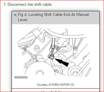

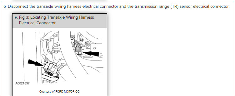

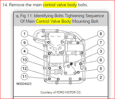

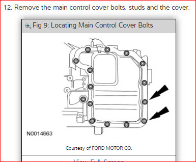

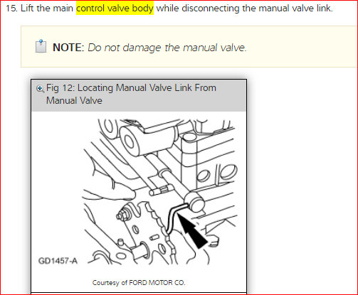

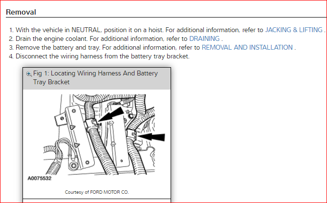

That involves a few steps to remove the automatic transmission pan to gain access to the valve body. I have attached a few pictures explaining the disassembly process. Hope this helps and thanks for using 2CarPros.

Thanks for the reply and the diagram they are very helpful. I was to change the Solenoid. However, the issue remain the same, when I start the vehicle, it take a long time for the transmission to engage and even after it engage it slip out again. Scanning gave me P0750, please what do you suggest?
