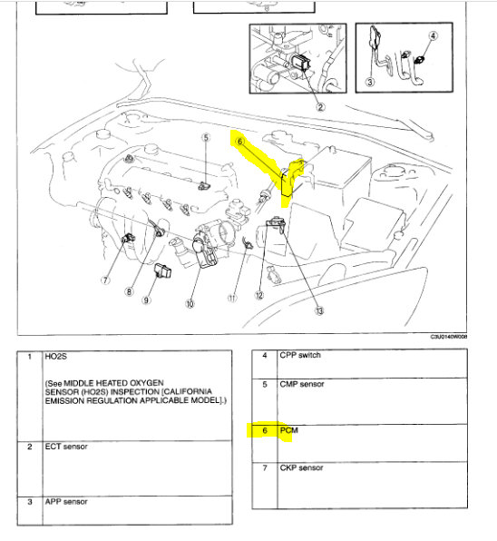

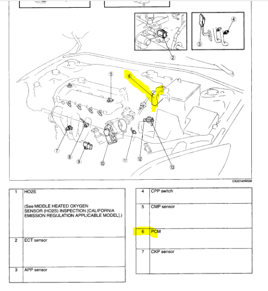

Where is the transmission control module located?
KINGADAM FADDEN
  • 2005 MAZDA 3
  • 2.0L
  • 4 CYL
  • 2WD
  • 270,000 MILES
Transmission control module location. Is it and the cou or ECU combined? If so, what does it look like and where is I located? Thank you
Monday, December 5th, 2022 AT 7:20 AM
  • 109,885 POSTS
On this vehicle, there isn't a separate transmission control module (TCM). In its place is the powertrain control module which controls the transmission.
The powertrain control module (PCM) is located under the hood next to the battery. If you look below, I attached a picture and highlighted the PCM.
