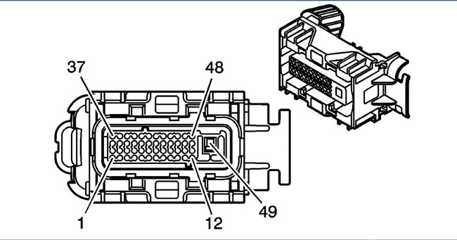

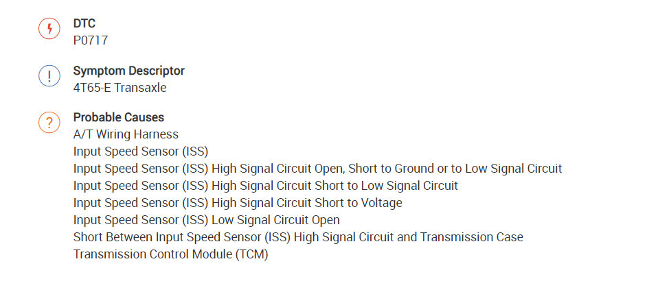

This car listed above has an ISS code 717 even after replacing the ISS. I suspect TCM, wiring or connector problems. Although there maybe something wrong with the shift solenoids or Valve Body, I am going to test and replace the connectors first. The problem is that I could not find a new 49-way TCM connector (I suspect the current one isn't right- somehow, it may have been installed from an incompatible car (but cannot be for sue). I have the 20-way connector and the TCM itself and the wiring harness. I got several connectors from other G6 cars but the Engine harness that has the 49-way TCM connector is unique to the G6 GTP 3.9 2006. I could not find this car anywhere (not the MALIBU 3.9 2006 either). So, I plan to rewire a TCM connector I got from a 2010 IMPALA (which happen to use the same TCM but not the same engine harness and the needed connector).
Q: is this wise? can it be done without damaging the connector?
if not, any advice as to how to proceed?
Jun 11, 2021 at 10:31 PM

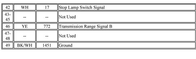

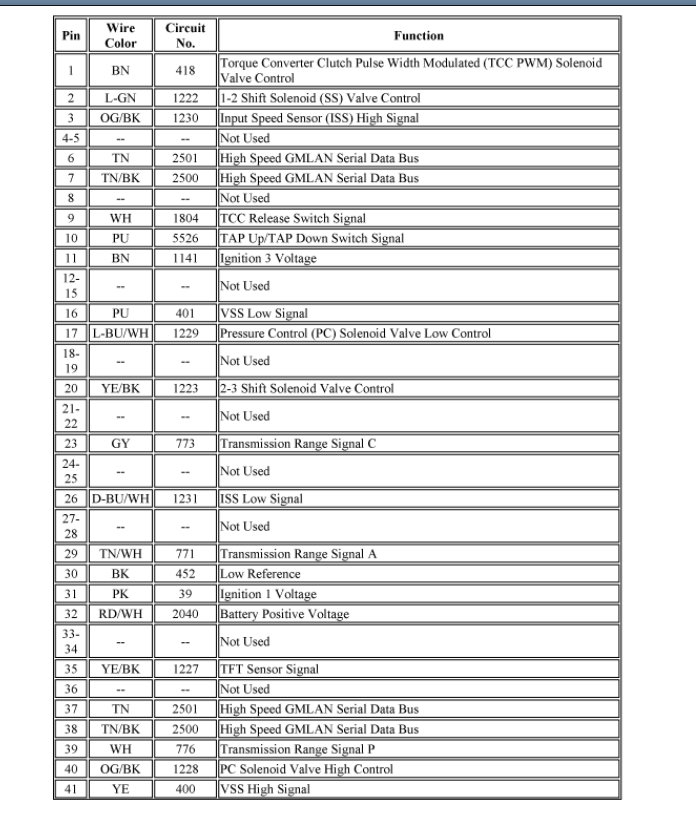

Good morning,
I attached the diagram for the 49 pin connector for you. The pins are numbered and the color wires need to go to the correct pin.
A lot of wires will be the same as the Impala but a lot will not be. Join the ones you connect by soldering and shrink-wrapping the wires for a good solid connection.
Once you replace the connector, see if the code is still there. If it is, let me know and we can continue on the diagnostic.
Jun 11, 2021 at 11:45 PM

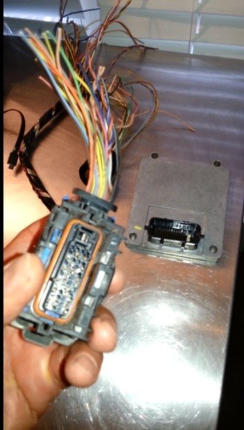

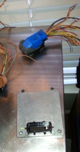

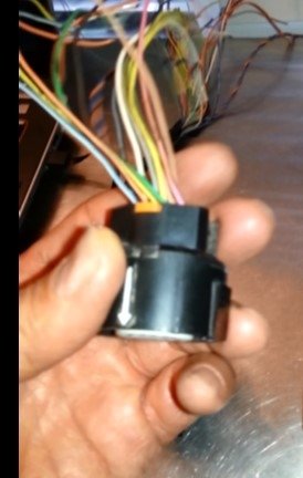

I ended up using 29-way connector from a 2006 GTP. All I had to do was splice the 49 and 20 way connectors. Here is an update:
This G6 GTP 3.9 Transmission FR3 4T65E version has been registering ISS 717 code for almost 2 years with no symptoms that the driver could detect. The ISS was replaced but that didn't erase the code. Recently, the TCM was replaced and programmed: Still no change. This past week, the 49-Way connector and wires to the TCM were replaced by splicing. The code 717 was registered again. Finally- 2 days ago, the 20-Way external connector and wires to the transmission harness were replaced by splicing as well. When the job was done, everything was put back together except the Electronic Brake Module Connector was left unplugged *by mistake* as the car was being tested. Later on, the connector to the EBM was reconnected while the car was running and the scanner connected to the DLC *again, I think the engine should've been turned off while reconnecting the brake module.*  The scanner initially displayed a message: "Communication with the Body Control Module was Lost."  No code was registered. The car was taken for a drive cycle and the check engine light was actively cleared. Few minutes into the drive, the following occurred:

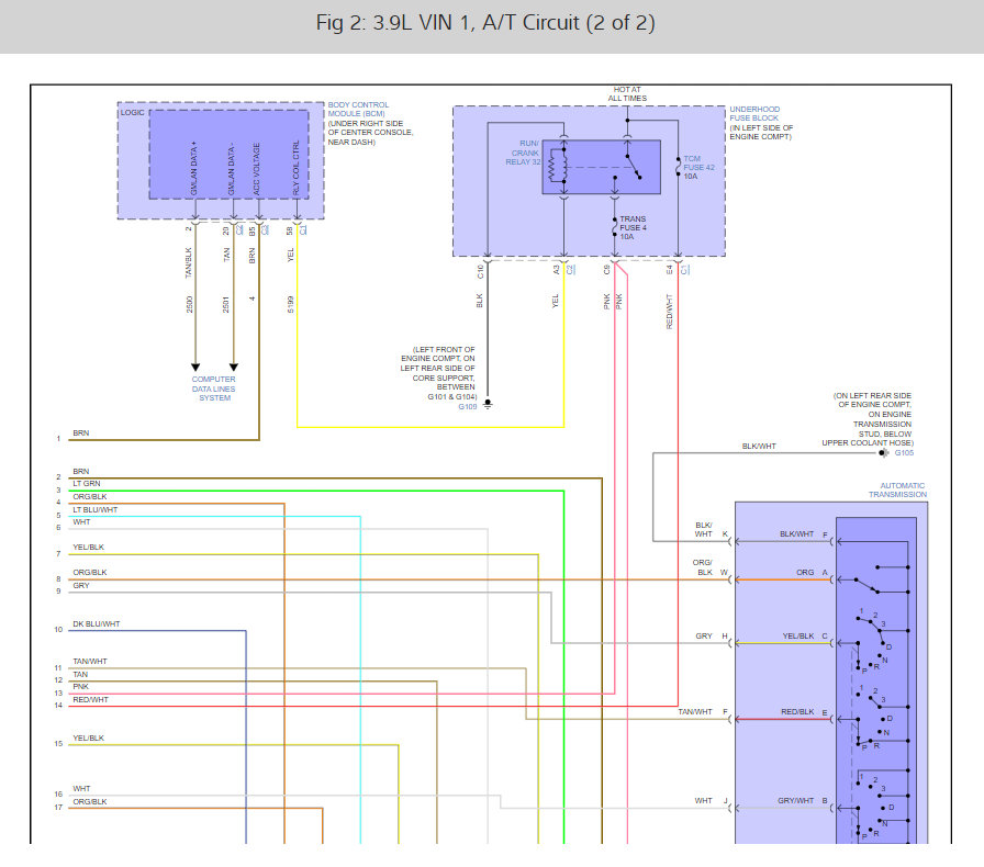

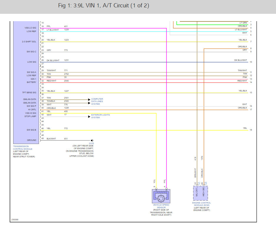

What happened? The ignition wire (pink circuit 1339 or simply 39) from TCM 48-way connector pin 31 to transmission harness 20-way connector pin E showed no continuity. Is this normal when the key is in the off position? Does this wire go through a fuse or fusible link? The wiring diagram shows transmission fuse 4 in the junction block but no fusing in the wire in between pin 31 and pin E unless I am not reading the diagram correctly. All other connections showed continuity
I am not sure if I should test while the engine is running or while the key is in the on position or for that matter while battery voltage and ground are connected. Could this be a simple splicing issue or more? I think the misfire is the result of low voltage rather than damage to ignition switch.

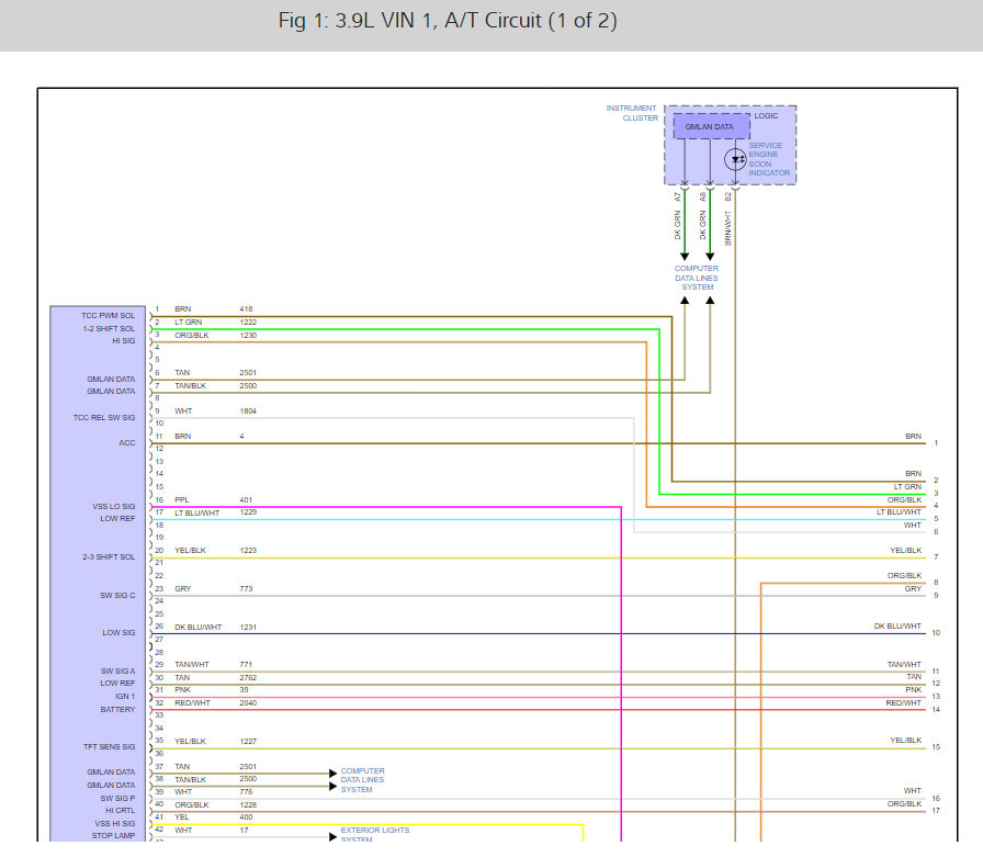

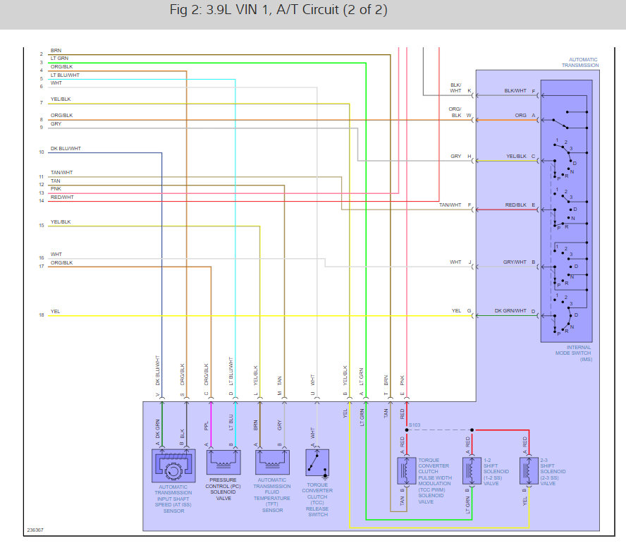

This question is from last year so I don't know if the member will respond. Here is the transmission wiring diagrams and a guide to help you test the connections:
Aug 30, 2022 at 6:18 AM
JAMESB2019
  • 42 POSTS
Hello Ken, what is this member's question? I did two tests on each transmission wire (one by one): I did a continuity test, and I did voltage test wherever applicable. I then repaired, spliced new connectors and made sure all wires and harnesses were protected and channeled them through flex conduits. The pink wire was severed and was hanging by the thread which made the car misfire so badly (I do not recommend any attempt to drive the car if this wire is affected). It was very laborious to go through each and every wire (1000- dollar automotive electrical testing job if that was done at the dealership. I just happened to enjoy the electrical testing aspect of it. The rest was very tedious! It took way too long into the early morning hours by the time I was done, but it was worth it. And no, I do not recall any fusible links in this harness. There was a fusible link between the alternator and the battery through the starter. But that was when I was rewiring the car with new harnesses.
