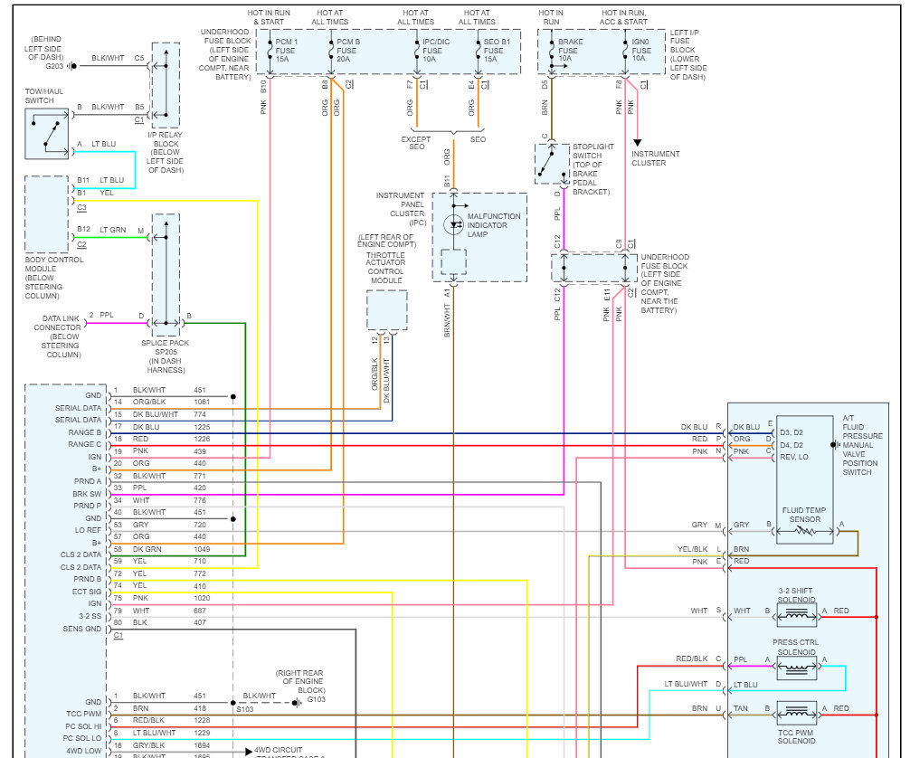

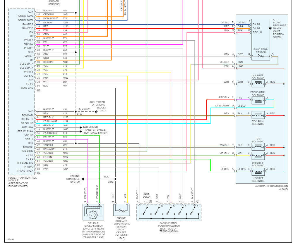

I'm replacing my transmission and I had an accident with my control module connection was cut off. Now I'm trying to put it back but first I try replacing the plugs but the wire color is different.Now that's why i need to find out the diaphram for both control module plugs for transmission .
Aug 9, 2023 at 5:54 AM
  • 55,433 POSTS
Sure, here is a guide to help you test the connections and the transmission to PCM wiring diagrams you requested.
Check out the images (below). Please let us know how it goes
