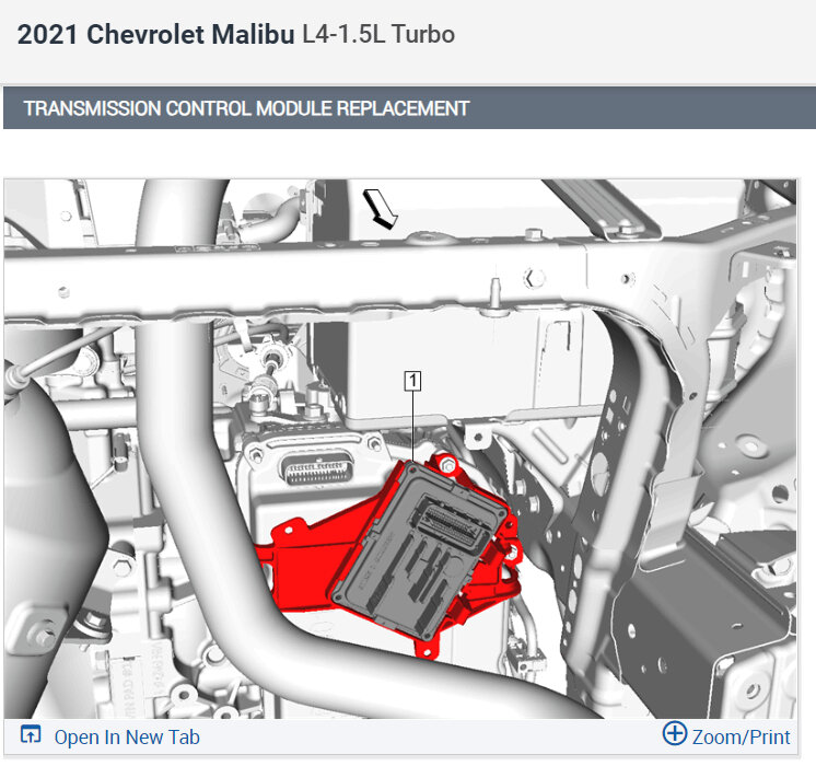

Where is the transmission control module located?
2021 CHEVROLET MALIBU
35,000 MILES
SHOTTY2006
Where is the transmission control module at on the car listed above LT model.
Sep 9, 2024 at 8:21 AM
  • 55,433 POSTS

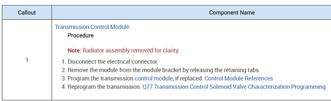

Sure, the transmission control module (TCM) is on the rear of the transmission near the main transmission electric connector. Here is the location and how to change out the TCM. Check out the images (below). Let us know if you need anything else.
