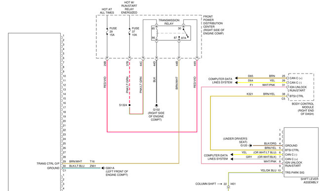

Transmission Control Module wiring diagram needed?
2015 CHRYSLER 300
147,000 MILES • 6 CYL • 4WD • AUTOMATIC
SHANNONLEE85
Car won’t start, it says it is not in park when it is. It got super cold out and started acting weird and then just stopped working. Brother-in-law has computer he hooked up and Tom is coming up. The plug was in rough shape, so I ordered a new one. Got it hooked up but now says low power. I think we need a wiring diagram for the TCM module if possible.

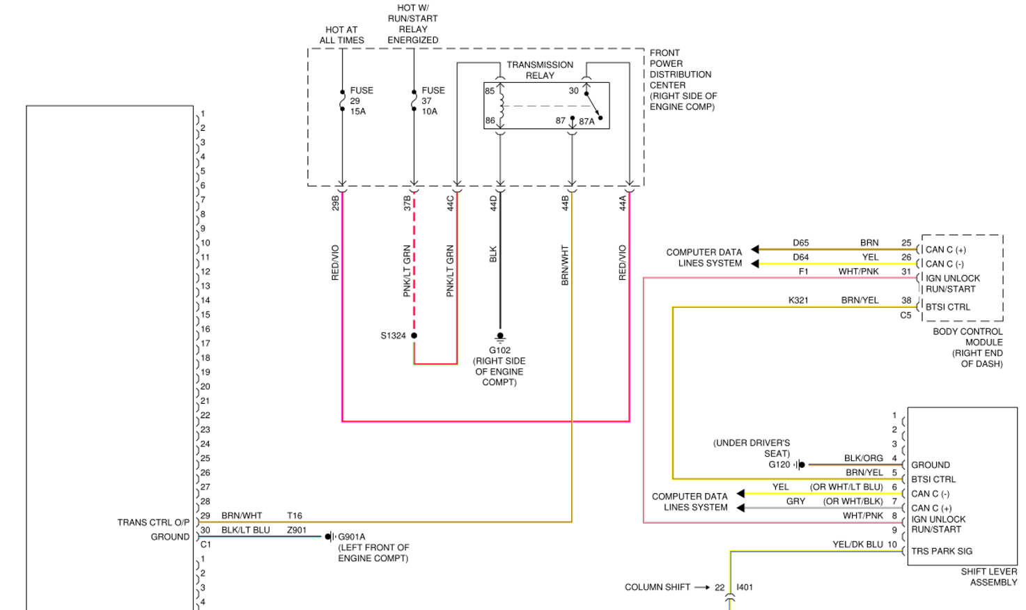

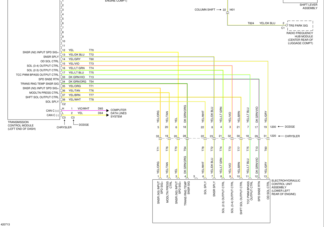

Below is the wiring diagram for the 5speed automatic transmission.
Hope this helps.
Cheers, Boris
