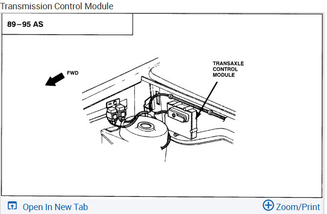

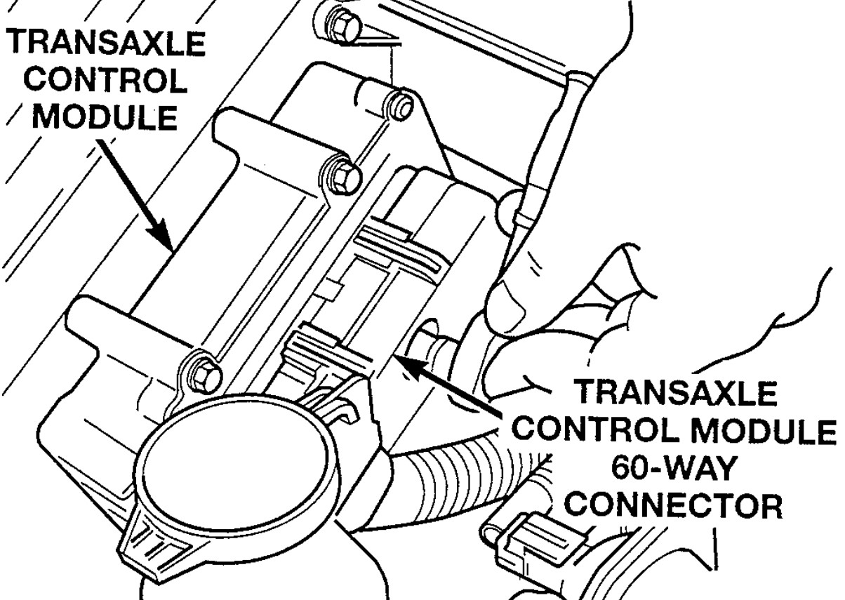

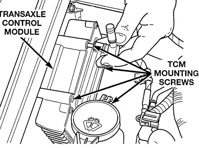

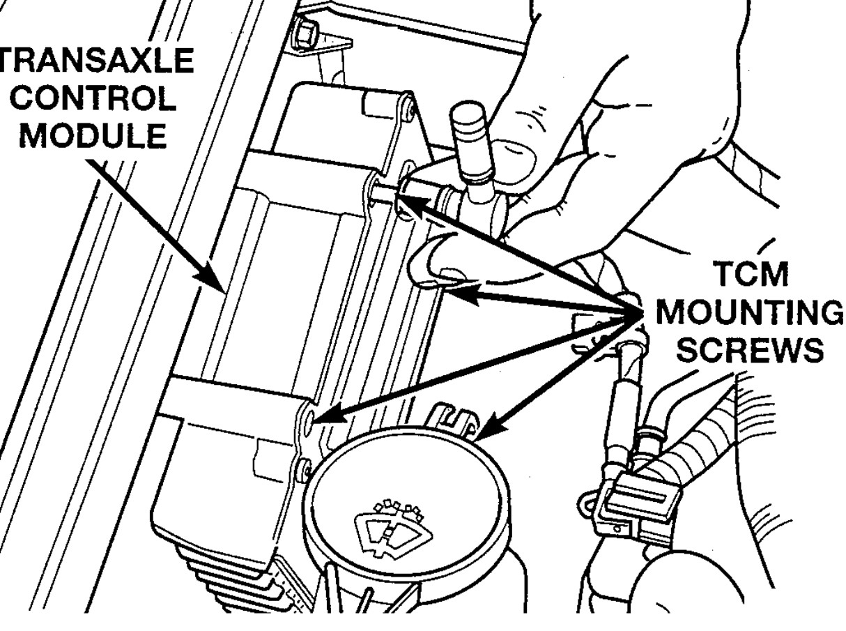

Transmission control module location needed.
May 4, 2025 at 3:56 AM (Merged)
  • 55,433 POSTS
The TCM is located at the right side of the firewall, check out the images (below). Let us know if you need anything else.

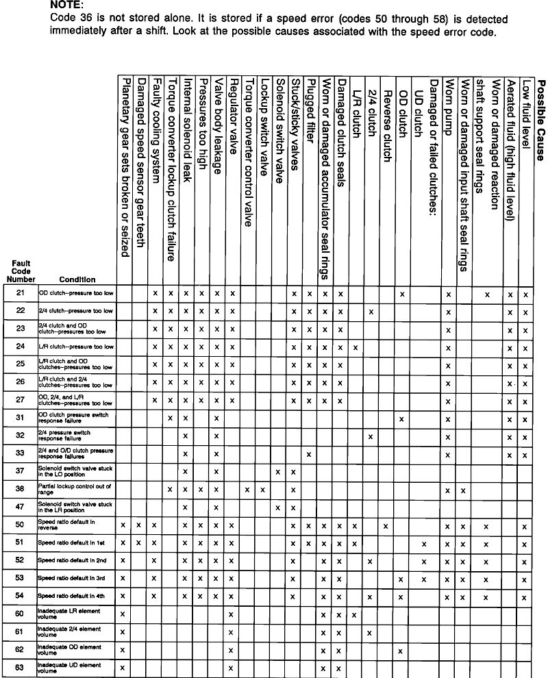

I didn't mean to stick my nose in an ongoing conversation. I've been following along to learn the solution so I can add that to my memory banks. My previous comment from a couple of days ago was to clear up the confusion about programming to help you get to the solution sooner.
That said, once your system went into limp mode, there is going to be at least one diagnostic fault code stored in the Transmission Computer. That code needs to be read and recorded as the starting point in the diagnosis. Chrysler made reading engine fault codes much easier to do yourself than any other manufacturer, but for codes in the Transmission Computer, you need a scanner or one of the newer simple code readers that can access the Transmission Computer. I'm not up on the latest code readers, but I know there are some that can talk to the Anti-lock Brake and Air Bag Computers. For most people, buying a scanner is not a good value unless you will have plenty of need for it. Instead, visit any shop with a scanner old enough to work on '95 and older models. Be sure to write down the exact fault code numbers. They will have two digits. If their equipment provides a description of the code, still write down the numbers as those descriptions can vary in interpretation sometimes.
If you've recently had the computer or the battery disconnected, any fault codes will have been erased. Then you just need to drive the van until the problem occurs again. At that point the code will stay in memory until you have it read, even when you restart the engine to get it out of limp mode. The tire size and pinion factor we keep talking about does not get erased from memory when the battery is disconnected.
Steve or any of the other experts will be able to determine the best way to continue once they know the fault code number(s). The computer itself is usually way down toward the bottom of the list of suspects, as failures aren't real common. In your other post, I described the clutch volume index, (CVI) numbers used to determine the amount of life remaining in each of the four clutch packs. I also described how this computer learns, or compensates for worn clutch plates by adjusting when a clutch pack applies or releases during shifts to keep the feel of the shift nice and solid, but as one or more of those CVI numbers reaches its maximum, the computer can't update any further. That's when you can get the characteristic "engine runaway" we used to observe decades ago telling us a rebuild was in our future. With this transmission, it will never get to where you experience that "runaway" Long before it gets that bad, the computer detects the small increase in time the slippage occurs between gears. When that is considered to be too much time, it sets a fault code for "gear ratio error". In simple terms that means in a certain gear, at a certain engine speed, there is supposed to be a corresponding tire speed. When the engine speeds up during the shift, the computer sees that slippage. This is where looking at the CVI numbers can verify the diagnosis of worn clutch plates.
That's just one example of what the fault codes can tell us. Slipping clutch packs only show up while you're driving, so you start out normal, then bang down to limp mode when on the road. The computer also performs electrical tests on the shift solenoids, pressure sensors, and temperature sensors. Those tests begin as soon as you turn on the ignition switch. If an electrical defect is detected, the system goes into limp mode as soon as you shift out of "park". You'll still have "park, "reverse", and "neutral", but only second gear going forward.
I found this chart that shows all the things the computer can detect, along with the possible causes. I have four Caravans / Voyagers, including a '94, so I saved a copy of this chart for my use later. If you find it's too hard to read, first try to copy and paste it into a typing program like MS Word, where it can be expanded. That's where I prepare and format them.
If that doesn't work, I can split it into parts that can be expanded, then repost them for you that way.
I hope that helps. I'll go sit in the corner now until you guys need more of my wondrous wisdom.
