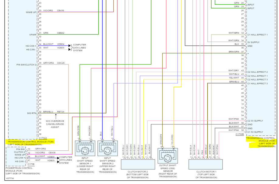

I need a diagram or instructions so I can pin out my TCM to check all the wiring on it. Any help would be appreciated.

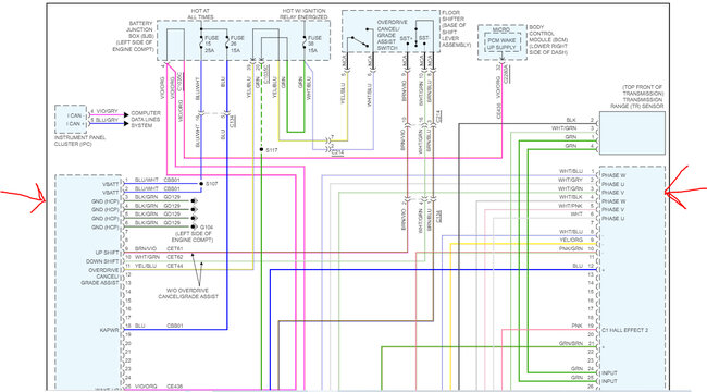

No problem. If you look below, I attached two pics. Both pictures are from the same page of my manual specific to the transmission wiring schematic.
Note in pic 1 I have two red arrows. They are pointing at the TCM. If you look at pic 2, I highlighted the TCM indicator.
I had to cut the single page from my manual in two so you could read them. That's why there are two pics. I did overlap the two so you can follow from one to the next.
