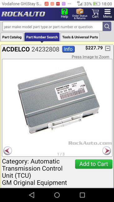

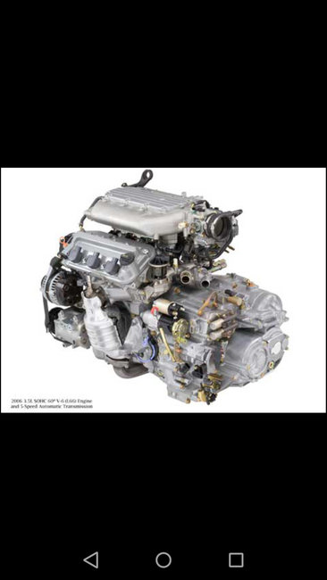

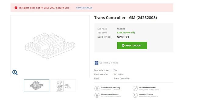

I want to know the type transmission control module for my vehicle listed above redline. below is the image of the engine and the transmission. i also want to know if the second image is the right transmission control module for the transmission.

There are two possible transmissions for your vehicle, the GM 4T45-E or the 5AT made by Honda. They use different controllers and programming. The easy way to tell them apart is that the GM transmission has 4 speeds while the Honda unit is a 5 speed.
As for the control module, it will depend on which transmission you have and which programming revision it has in it. What is the issue you are having that makes the transmission module the suspect? Do you have the scan tool and programming device to program the replacement unit?
