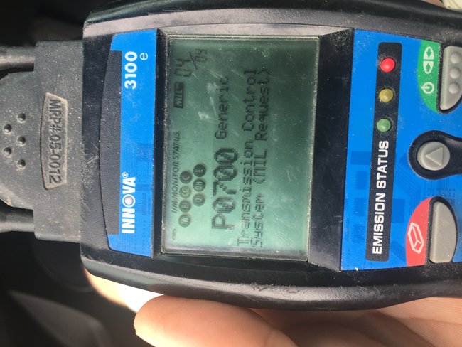

It is code P0700.
Sep 7, 2019 at 1:19 AM
TJ LADUCER
  • 7 POSTS
Says transmission control system mil request.
Sep 7, 2019 at 1:20 AM
Okay, that means there is a fault code. I need that code.

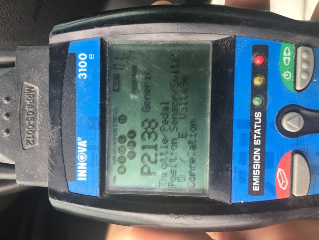

Also codes P2138 and P0796.
Sep 7, 2019 at 5:36 AM
TJ LADUCER
  • 7 POSTS
P2138.
Sep 7, 2019 at 5:38 AM
TJ LADUCER
  • 7 POSTS
P0700.
Sep 7, 2019 at 5:39 AM

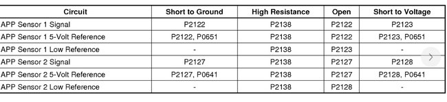

Okay, the 2138 is for the APP sensor which is on the floor. It is the gas pedal.
Checks need to be done to verify the failure.
