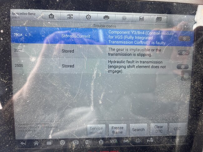

I bought it with a dead battery, jumped it and it started, took it for a drive on my driveway and second gear just slips.

If the integrated transmission control module (VGS) is what requires coding.

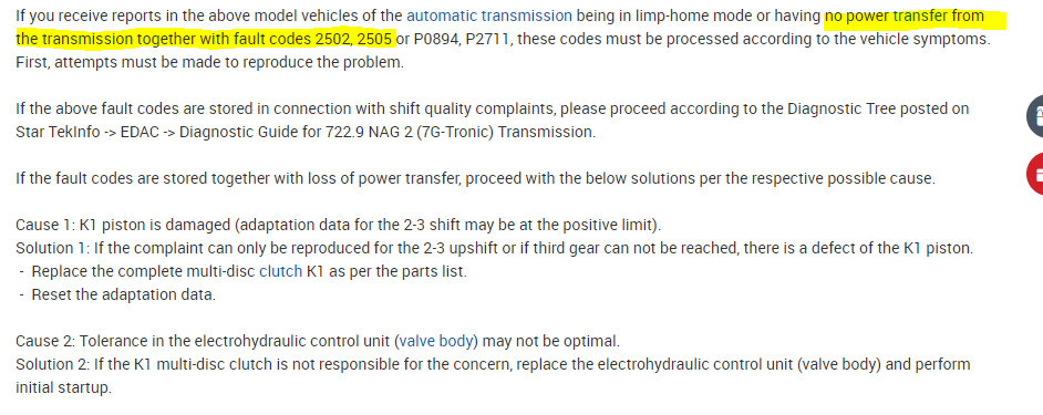

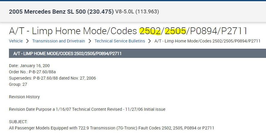

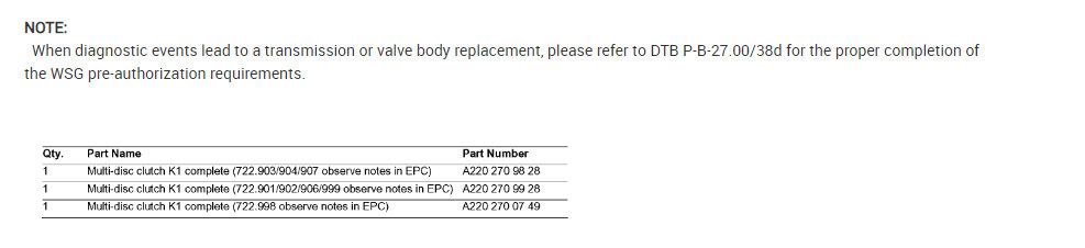

Also, I attached a technical service bulletin below which I found that may be of interest to you. Take a look at it and let me know your thoughts.
Mar 24, 2024 at 6:42 PM
