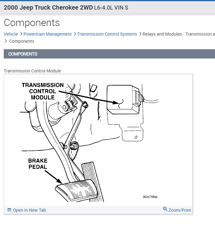

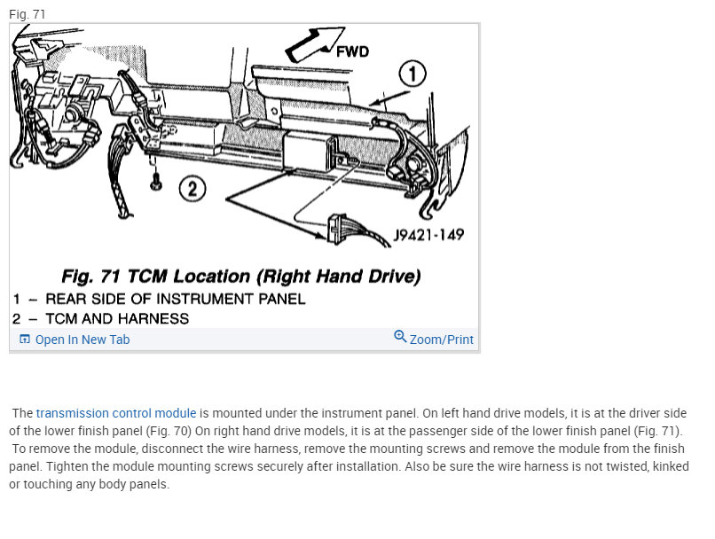

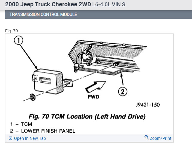

Transmission computer location needed.

The transmission control module (TCM), is located under the driver side dash, just right of the accelerator pedal.
