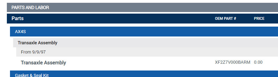

I just need to know which vehicles and years i can pull a transmission from that are compatible with mine!
Apr 4, 2021 at 12:43 PM
Experienced Mechanic
18,907 POSTS
Looks like you have an AX4S - AXOD transmission. So you will want to stay with this which looks to have only come in the 1995 - 2000 Windstar.
I would not stray from this model range as you get into mounting issues and wiring issues.
I attached the part number below so that you can search it online and it pulls up all sorts of options.
Let us know if you have other questions. Thanks
