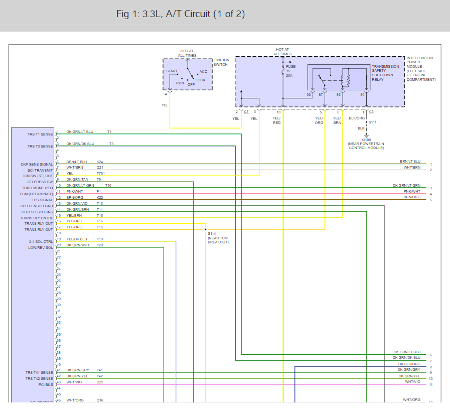

Hey 2CarPros community,
Our van is in limp mode right after startup and therefore will not shift.
Engine starts perfectly fine however.
With an OBD scanner I checked the input and output speed sensors. Both work fine and have an output to the computer (speedometer works as well).
I also checked the EATX relay. It works. Has a 12 volt supply. And we also checked the control and two output wires between the relay and the TCM. They are fine as well (Pin 15, 16 and 17 at the 60-pin connector at the TCM).
That is what I have so far.
The next things I thought about to check are the TCM and PCM somehow, right?
What tests would you recommend and suggestions do you have?
Or any other ideas?
I would really appreciate any ideas, support and posts here.
I am looking forward to find out some new information and finally find the problem/solution even for this problem.
Thank you all in advance!
- Alex

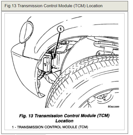

ALEXW_159
  • 10 POSTS
TCM Error Code is:
PO605 Internal Transmission Controller - ROM Fail
So the TCM itself needs probably to be replaced, right?
Dec 26, 2020 at 3:03 AM (Merged)
  • 55,399 POSTS
Yep, that is what that means. The computer is having issues. Here is the location so you can replace it I would try a used one. The TCJM is subject to water damage so it makes sense.

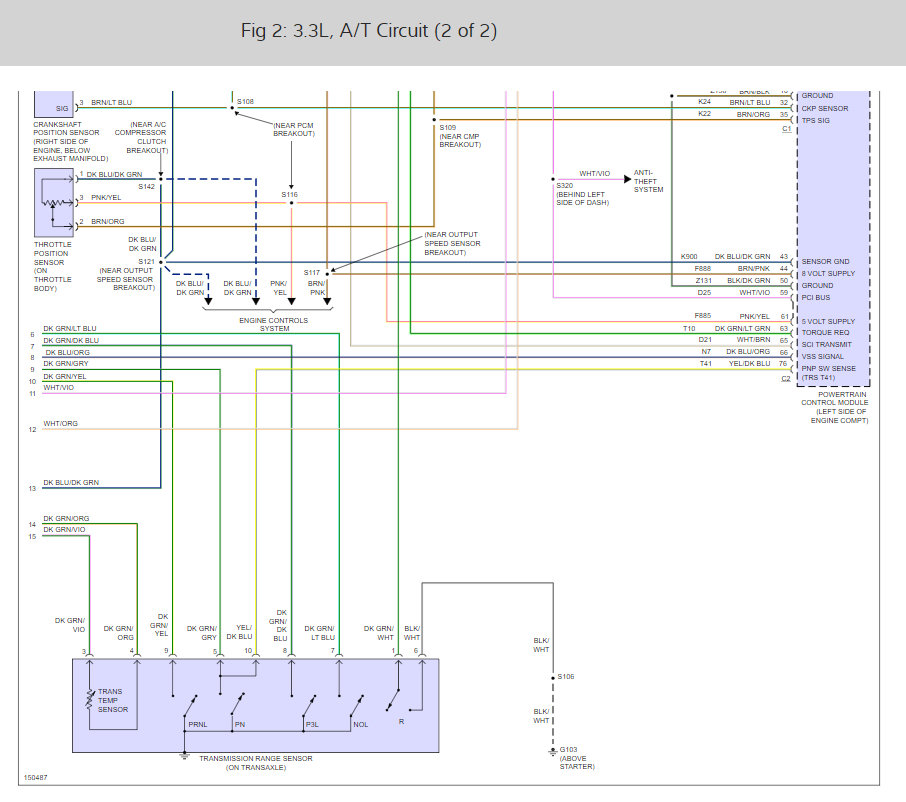

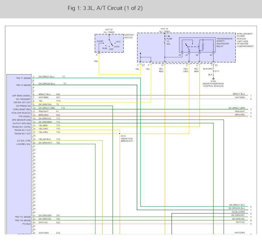

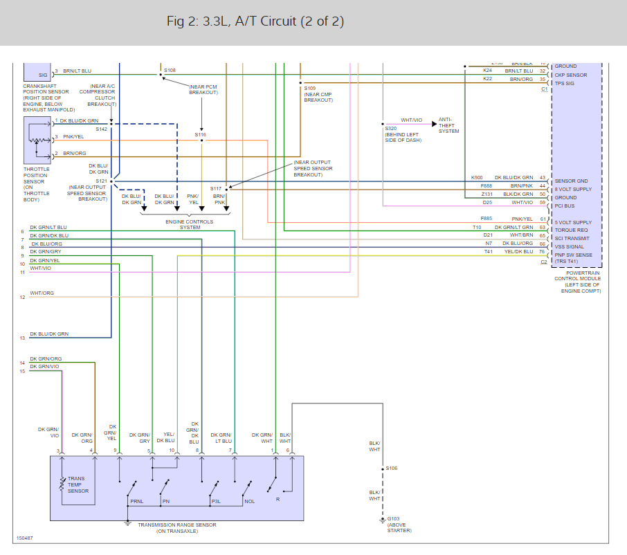

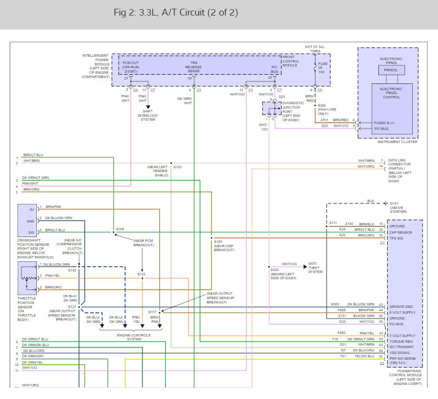

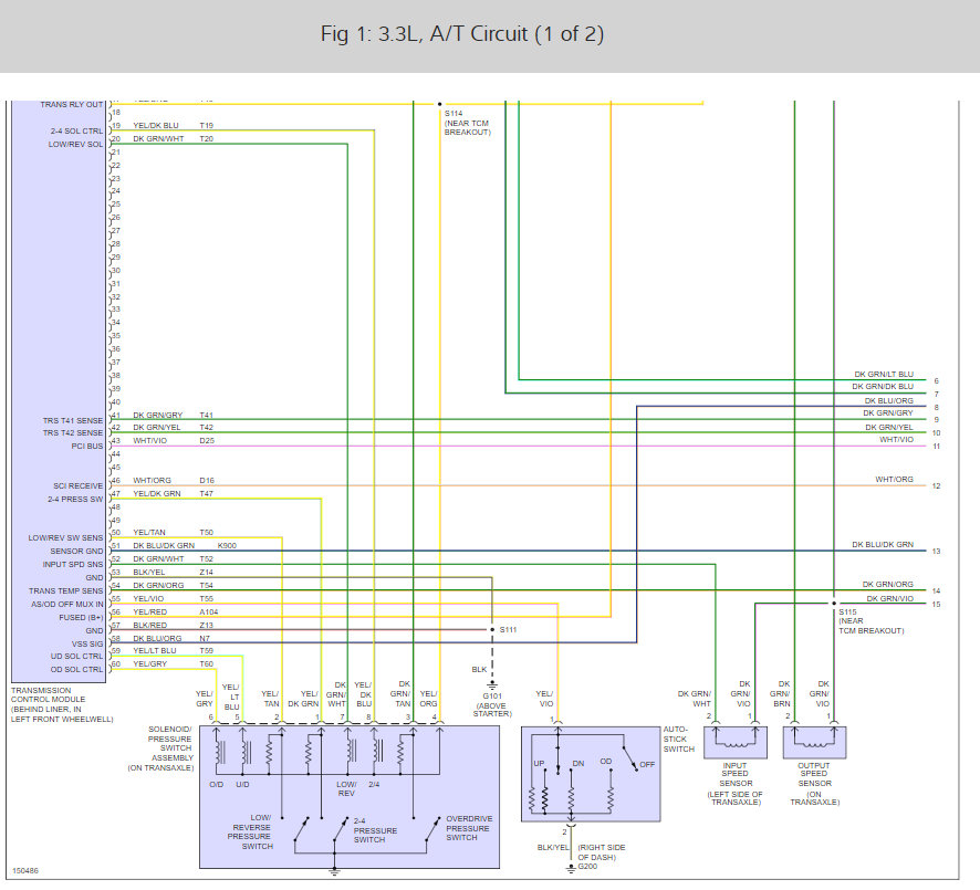

ALEXW_159
  • 10 POSTS
There are a lot of posts that say that the P0605 could also be caused because of wiring problems rather than module failure. Especially 12 volt supply wiring and ground wires (potentially also the module output).
This could also be still the case for me, right?
I will try to get a TCM from the junkyard on the weekend to somehow figure it out.
References:
https://www.2carpros.com/questions/2004-chrysler-town-country-p0700-p0605
https://repairpal.com/OBD-II-Code-P0605
https://www.obd-codes.com/p0605
  • 55,399 POSTS
It could be the the wiring but it sounded like you checked that in your first post. I will be happy to back over it will you with this guide and the TCM wiring diagrams below.
Please check power and grounds and test through the transmission range sensor.
Please run down these guides and diagrams and report back.

So, we replaced the TCM with a $35.00 used one from the junkyard on the weekend and that worked! Just replaced the TCM, plugged it in and it immediately worked.
The one I got was from a 2003 Grand Caravan if I remember right. It was the best one we found and it was in an pretty good condition.
I could not found holes or something similar on the old one, but it already looked a bit corroded.
We also checked the wires again, but they were still fine and looks as they are in a pretty good shape still.
So it worked all out for me!
Thank you very much to all people here for the great and fast support!
And we hope that this post might also help some other guys.
Thank you to 2carpros!

Transmission remains in limp mode and does not shift. After clearing the codes, the code for the EATX relay continues to show up. I have been told that the failure of this relay may cause the transmission to behave in this manner. So, hopefully, the easy fix is to replace this relay. However, I don't know where this relay is located, and no manual or diagram that I can find lists it. I suspect that it is probably listed somewhere by some other name that I don't recognize. I have seen under hood pictures that list both a safety shutdown relay and an automatic shutdown relay, but neither of those sounds like it would be the right relay. Now, of course, comes the actual question. Where is the EATX relay located on a 1992 Chrysler Town & Country van? Thank you for your help.
Dec 26, 2020 at 3:04 AM (Merged)
CARADIODOC
  • 34,379 POSTS
The closest I have is a '94 service manual, but it should be the same. There's two rows of four relays under the hood. On the shorter side of the fuse box, next to the latch, the relays are automatic shutdown, low radiator fan, fuel pump, and radiator fan ground. Just off center in the second row is high radiator fan, AC clutch, backup lamps, then the EATX relay. In the wiring charts they list the EATX relay as the "safety shutdown" relay.
There's a couple of different fault codes related to the relay. If you tell me the exact code number, I may be able to offer some suggestions.
