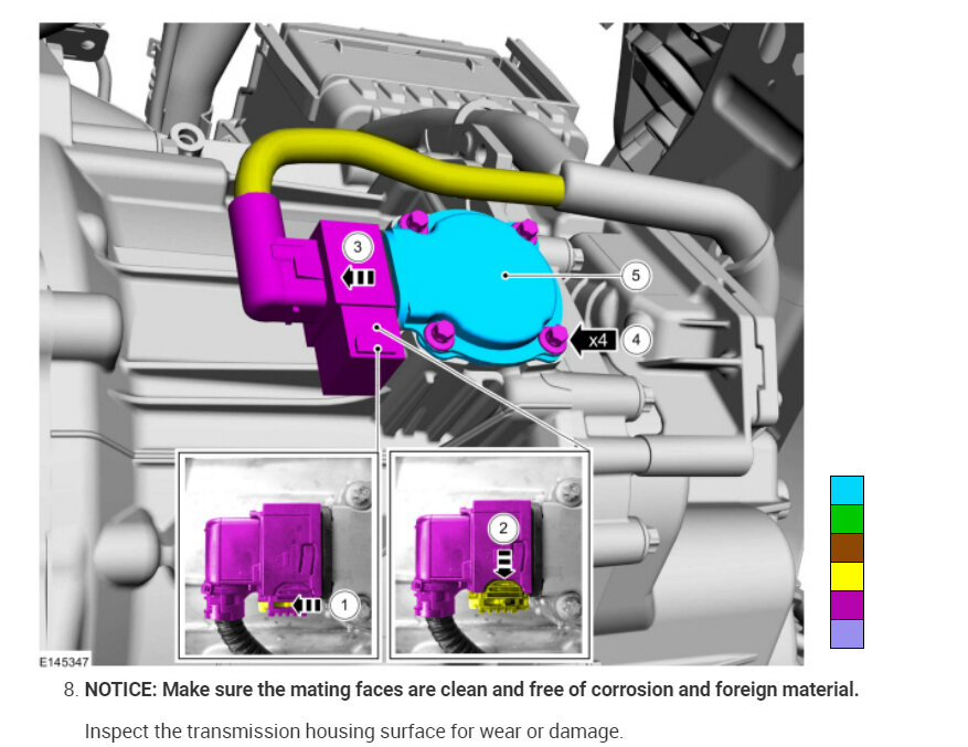

It will drive normally but once you try to hit the gas to downshift the transmission slips?
112,000 MILES • 2.0L • 4 CYL • 2WD • AUTOMATIC
BHAMDOC1973
  • 2,007 POSTS
When I finally got home it displayed message transmission overheating, stop slowly. I scanned it and had many codes, deleted them and then rescanned without driving it I got the 2 codes showing.
P0805-00-AF
P286F-00-EC
P2872-00-AF
P0805
P286F
P2872
P0809-00-28
After deleting I got P0805.

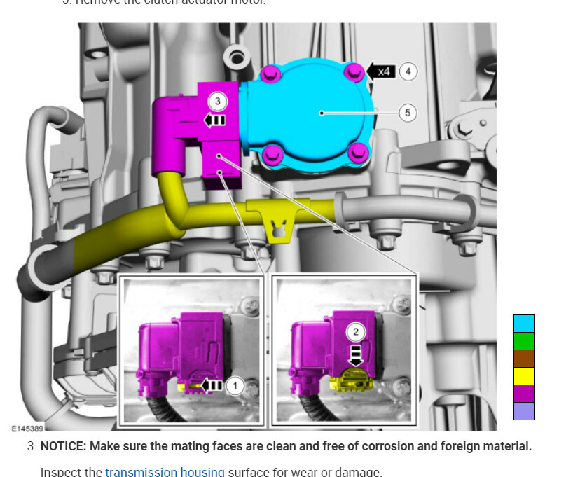

So, what happens is the clutch actuators stop working or the clutch fails.
P0805 is related to the Clutch Position Sensor Circuit,
P286F suggests a problem with the Clutch 'A' 'Stay Engaged' Command,
P2872 is associated with Clutch 'A' Stuck Engaged
P0809 represents a Clutch Position Sensor Circuit Intermittent fault,

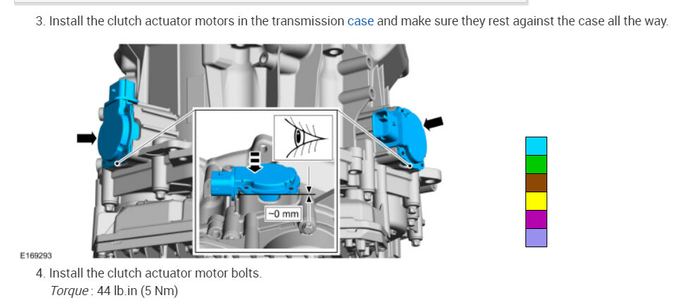

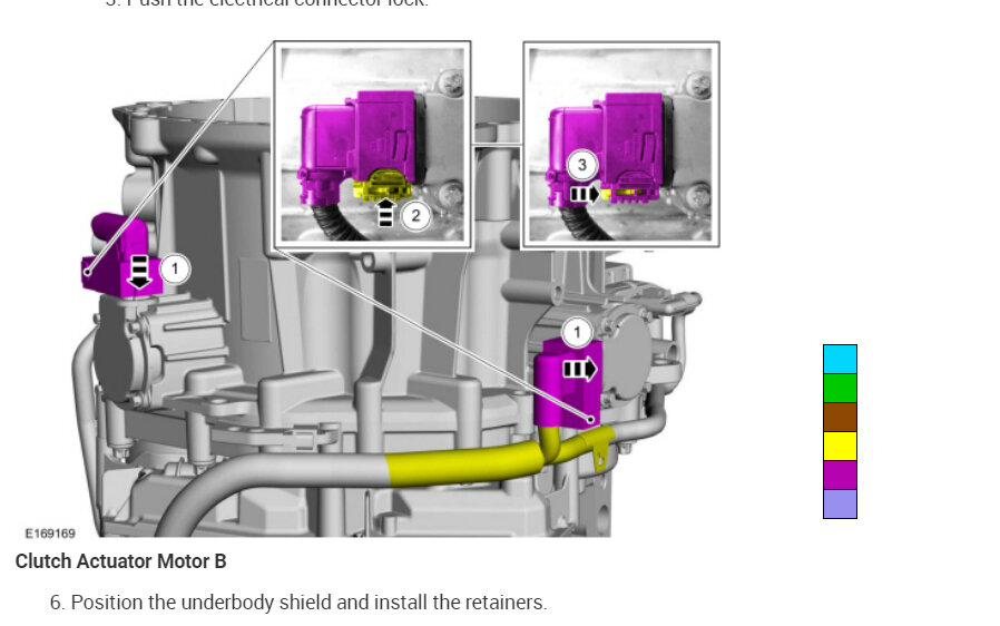

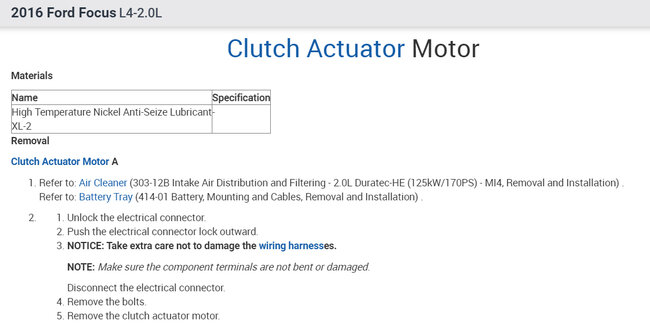

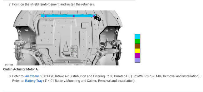

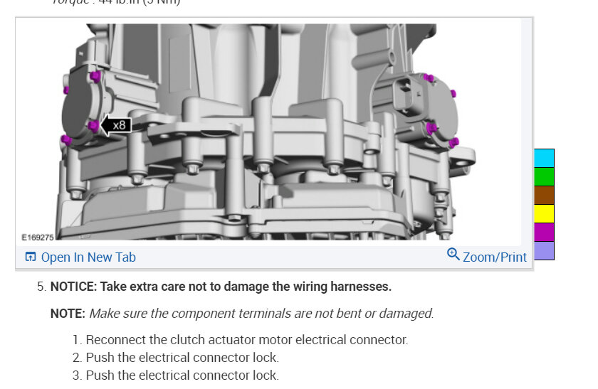

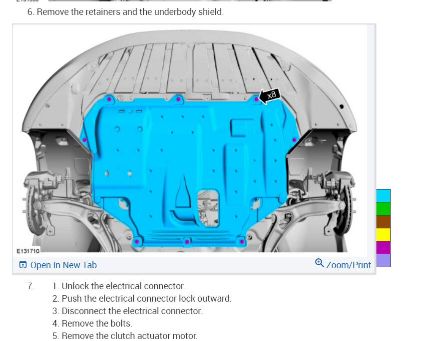

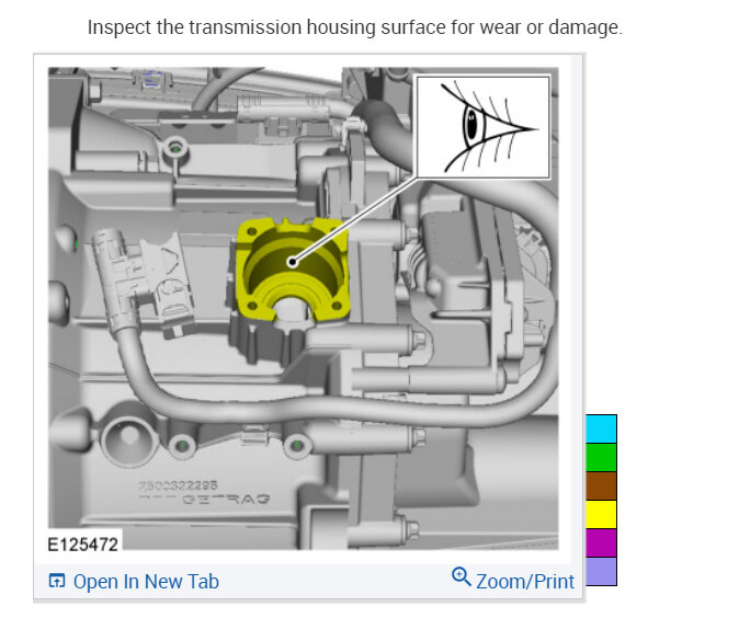

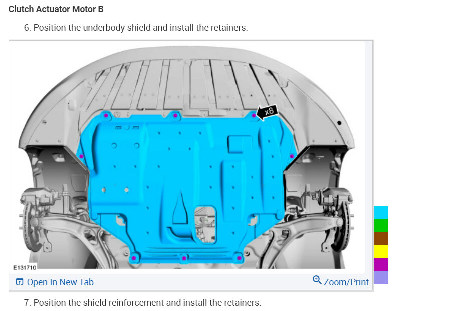

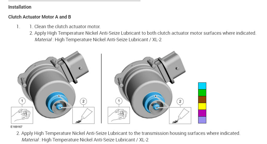

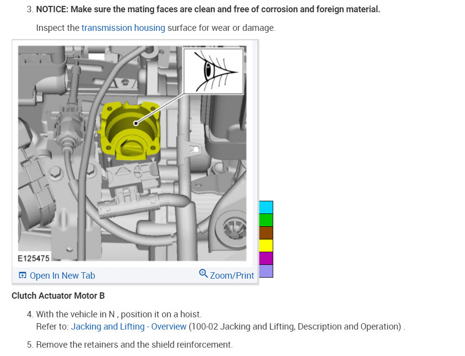

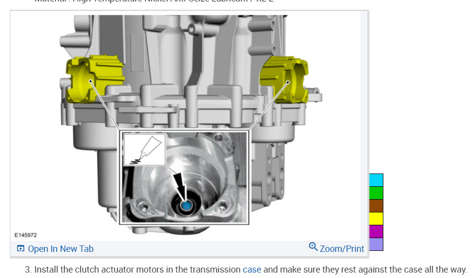

Here is how to change the clutch actuators out, these cars had a big problem with them. Check out the images (below). Please let us know how it goes.

So, my understanding is that it has 2 actuators? One from top the other from bottom. I want to switch the one with the code first to see if it does anything. The code that was left alone is for which one? One on top?
Aug 3, 2023 at 9:39 AM
  • 55,721 POSTS
the "A" actuator is on the top left. let me know what happens.
Aug 4, 2023 at 4:41 AM
BHAMDOC1973
  • 2,007 POSTS
The p0805 is for the one on transmission under the airbox?
Aug 4, 2023 at 4:44 AM
  • 55,721 POSTS
Yes, that's the one.
Aug 5, 2023 at 2:49 AM
BHAMDOC1973
  • 2,007 POSTS
Unreal how this new actuator solved the issue.
