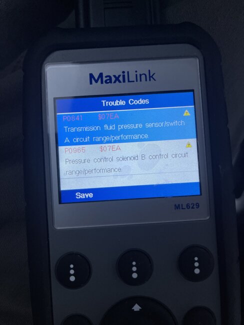

Transmission codes P0184 and code P0965?
2017 CHEVROLET SPARK
100,000 MILES • 4 CYL • 2WD • AUTOMATIC
BHAMDOC1973
  • 2,007 POSTS

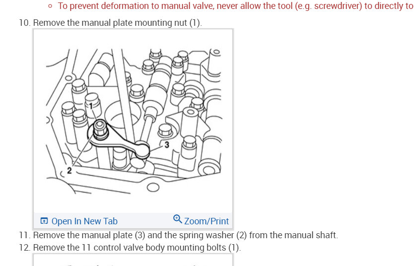

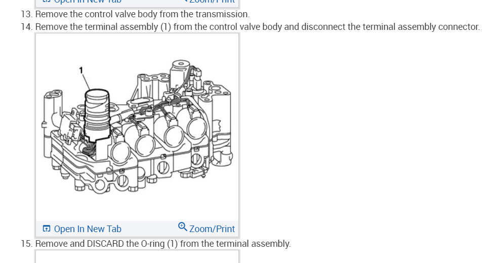

When cold can be driven thirty miles or so then starts to act up, if you on the highway you lose the response from the pedal and every few seconds can push it and RPMs would rise enough for the car to go forward with a jerk. If in the city, you completely lose the gas pedal response, and she won't go anywhere. Turn off and on and quickly put it in gear you can move five feet then same thing. Codes are attached.
Jan 15, 2023 at 8:58 PM

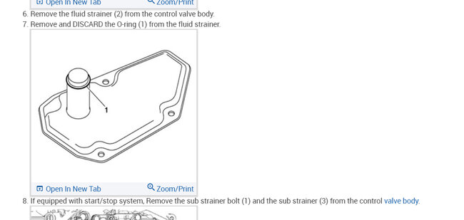

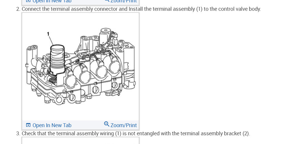

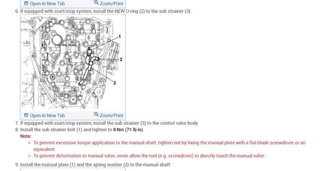

  • 55,399 POSTS

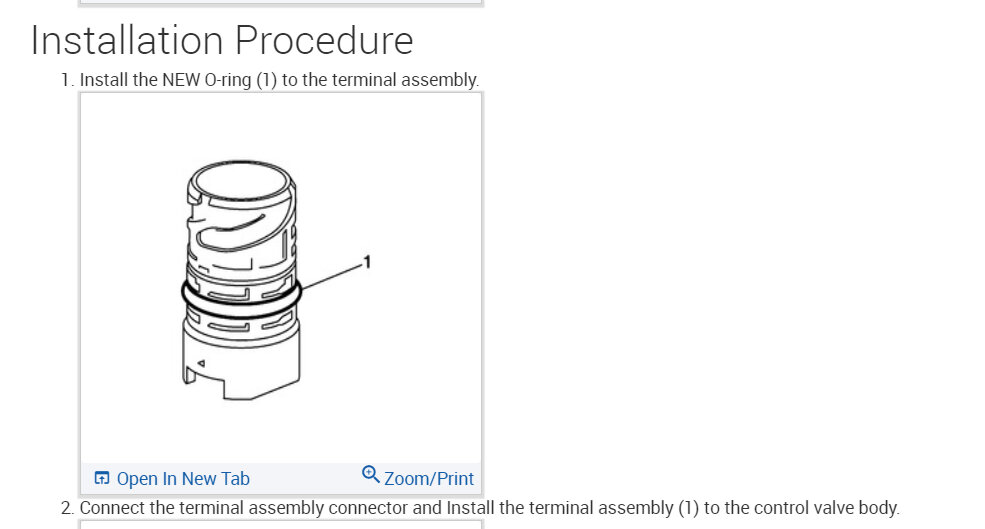

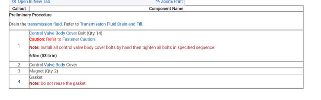

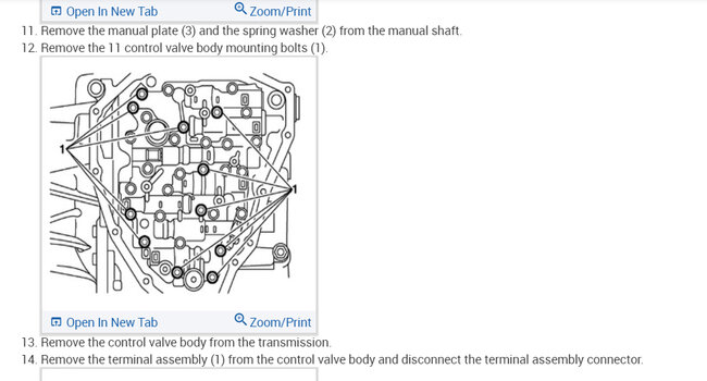

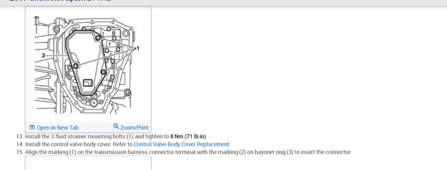

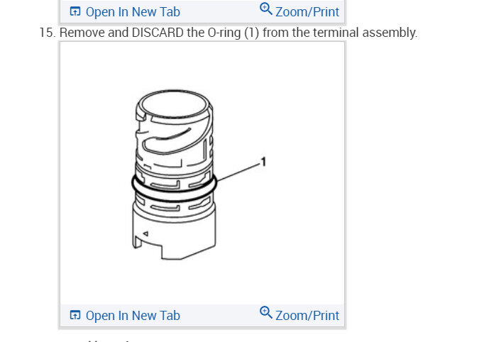

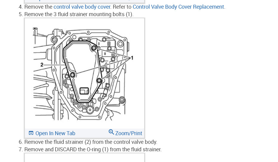

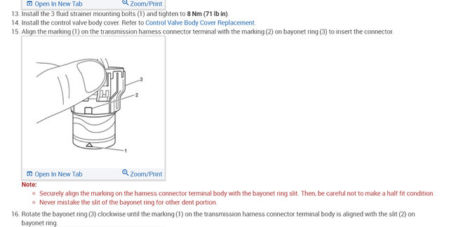

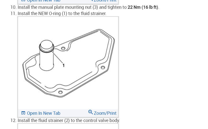

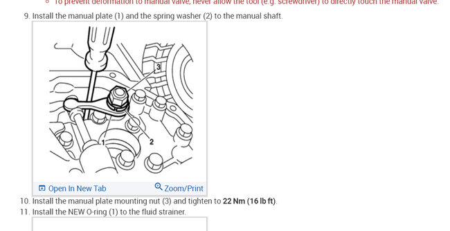

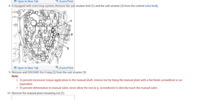

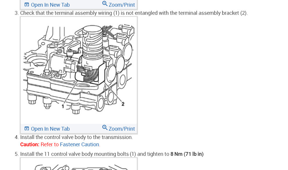

I would do a rebuilt valve body because the pressure switch is internal, that way you get the new shift solenoids as well. Here are instructions to how to change it out in the images below. Check out the images (below). Please let us know what happens.

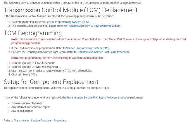

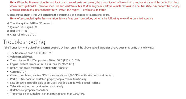

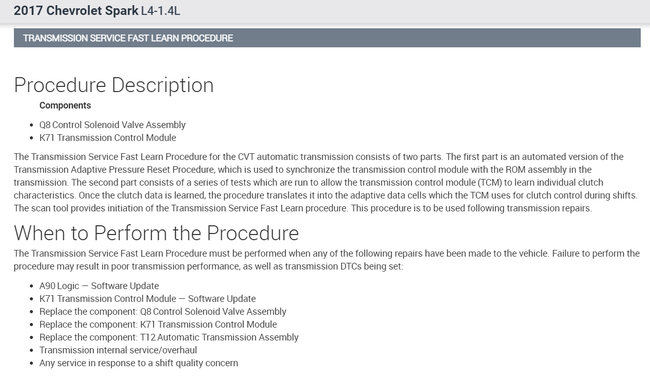

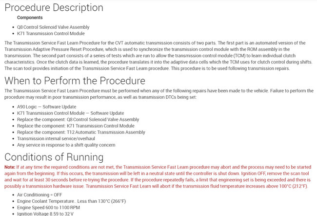

Does it require programming/coding?
Jan 16, 2023 at 7:28 AM

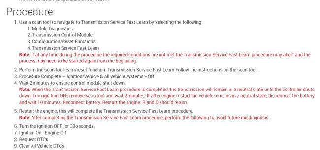

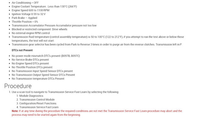

  • 55,399 POSTS

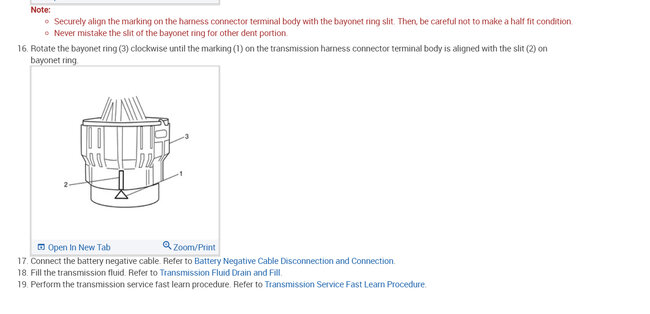

Good question, it does not need to be programmed but it will need a fast learn procedure. Check out the images (below). Please let us know if you need anything else to get the problem fixed.

  • 2,007 POSTS

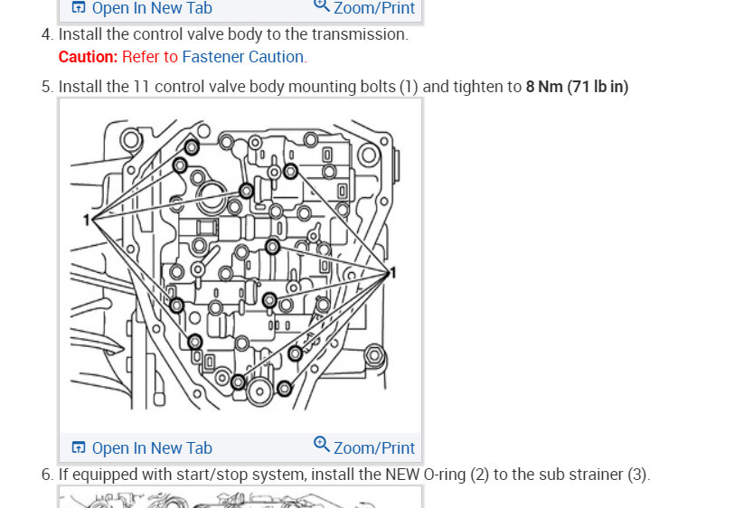

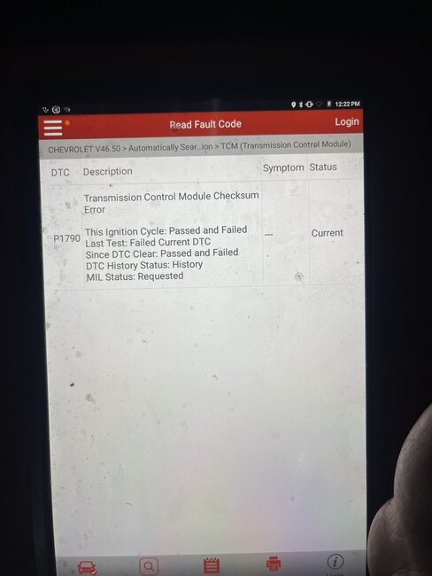

Ugh, installed a need OEM one but when i put it in drive or reverse while car still jacked up jerks so bad. Fluid full, waited until 125F and added at seeped. No codes, but when i did it a few more times i got this. I don't have a way of doing a learn since scanner does not offer it.

  • 2,007 POSTS

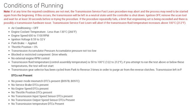

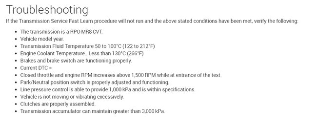

My buddy has a scanner we tried but it kept saying ensure that the scanner is communicating, battery is full charge , etc. all conditions for the learn are met, temperature of fluid, A/C off, parked on leveled ground, etc. strange, it wants to start but says unable to communicate.

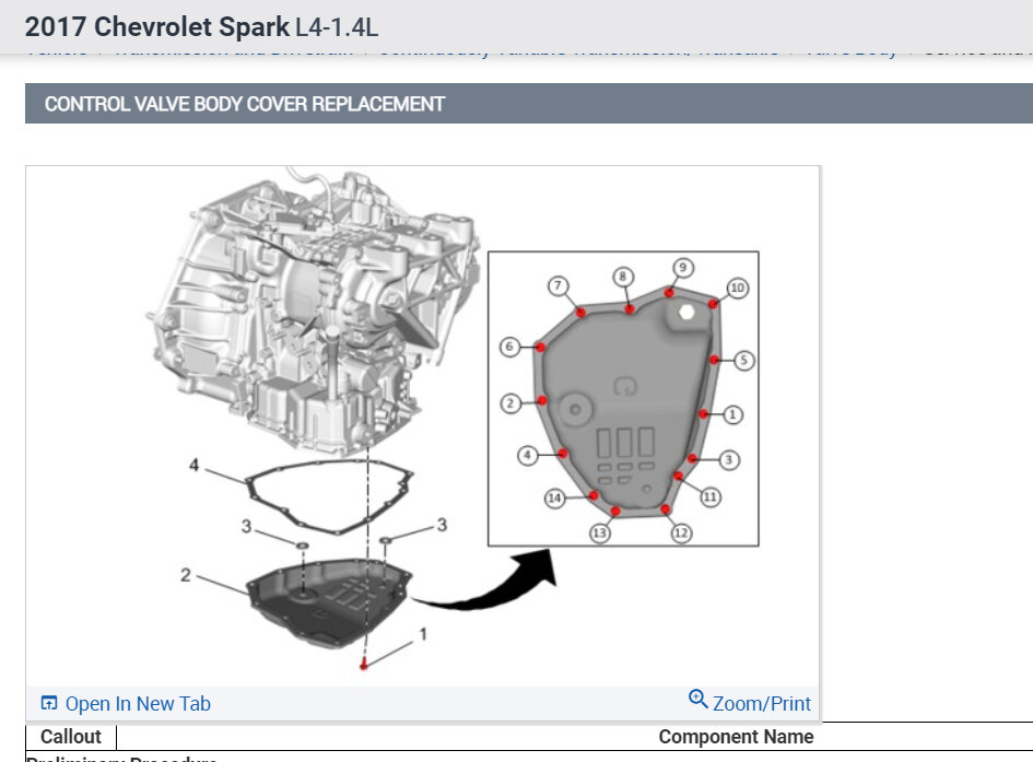

But i have driven it and it does not jerk but I am feeling there is a tiny bit of shudder as in the car moves and back moves forwards and back, same feeling you would see when you see an rpm needle moves very little up and back while at constant speed. When checking fluid level does it have to be cold or hot. I want to check it again by removing the drain plug.

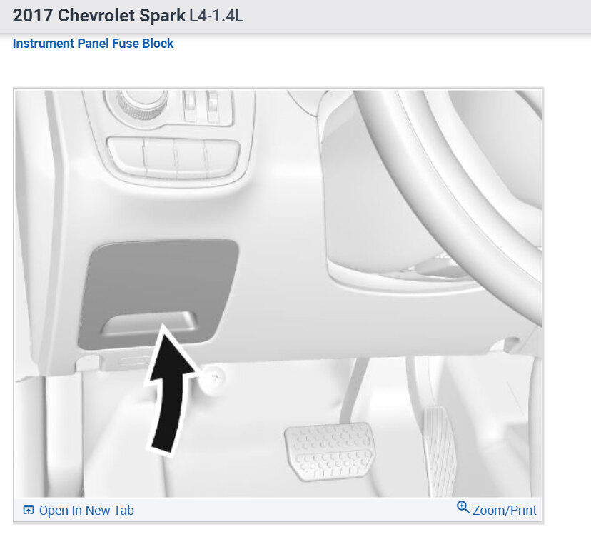

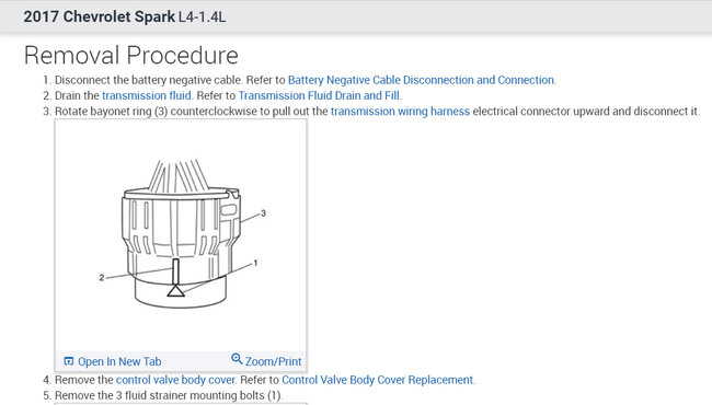

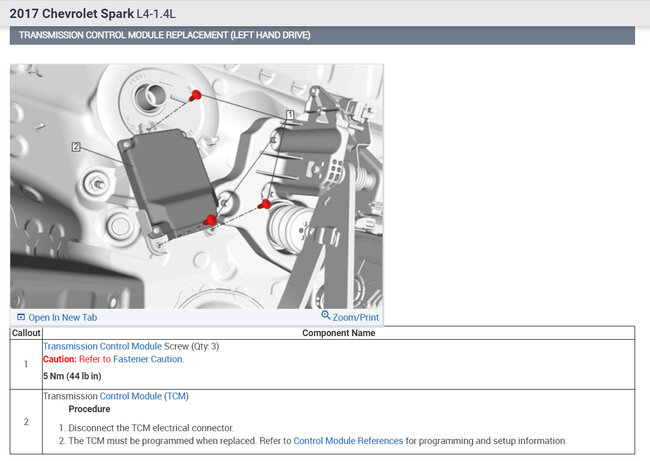

it does have the code of the TCM error have you replaced it? Here is the location and how to replace it in the images below.

  • 2,007 POSTS
Does not have any codes right now.
Feb 5, 2023 at 5:34 AM
  • 55,399 POSTS
Yep, it sounds like the TCM is out.
Feb 6, 2023 at 4:46 AM
BHAMDOC1973
  • 2,007 POSTS
Why would the TCM be out if there are no codes and car runs and drives?
Feb 6, 2023 at 4:47 AM

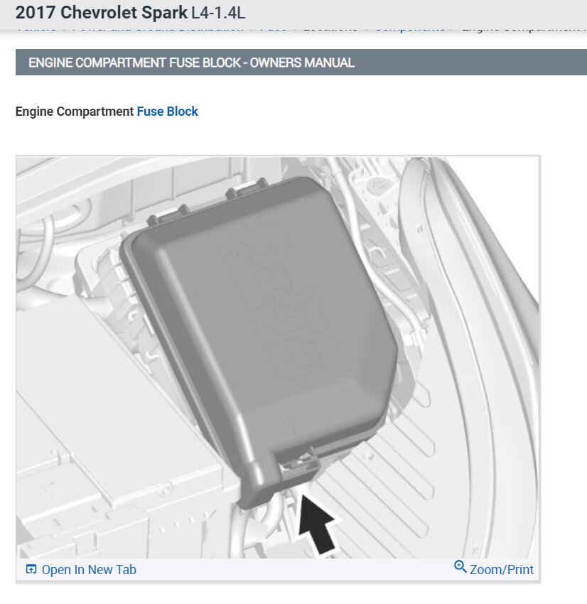

  • 55,399 POSTS

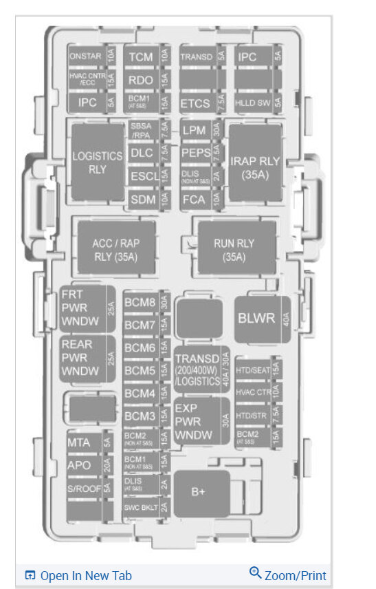

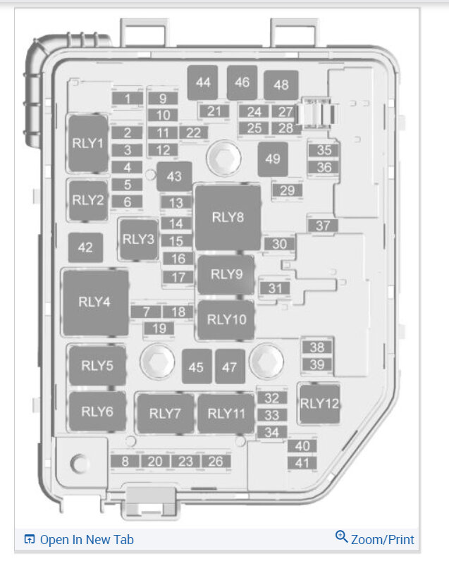

Yep, it is possible. let's check the fuse #2 in the interior fuse panel and fuse# 14 and 6 in the under-hood fuse panel, also there is a TCM control relay (RLY2) I would try to swap out as well in the same fuse panel. Is all is okay or doesn't seem to do anything and the fact that it is unable to communicate, and all fuses and grounds are okay is telling the TCM is bad.
