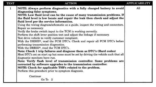

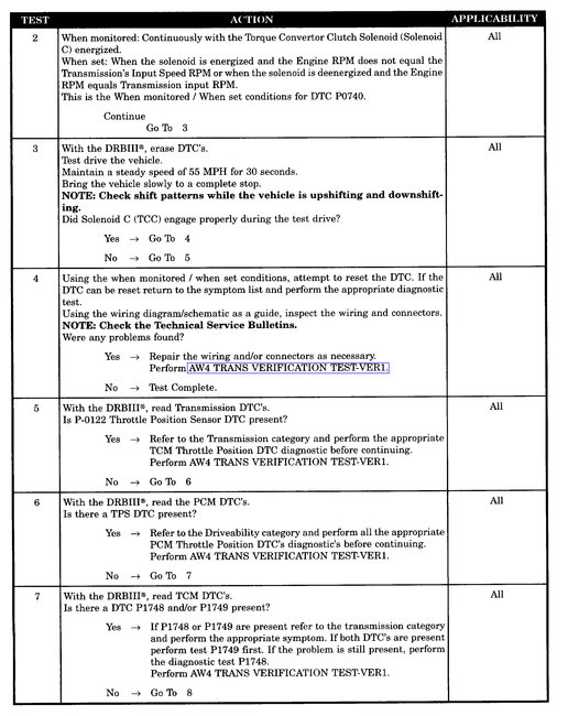

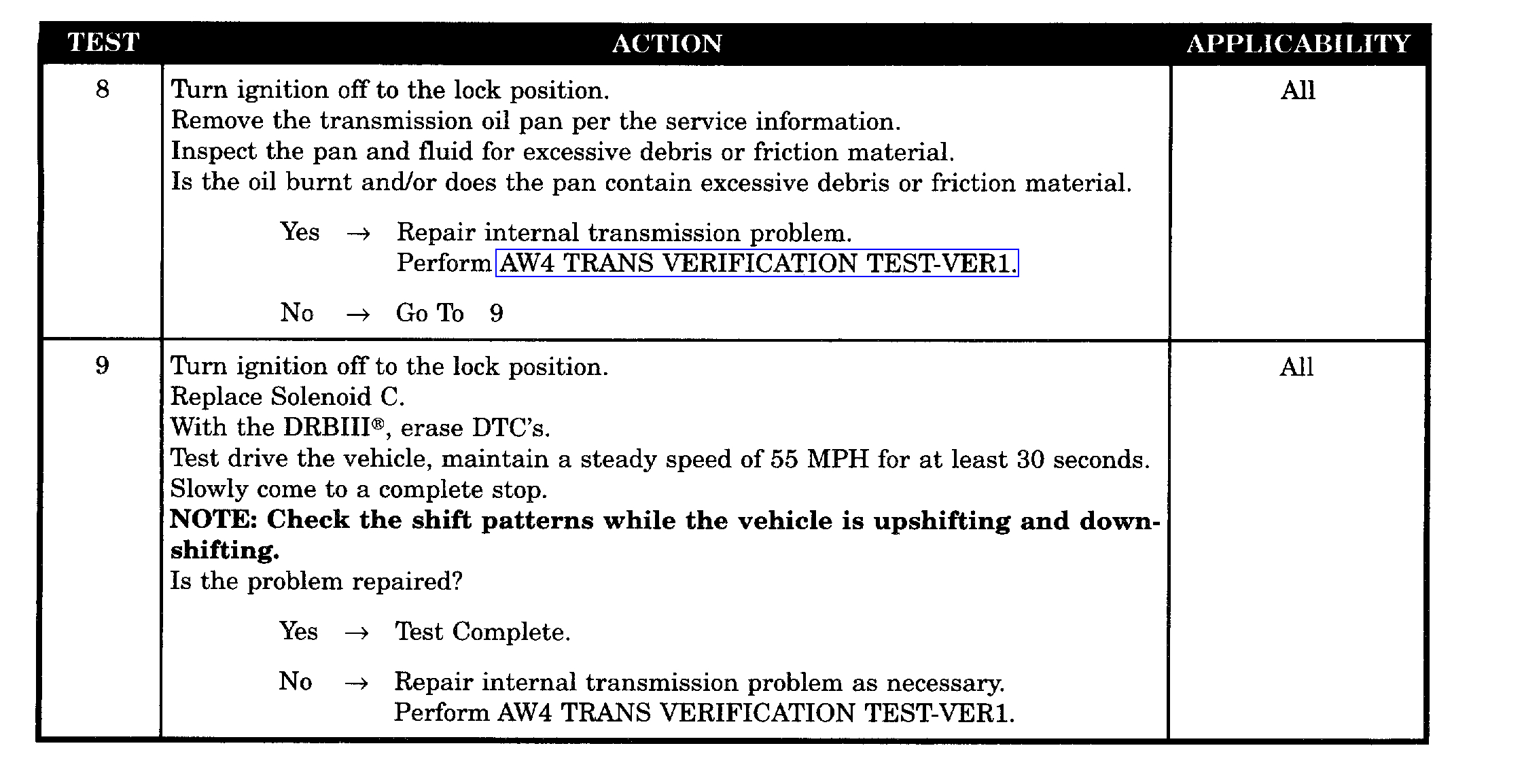

I'm not sure what you are comfortable with. However, here are the diagnostics. Keep in mind, it could be solenoid C in the transmission which is replaceable.
_______________________
Here are the diagnostics, The attached pics are the actual directions.
2001 Jeep Truck Cherokee 2WD LHD L6-4.0L VIN S
Transmission Code
Vehicle ALL Diagnostic Trouble Codes ( DTC ) Testing and Inspection P Code Charts P0740 Transmission Code
TRANSMISSION CODE
pic 1
pic 2
pic 3
P0740 - SOLENOID C FUNCTIONAL FAULT
When Monitored and Set Condition:
When Monitored: Continuously with Solenoid C (TCC) energized.
Set Condition: When the solenoid is energized and the Engine RPM does not equal the Transmission's Input Speed RPM or when the solenoid is de-energized and the Engine RPM equals Transmission input RPM.

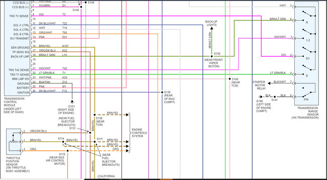

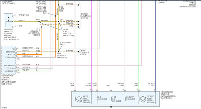

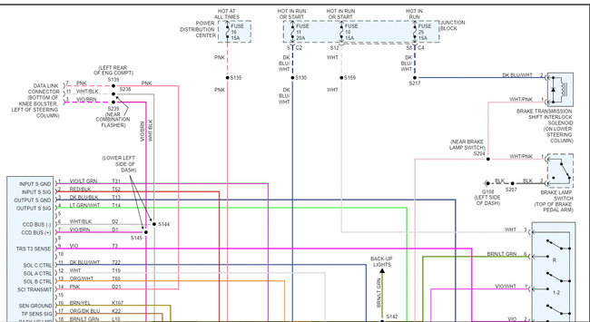

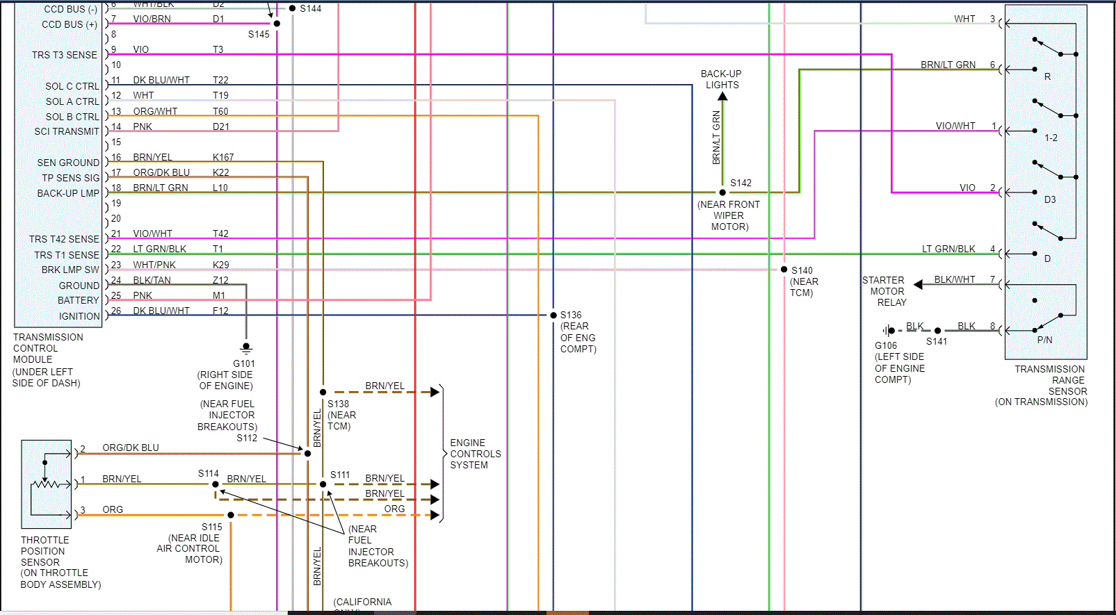

Awesome, thank you for that.Since the Lucas oil has kept the transmission from stalling the engine should I change the fluid? I feel like the Lucas oil is a bandage that’s going to keep me from getting to the root cause. What do you think? Also, where can I download or purchase the proper wiring diagram for my vehicle?
Jun 8, 2020 at 7:59 AM
  • 110,194 POSTS
Honestly, if the fluid is still clean, I would likely leave it alone. As far as a wiring schematic, I attached three pics below that are for the transmission circuits. I had to break it into three pics to make them readable, but I did overlap so you could follow them.
Let me know if that is what you needed.
