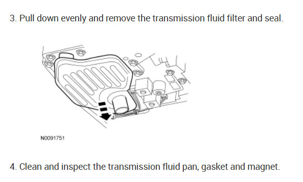

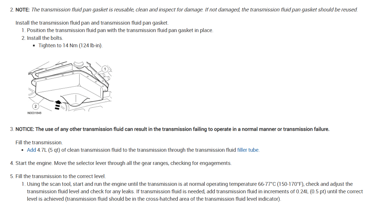

I purchased an RV and made one trip with no issues, but I have noticed while driving with no RV attached the transmission cluster gauge is staying on the far left and not getting to the center where it usually stays until quite a while as I am driving. I want to get this checked before I take the RV again. I read online where this model has the dip stick under the car passenger side. Should I remove the plug to verify the transmission level first before I change the filter? I used the tow/go with the camper and it pulled the hills really good with it engaged. I somehow think that the towing has brought the issue about. Your thoughts? Thanks
Oct 31, 2024 at 11:47 AM
  • 54,832 POSTS

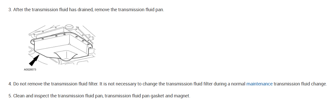

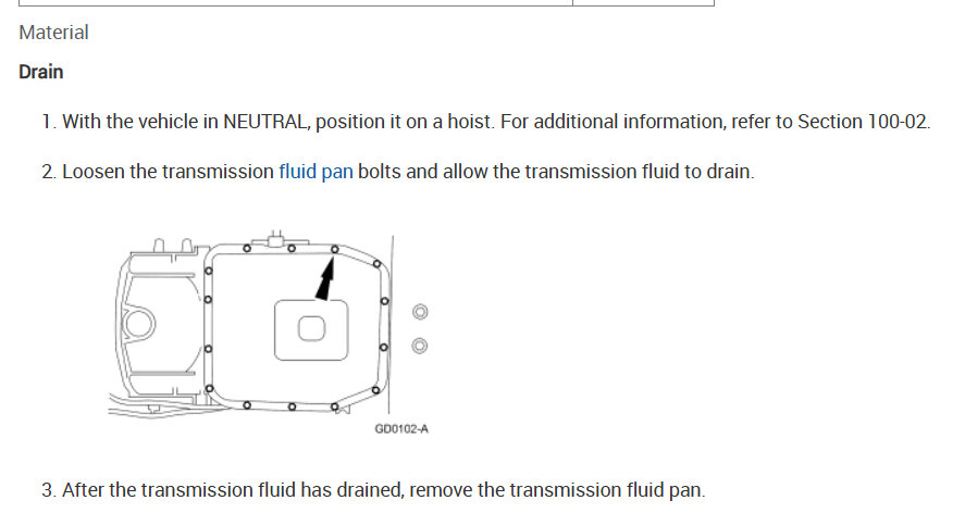

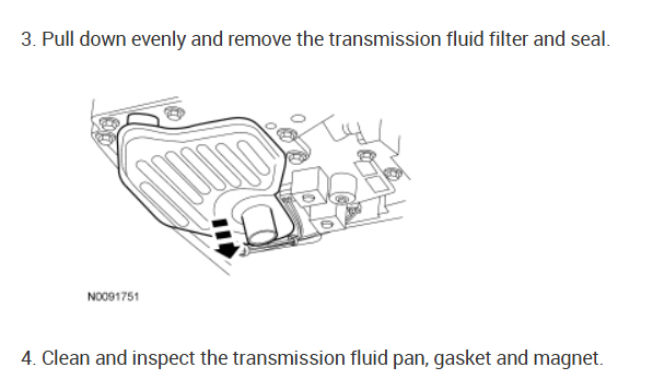

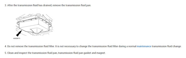

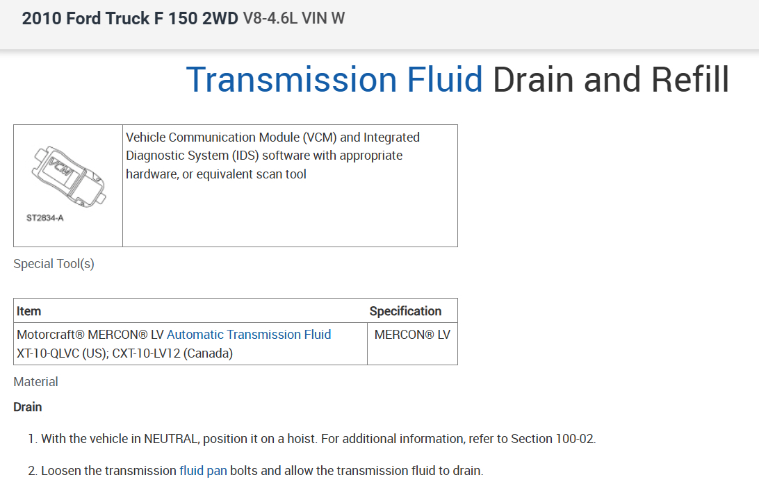

Yes, it is a good idea to check the fluid level and condition. This guide can show you how and I have included instructions for more information for your truck in the images below.
https://www.2carpros.com/articles/how-to-check-and-add-transmission-fluid
It sounds like you may have a clogged catalytic converter, or the input shaft speed sensor can be going out, I would run the codes to see if any are stored.

No codes at all. I just noticed last week that it was taking longer for the gage to move to normal position. I wanted to get this checked before I take the RV our again. The truck pulls the 31-foot travel trailer really good. I have a tow button I engage when towing.
Oct 31, 2024 at 7:55 PM
  • 54,832 POSTS
Sounds good, I have seen the input shaft sensor get weak and cause shifting irregularities FYI. Let me know how the fluid condition is.
