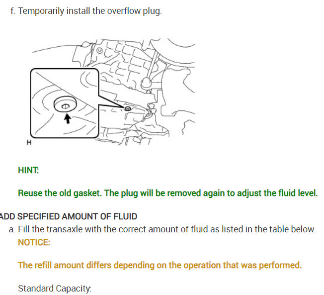

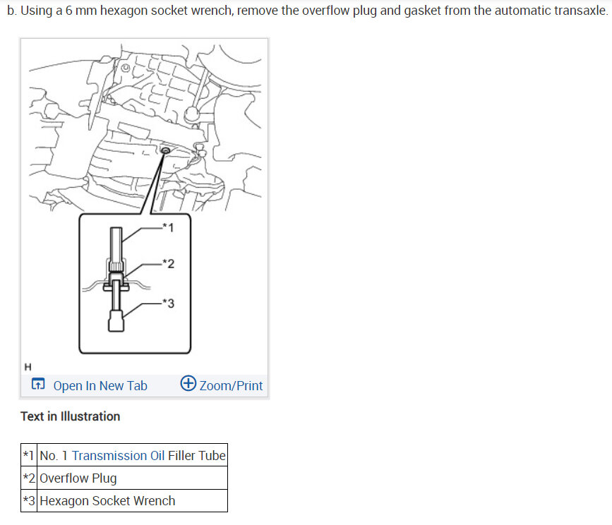

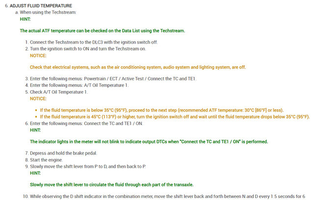

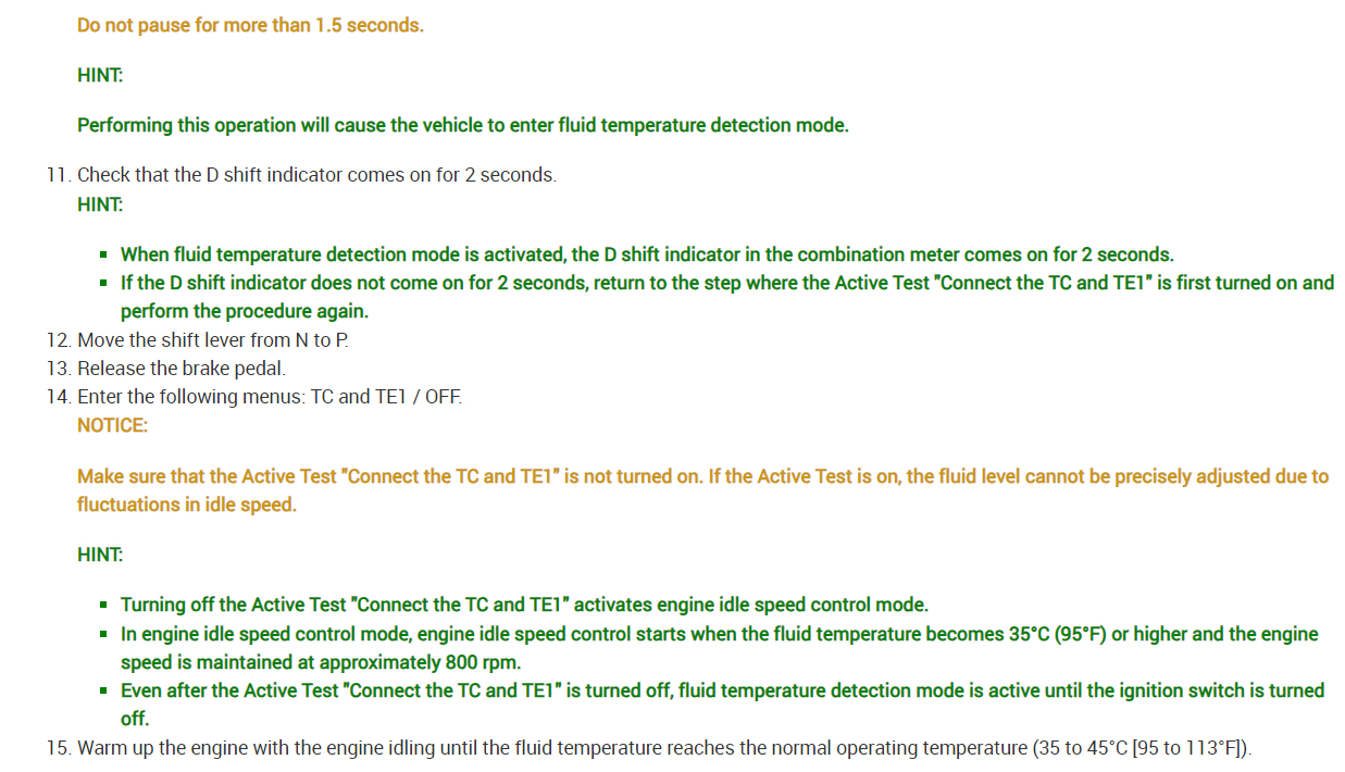

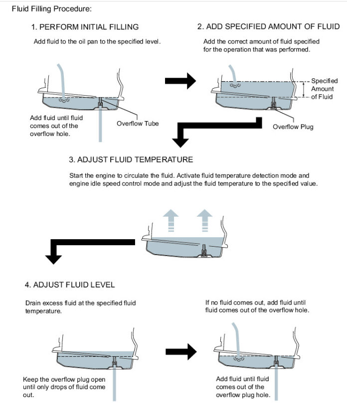

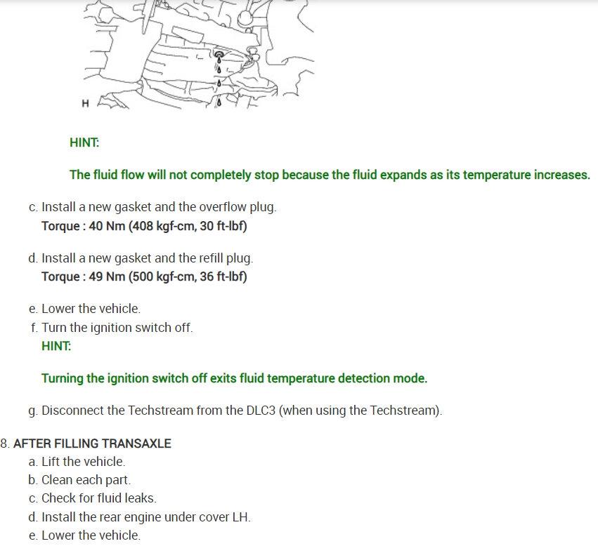

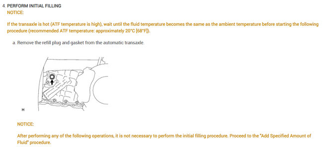

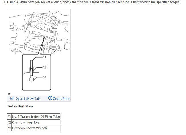

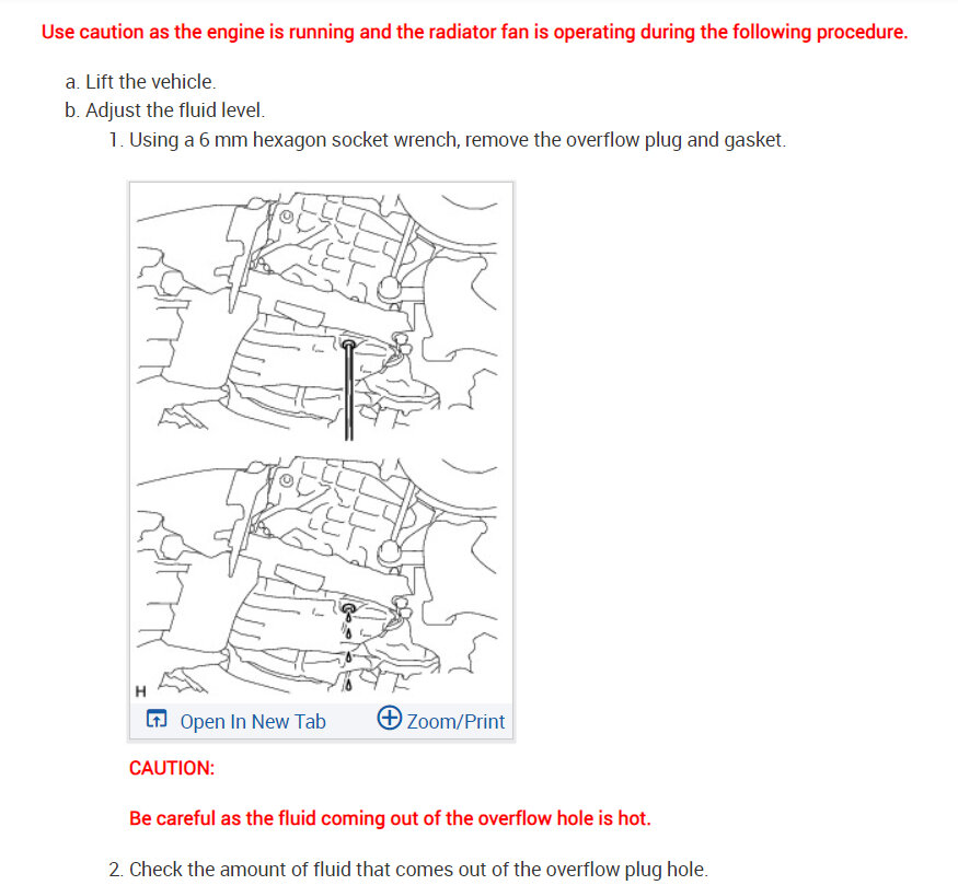

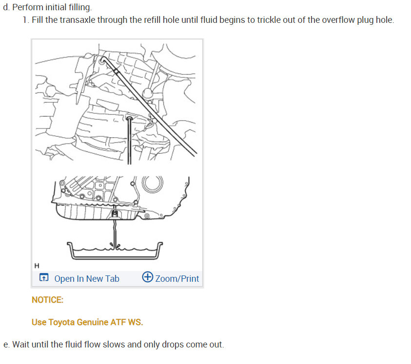

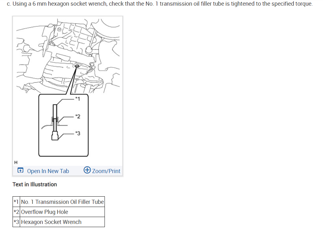

I'm told this is not a DIY job because you need special tools. This opinion comes from a Toyota dealer. And then I found out on YouTube they say it is not necessary. Although a pain in the neck, it can be done. What's your advice?
Aug 16, 2024 at 9:51 AM
  • 55,433 POSTS

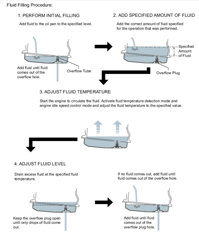

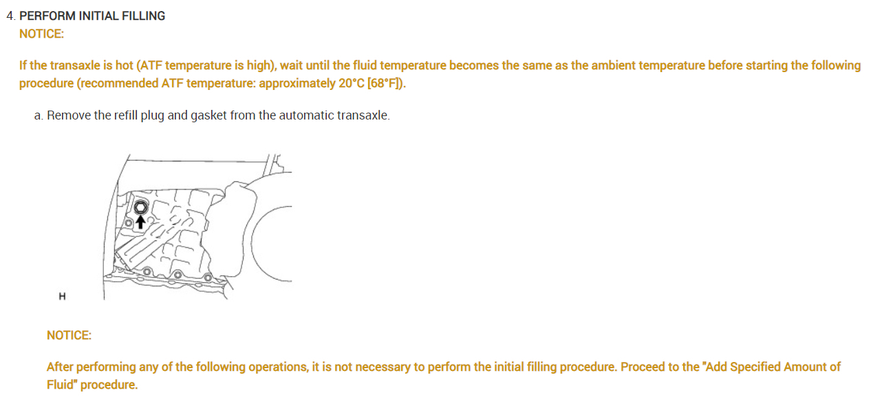

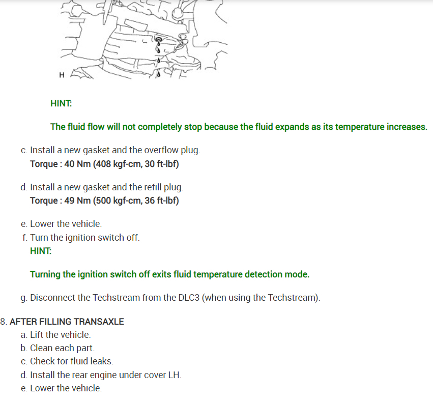

Yep, you can change the oil in the transmission though it is a little more difficult than a traditional car with a dipstick. Please go over this guide so you can see what I am talking about, and I have included instructions for your car in the images below.
https://www.2carpros.com/articles/how-to-check-and-add-transmission-fluid
Dry fill 6.5 liters (6.9 US qts, 5.7 Imp. qts) Toyota Genuine ATF WS
