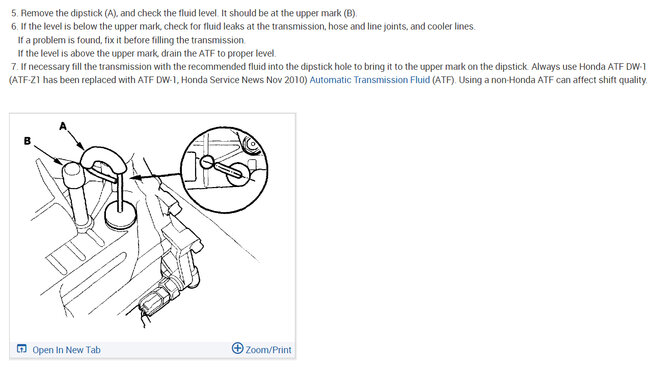

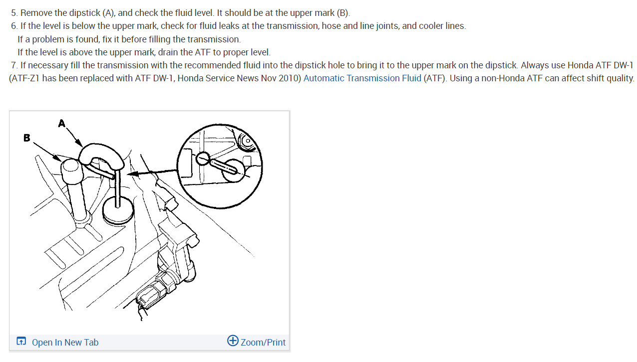

I changed my transmission fluid, but I forgot to change my transmission filter. can I change my filter without all of my transmission fluid leaking out?
Feb 10, 2024 at 2:32 PM
  • 55,433 POSTS

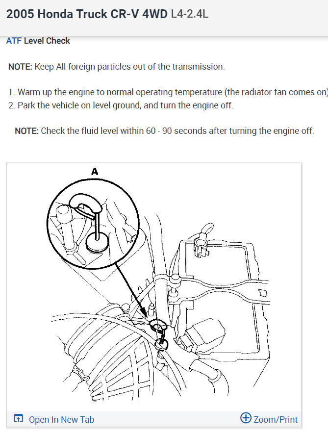

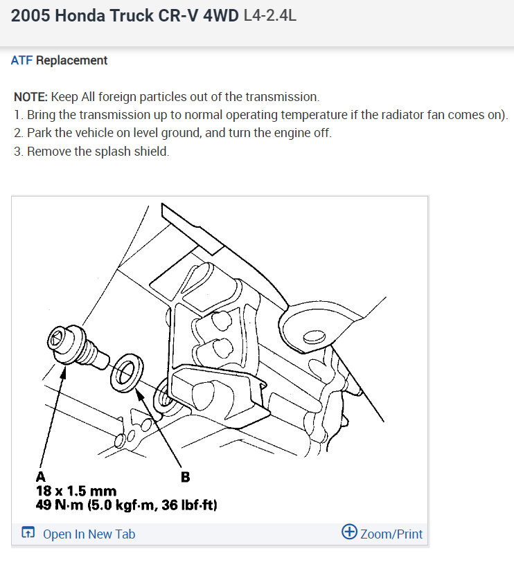

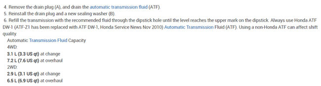

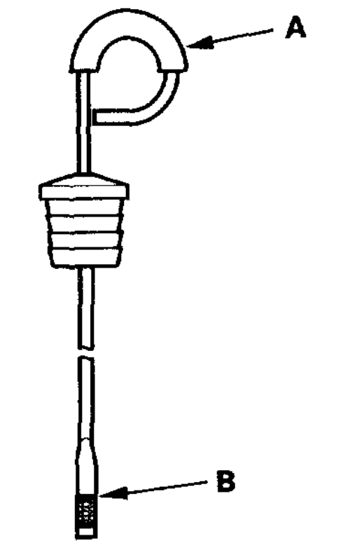

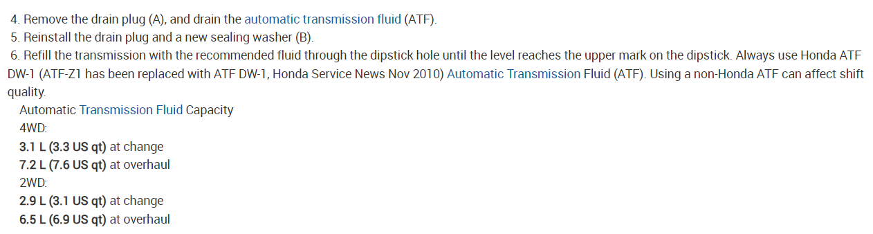

The transmission filter is not serviceable on this model.
Here is a guide that can help:
This guide shows a service on the transmission which the filter is not serviceable. Here are the instructions for changing the fluid out. Check out the images (below). Please let us know what happens.
