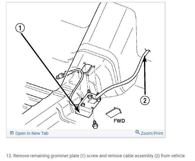

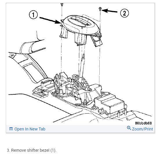

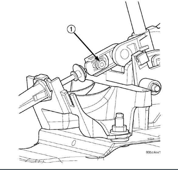

The place where the cable attached to the shifter has broken off?
2006 CHRYSLER PT CRUISER
192,000 MILES • 2.4L • 4 CYL • 2WD • AUTOMATIC
SEAN WATTS

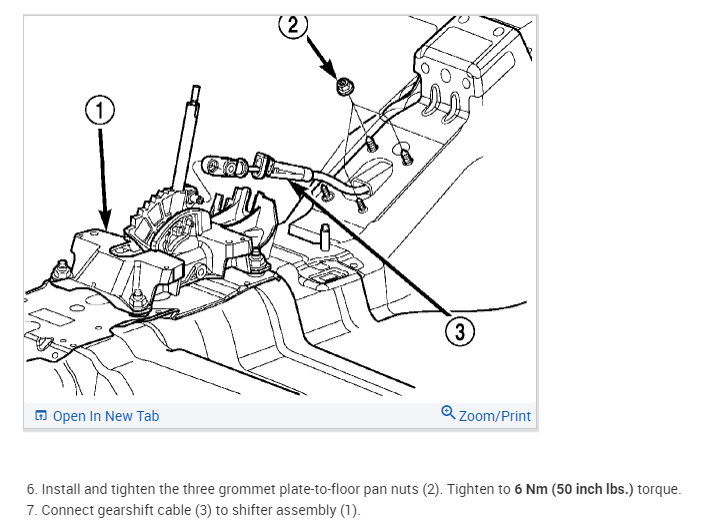

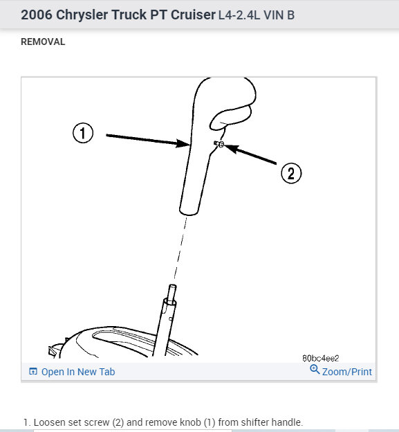

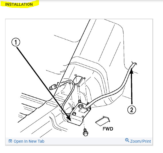

However, the transmission cable does not move no matter how hard i try. It started getting really hard to shift then i forced it and it broke. So, I have to replace the shifter assembly, but should I also replace the cable and is it supposed be easy to move even by hand!
Jul 20, 2023 at 2:05 AM
  • 110,244 POSTS

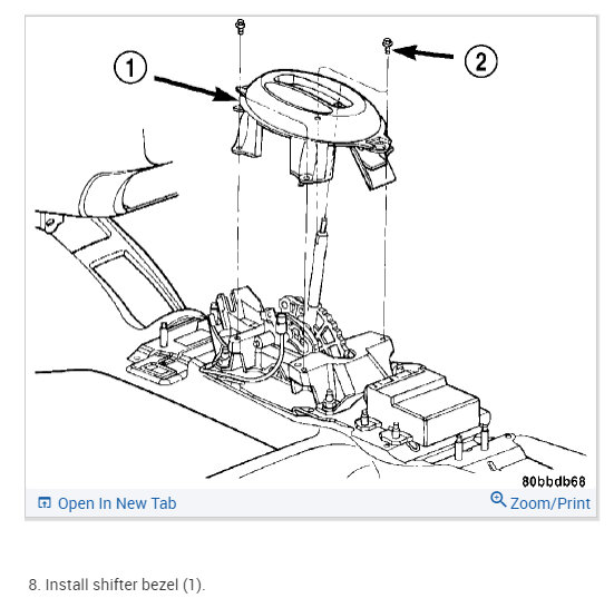

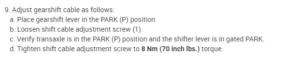

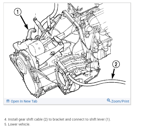

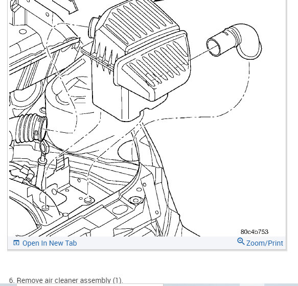

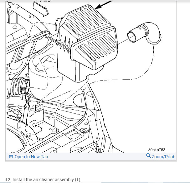

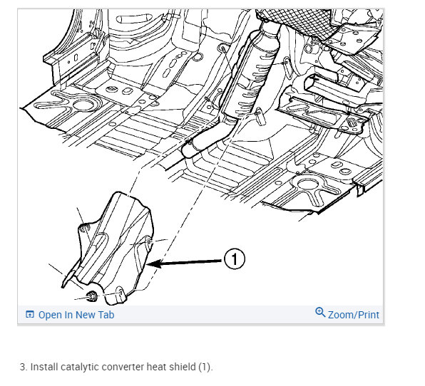

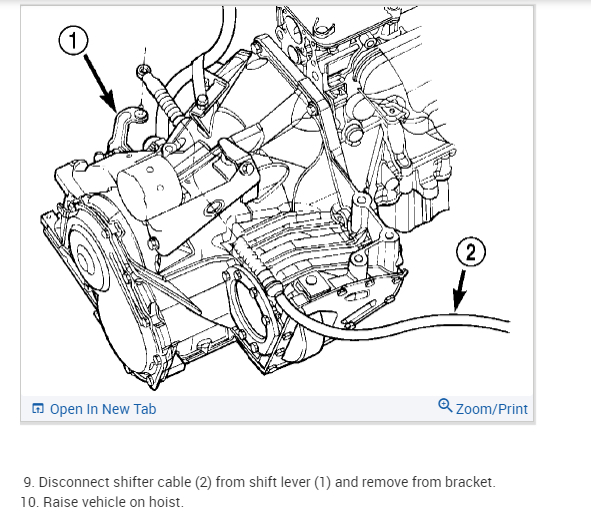

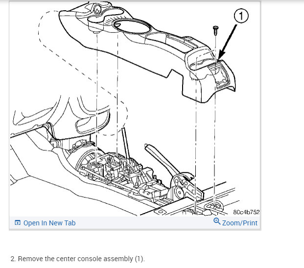

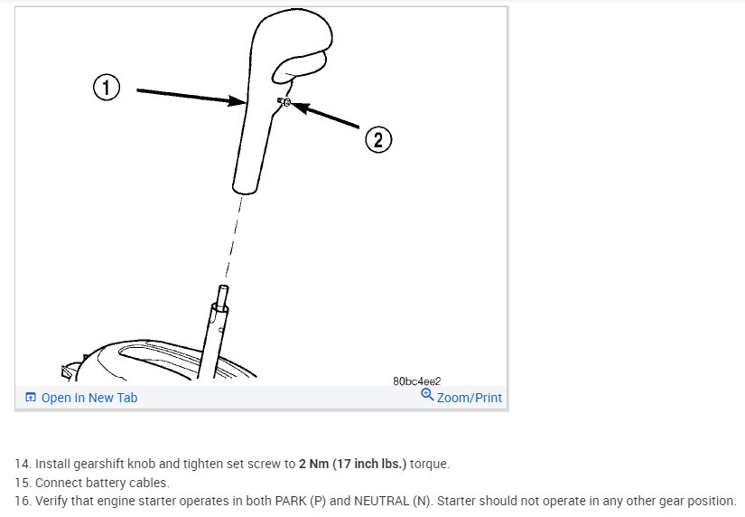

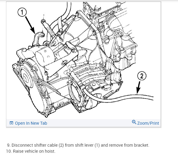

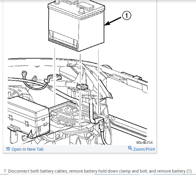

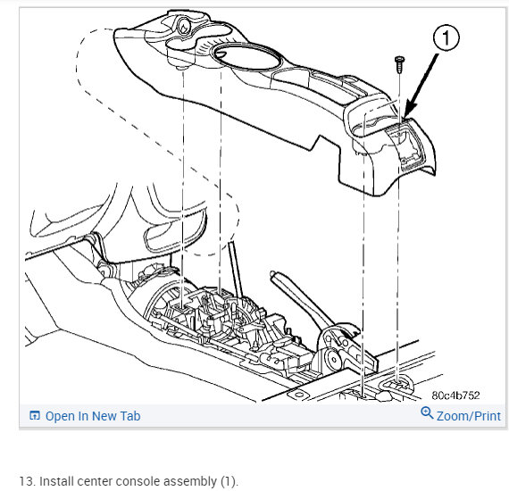

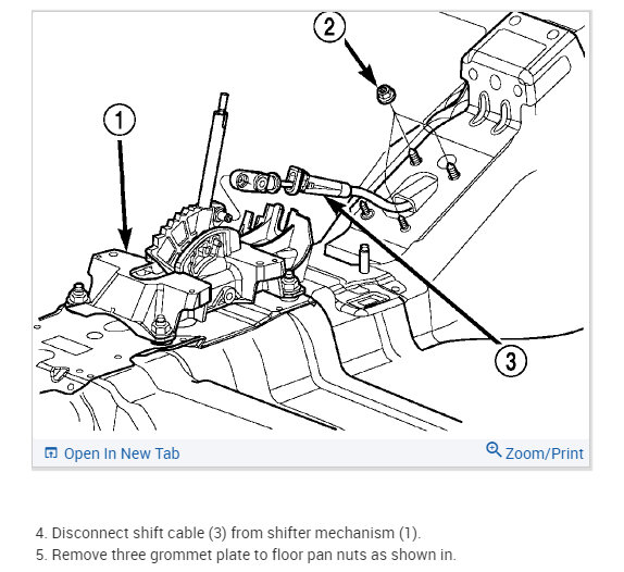

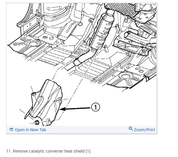

It should be somewhat easy to move by hand, but there will be some resistance. If you disconnect the cable at the transmission and there is still a lot of resistance, then it is bad and needs to be replaced.

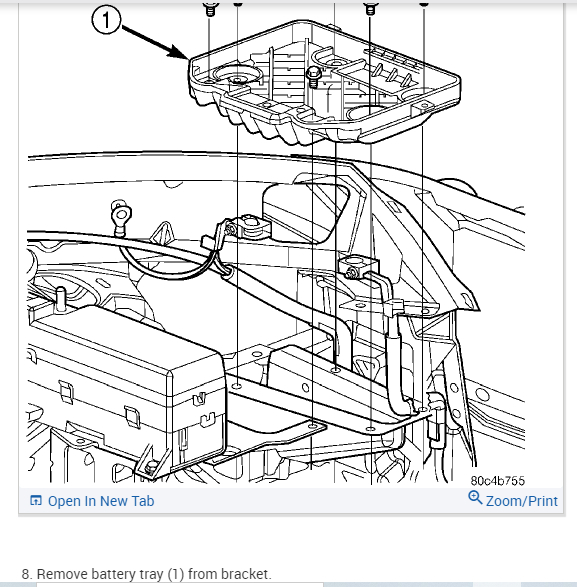

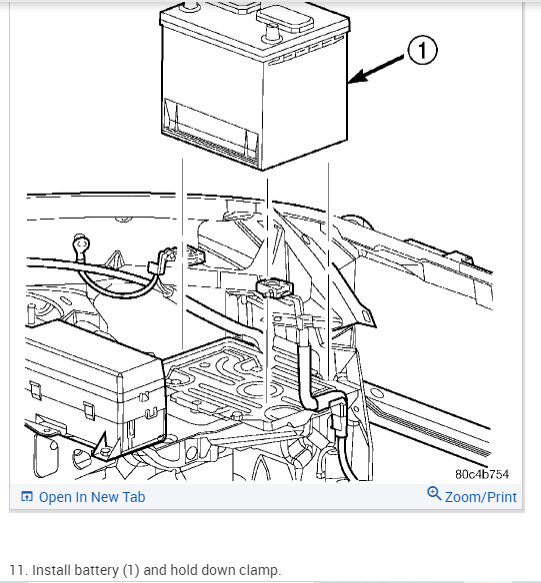

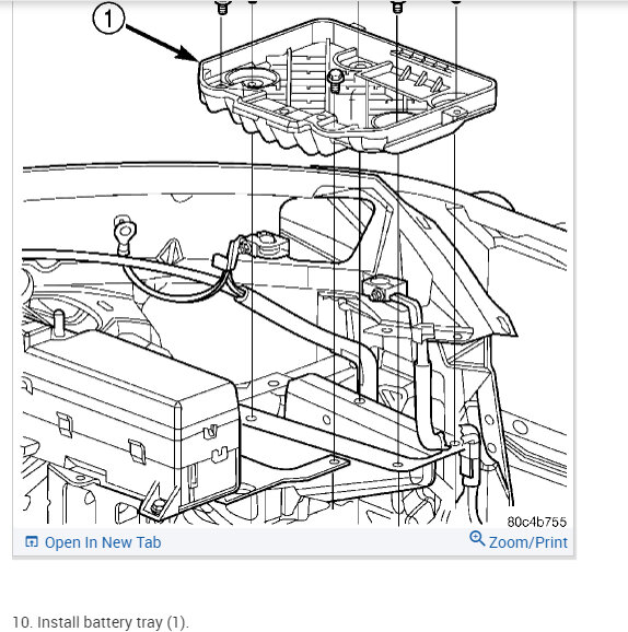

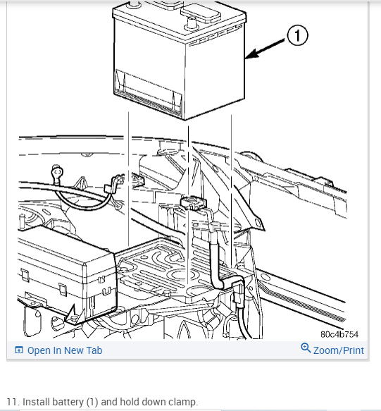

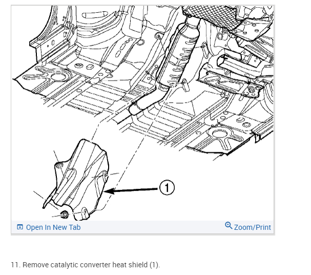

If needed, I attached the directions below for replacing the shift cable for this vehicle. Take a look through them and let me know if you have questions.
Jul 20, 2023 at 1:20 PM
