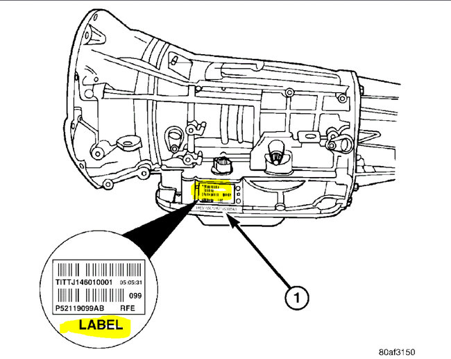

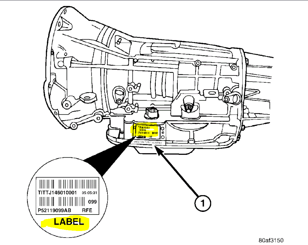

Let's start this way. I attached a pic below of the transmission I'm referring to. Locate the identification tag on your transmission (driver's side) and let me know if it matches what I attached.

Here is the top number on the trans label: TITTJ308511161
The 3 digit number next to the 2nd bar code on the far right is: 452
The bottom number is: P52119452AD RFE

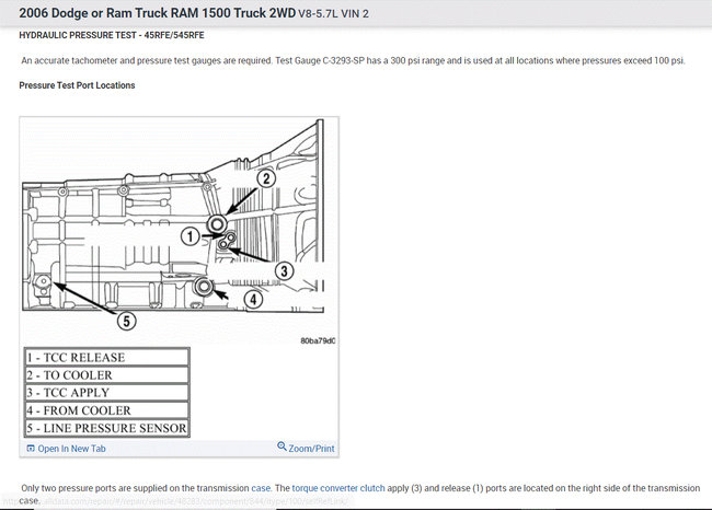

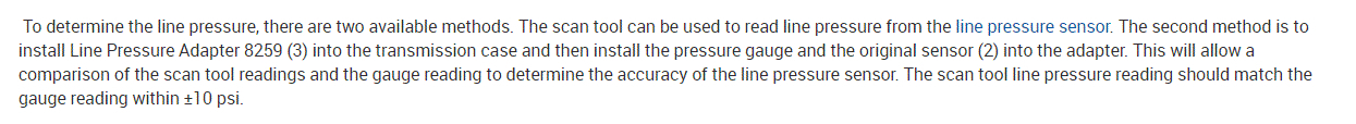

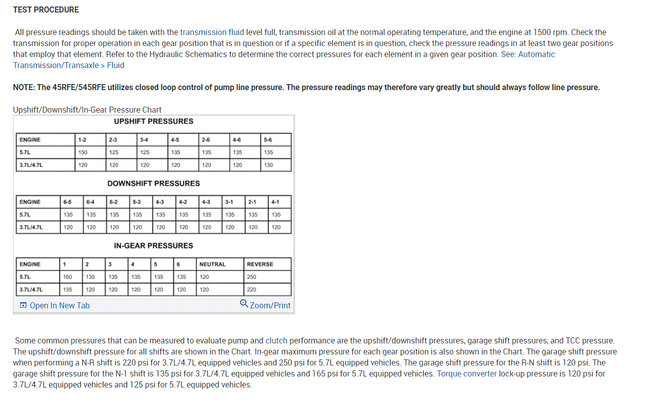

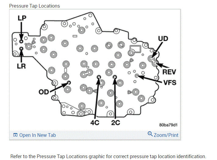

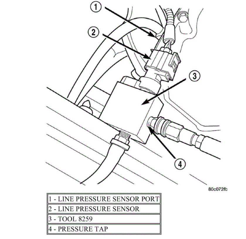

This doesn't appear to have the variable line pressure sensor. We have two ways to go at this point. First, you can have the CAN bus system scanned to see if there are any codes related to the transmission. CAN stands for controller area network. Basically, all computers/modules are tied together via a few wires.
Here is a video showing how it's done:
https://youtu.be/InIlnsjOVFA

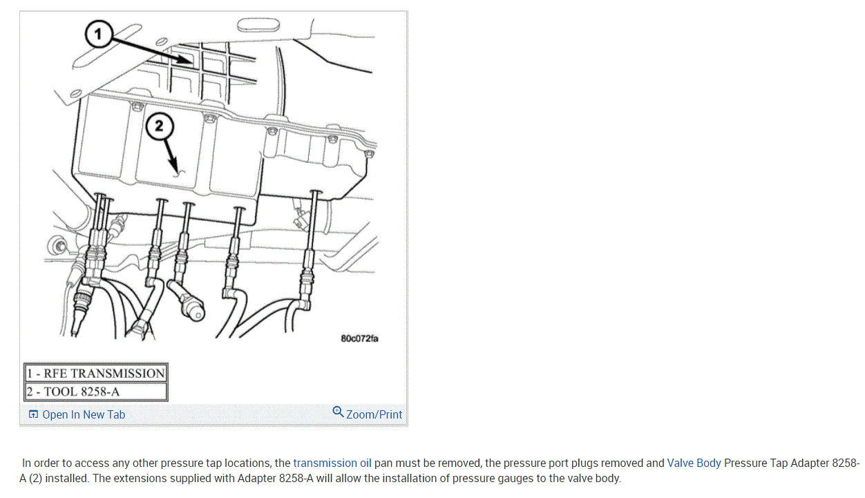

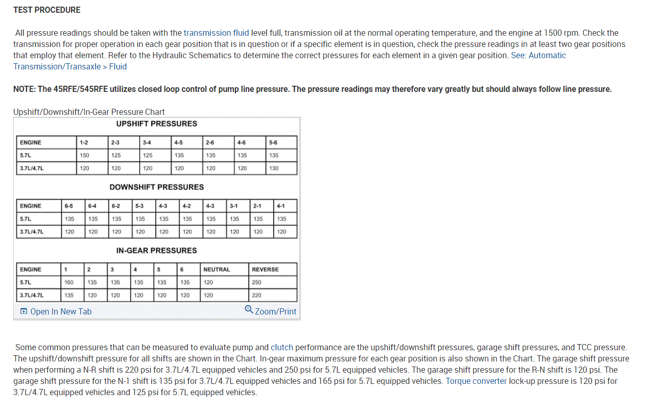

Or, we can check transmission line pressure to see if it is low. If you look at the attachments below, they provide the directions and specifications for testing the pressure. Take a look through them to see if you are comfortable doing this.
