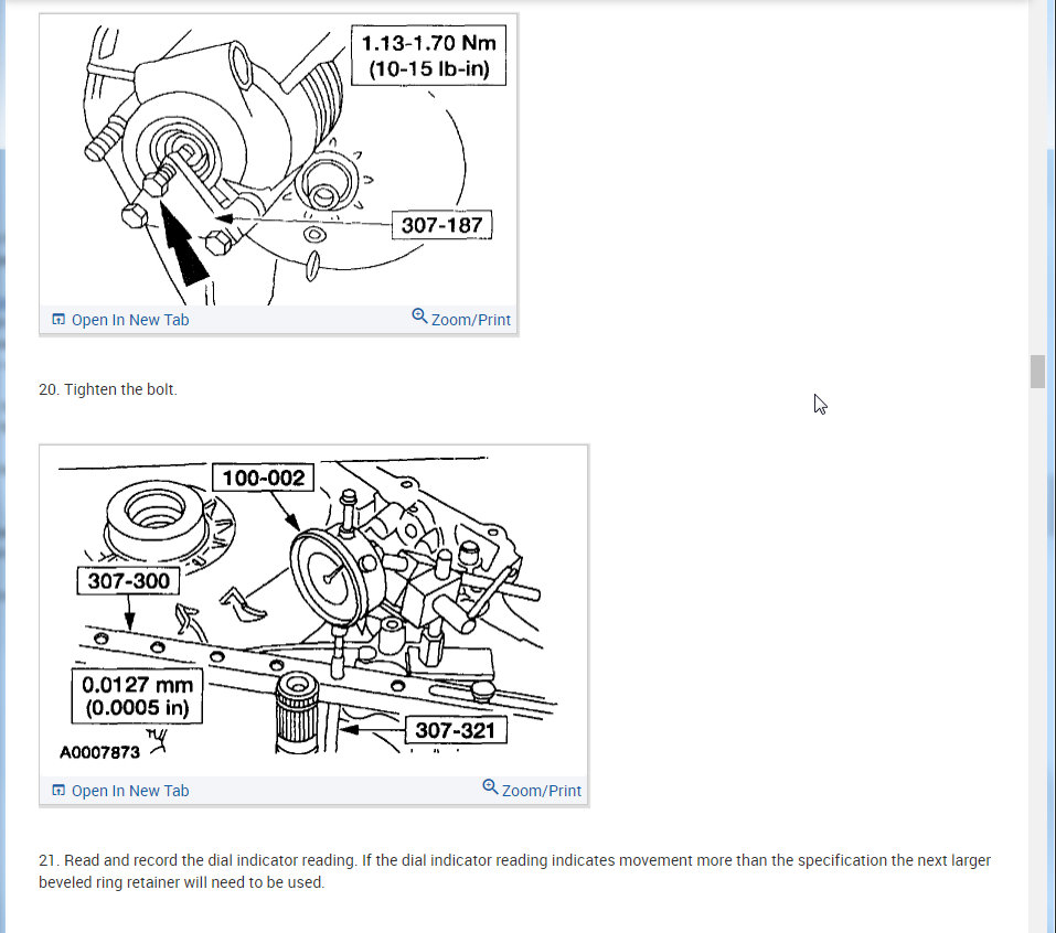

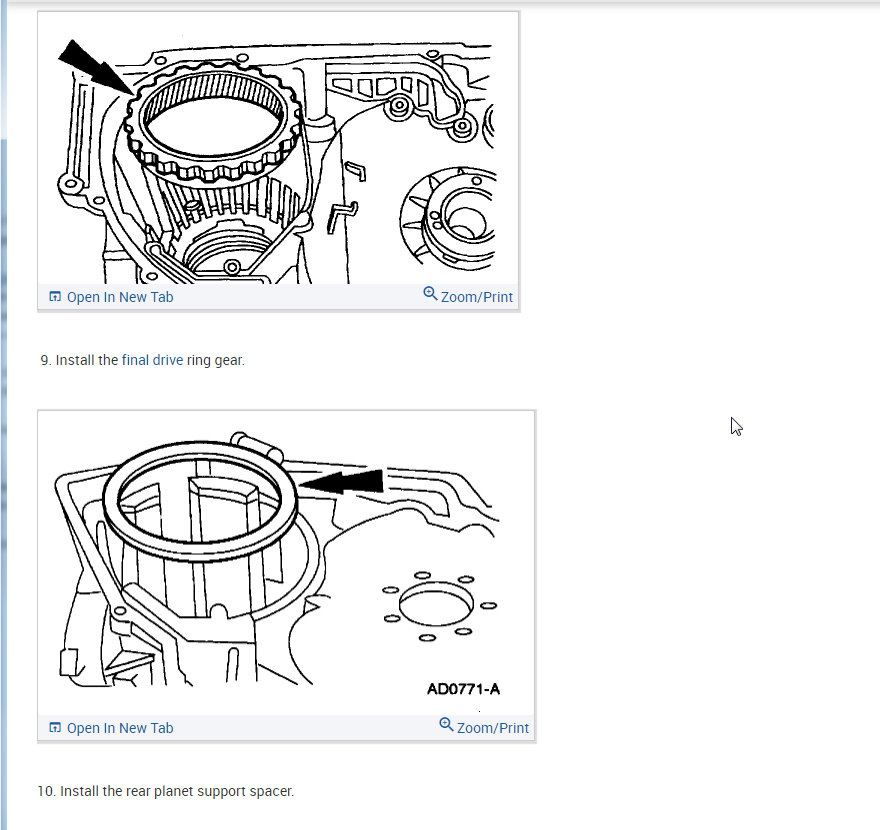

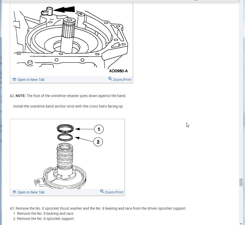

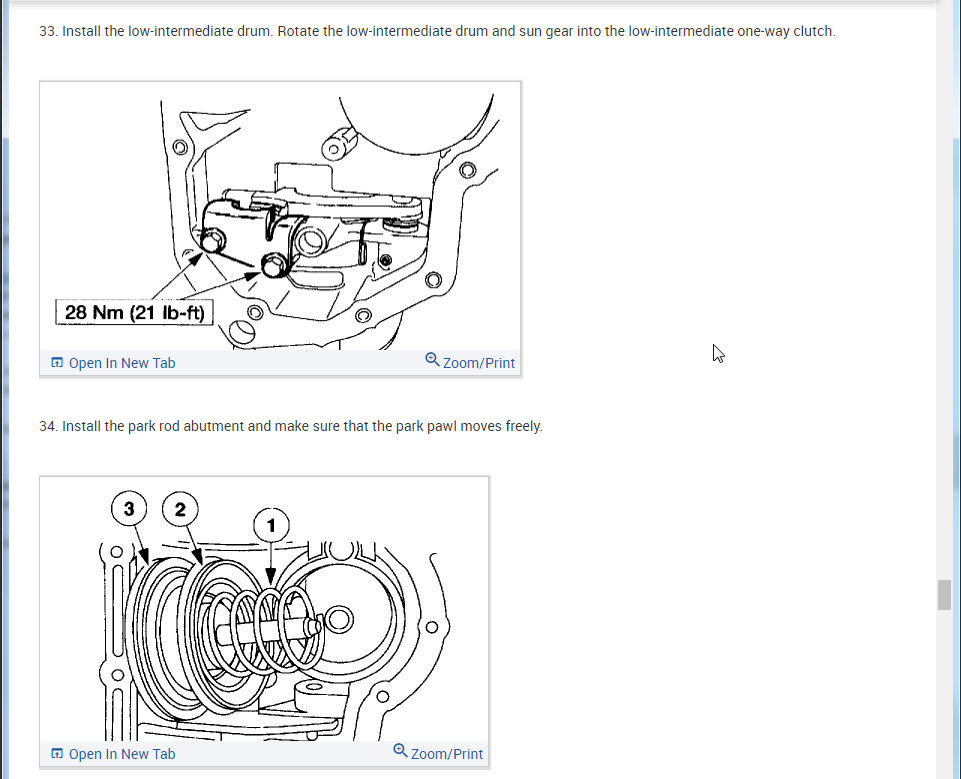

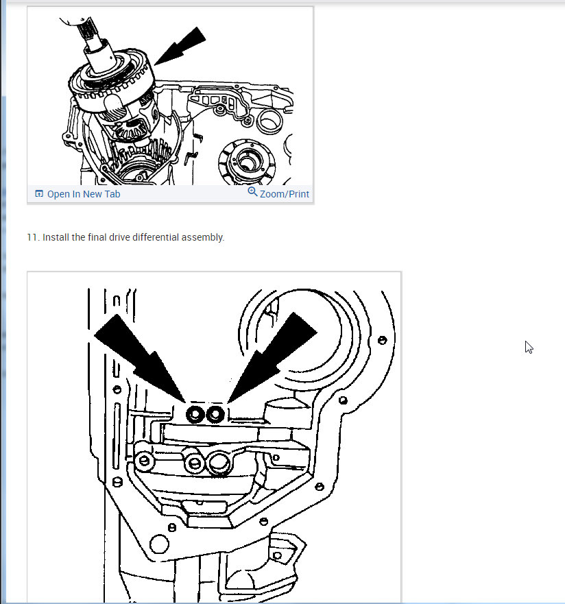

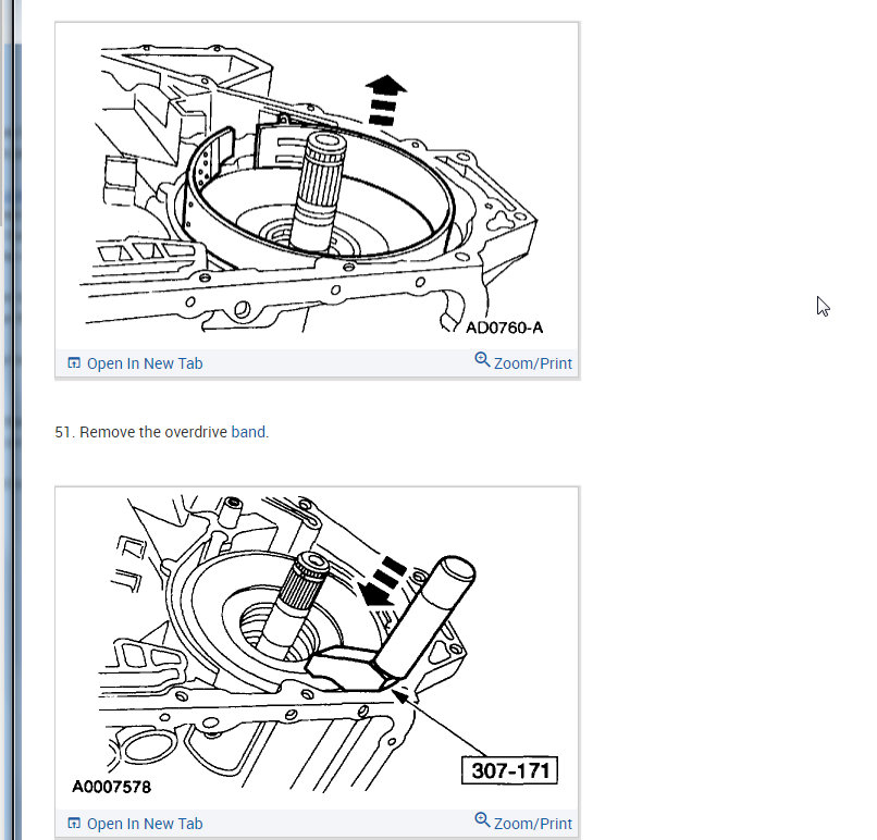

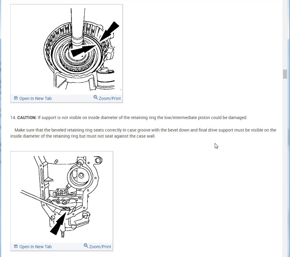

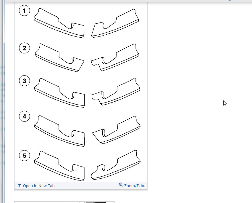

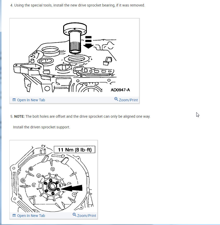

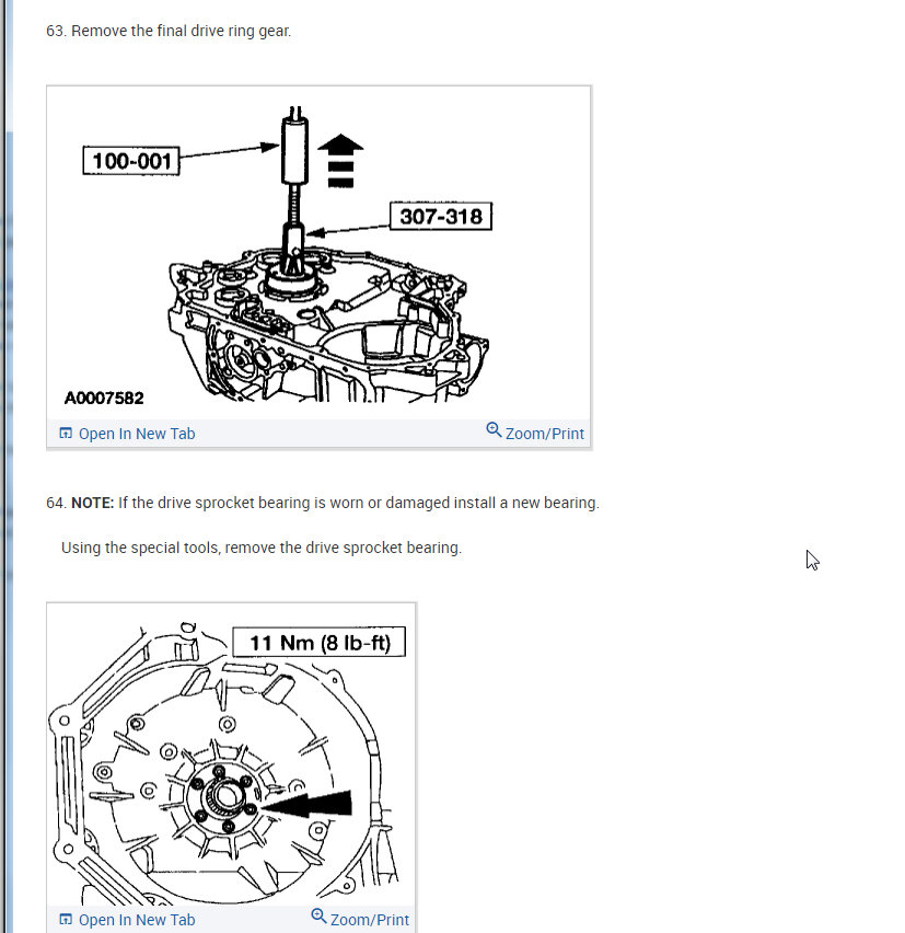

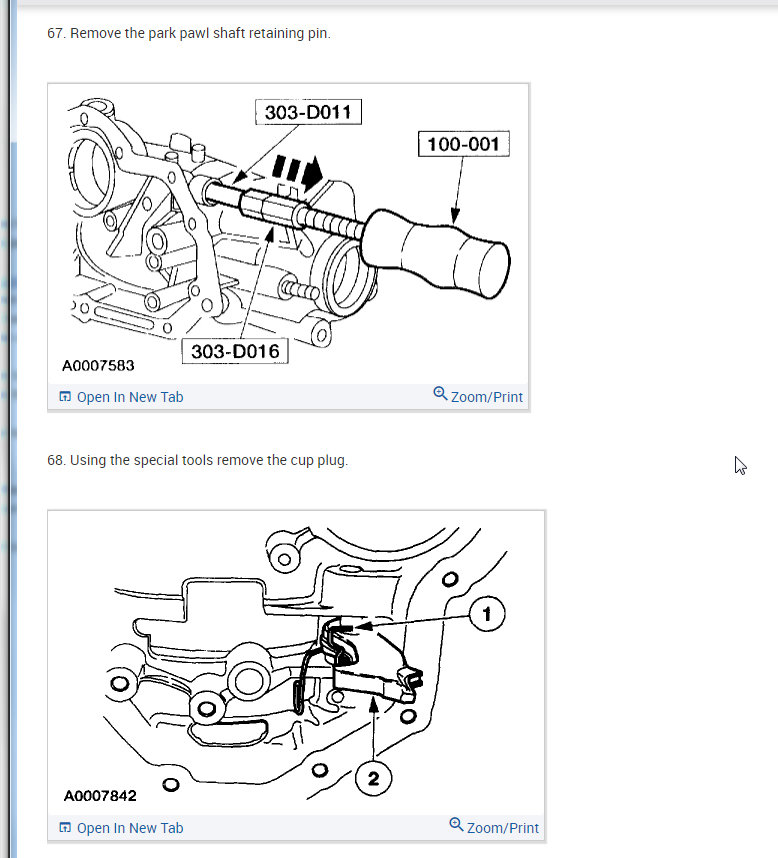

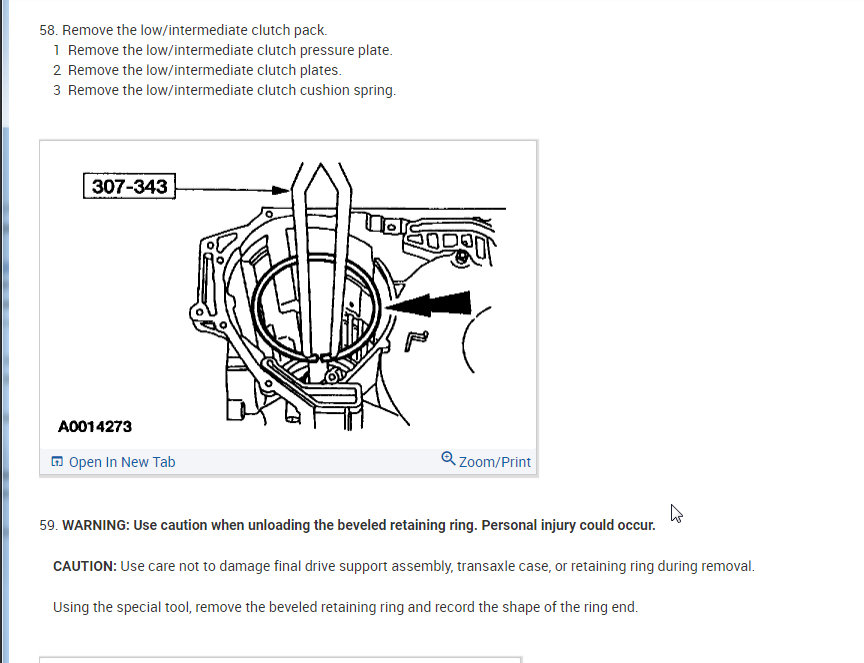

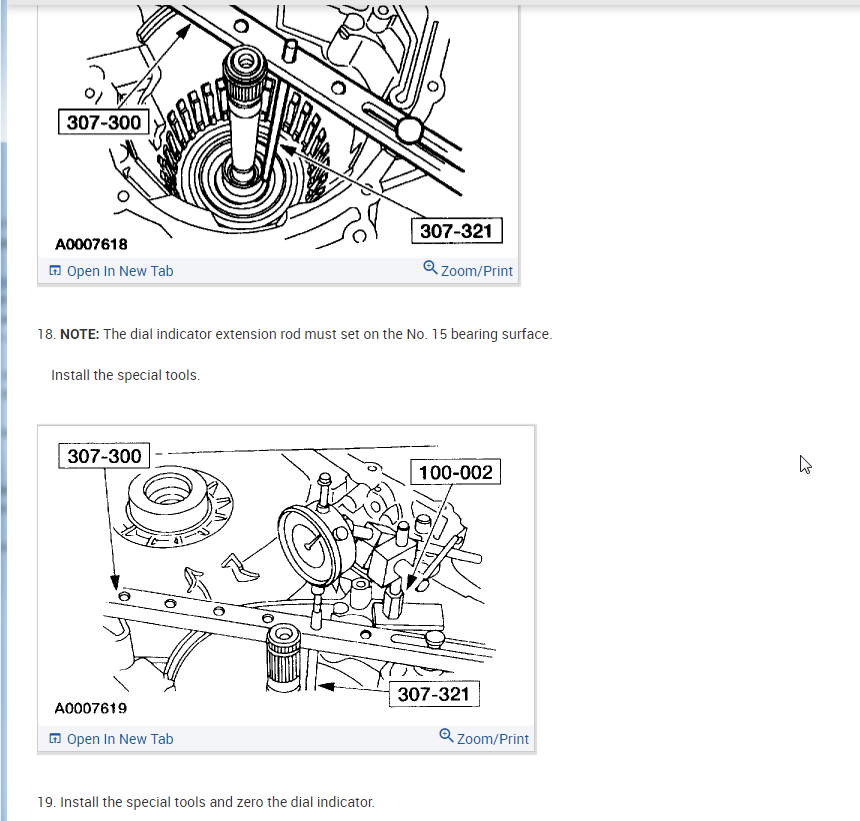

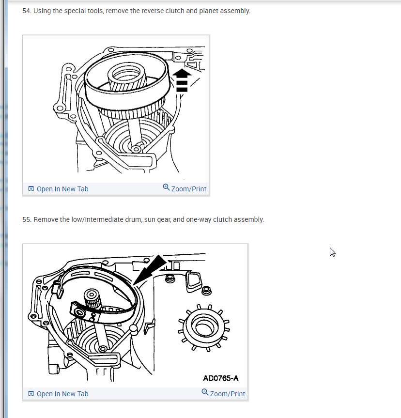

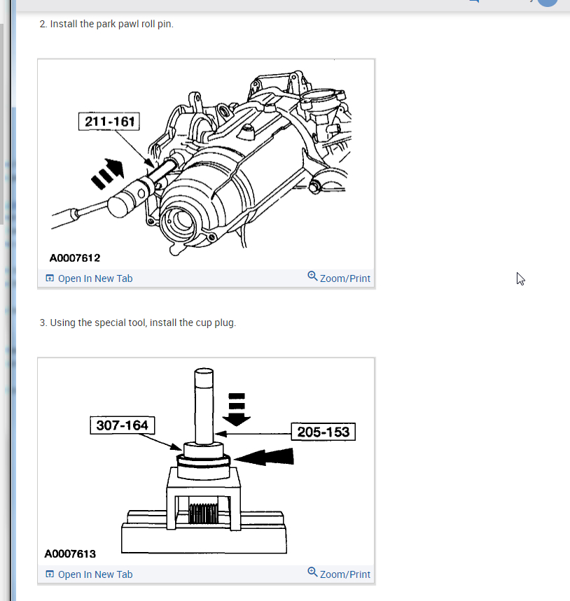

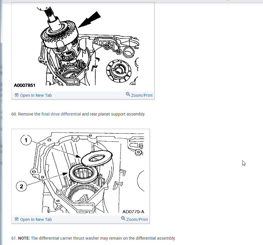

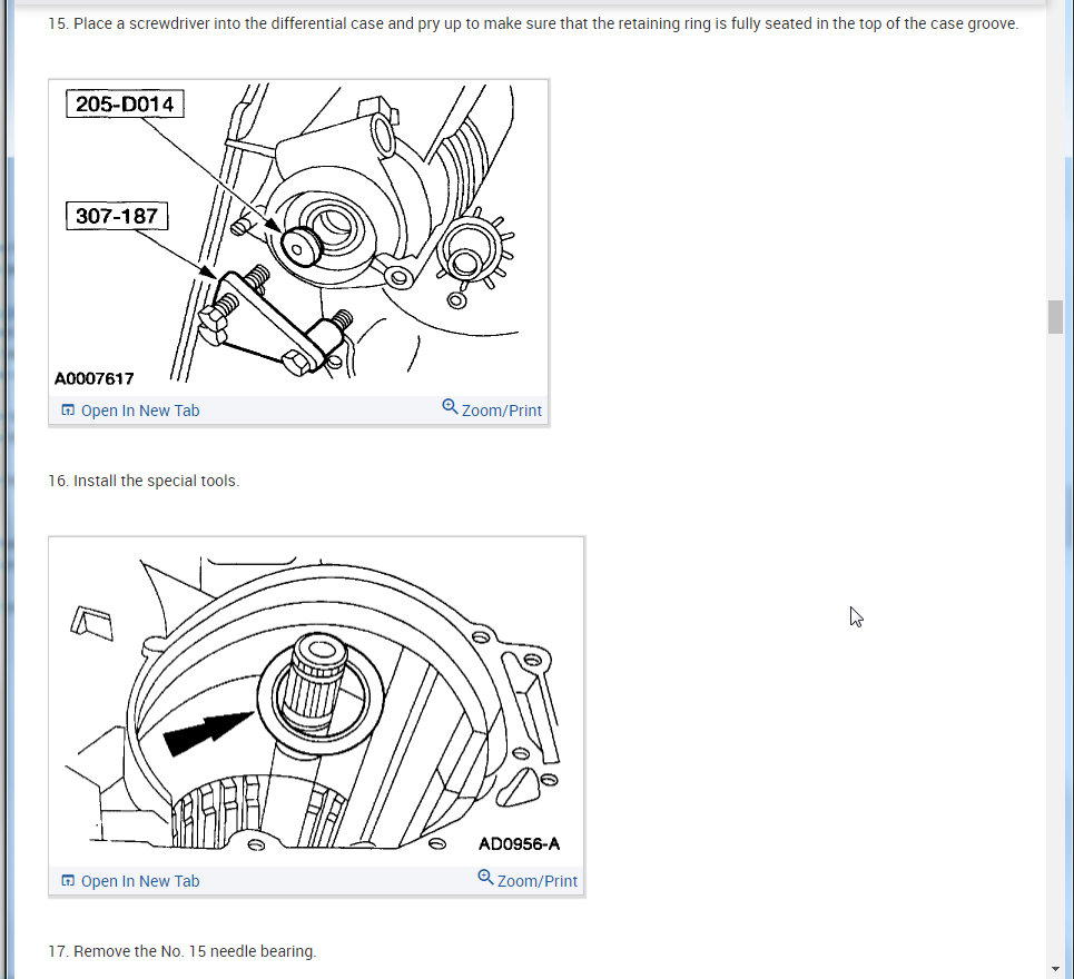

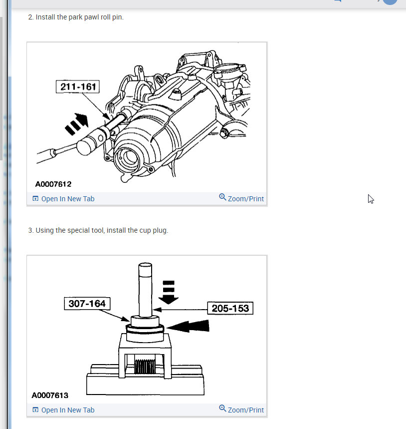

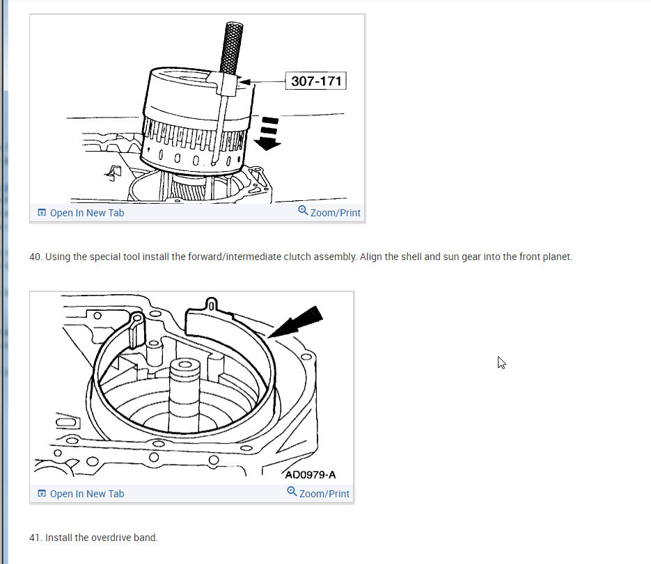

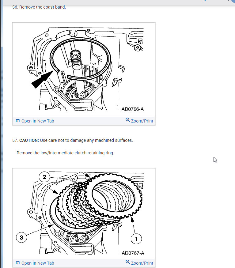

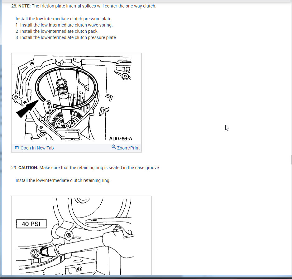

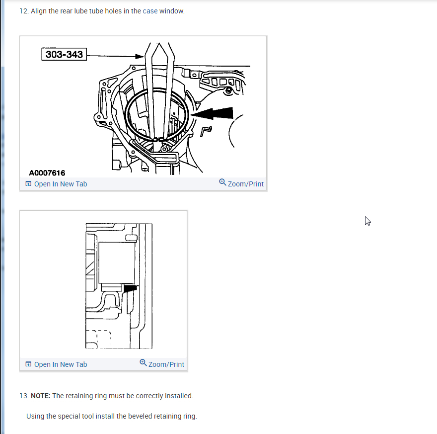

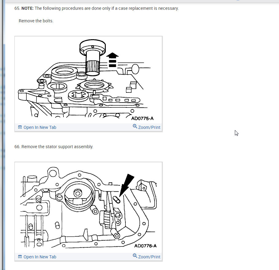

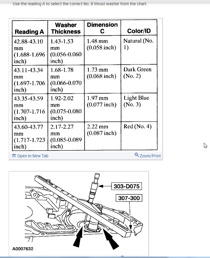

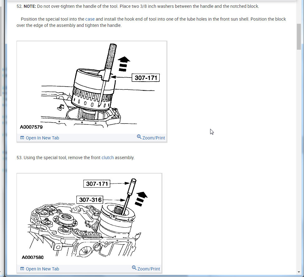

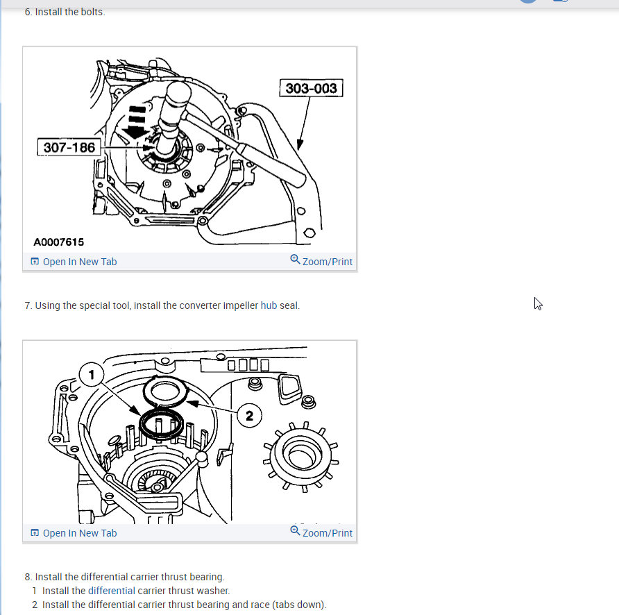

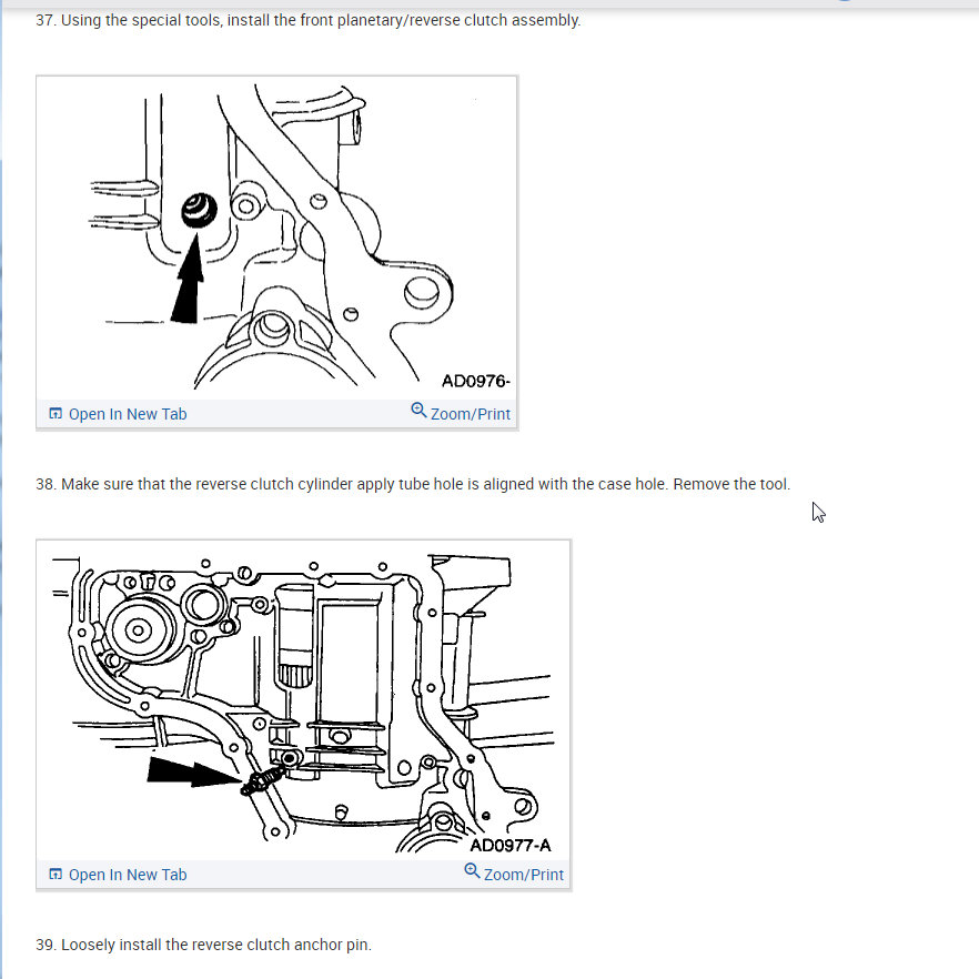

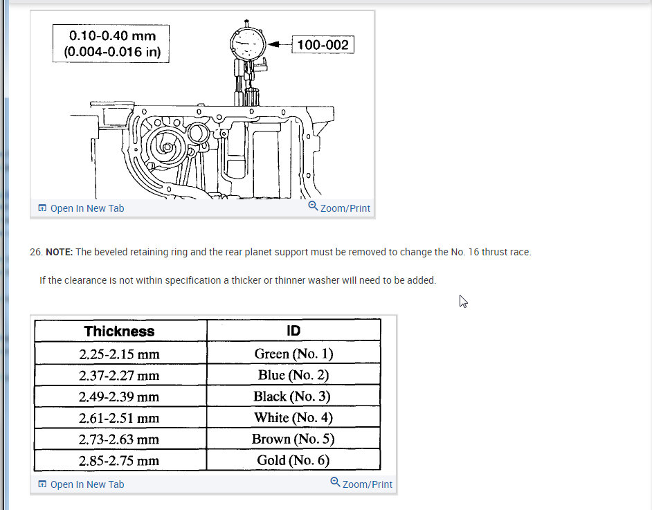

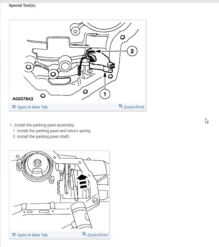

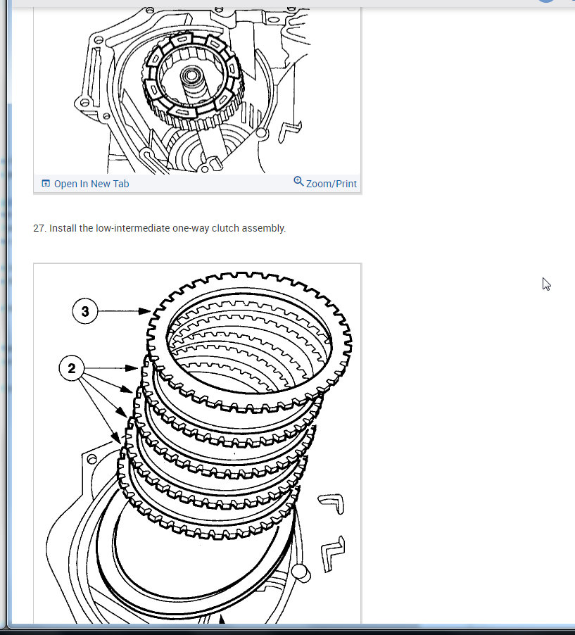

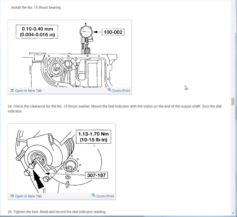

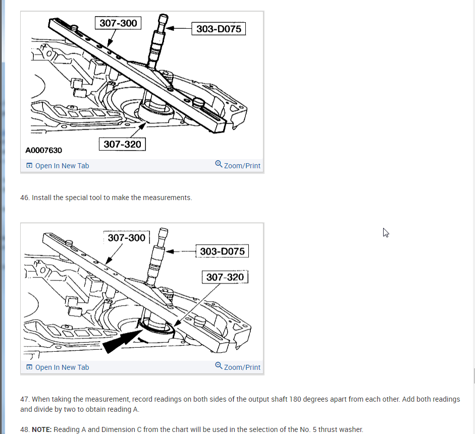

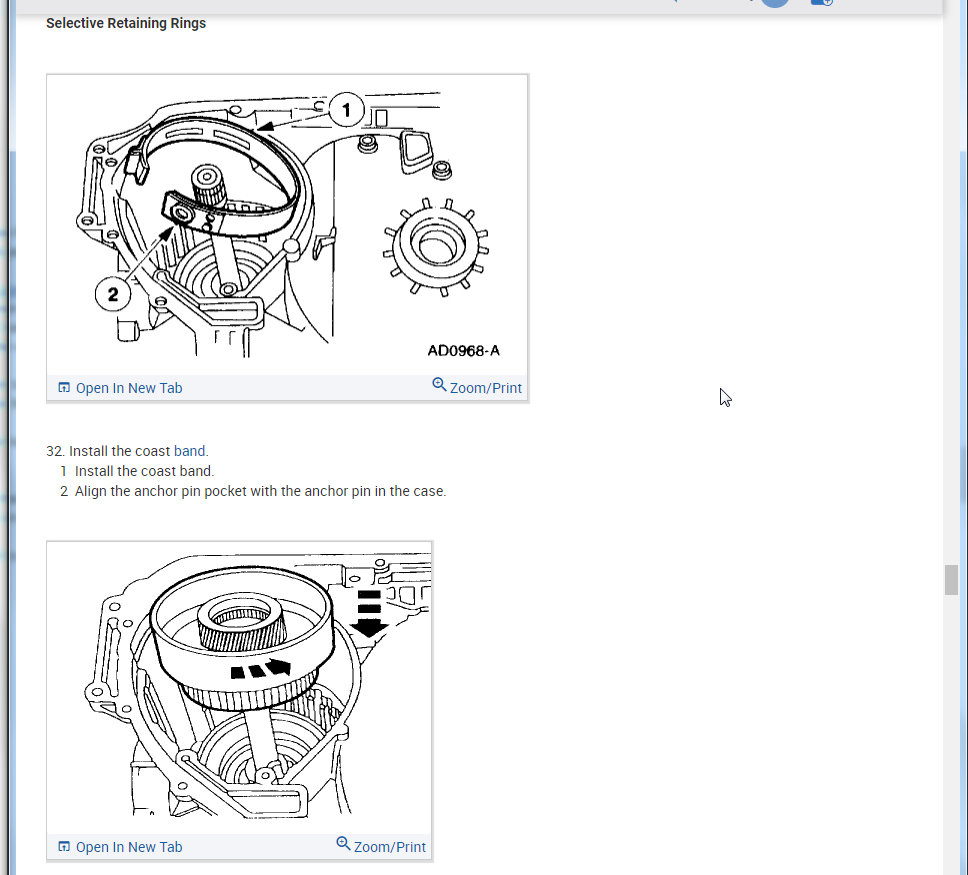

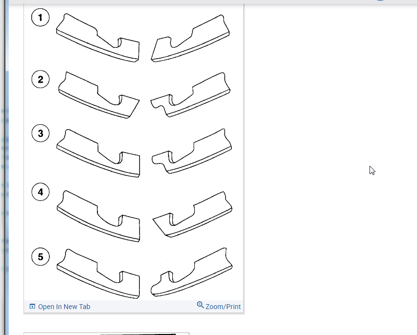

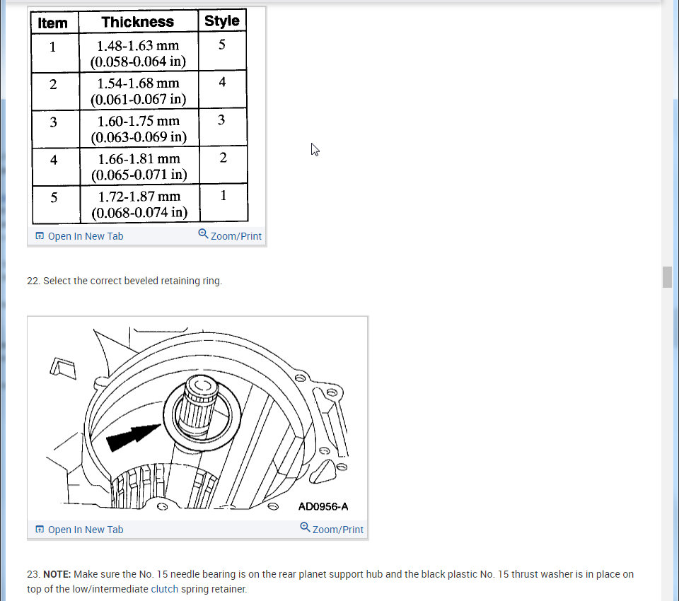

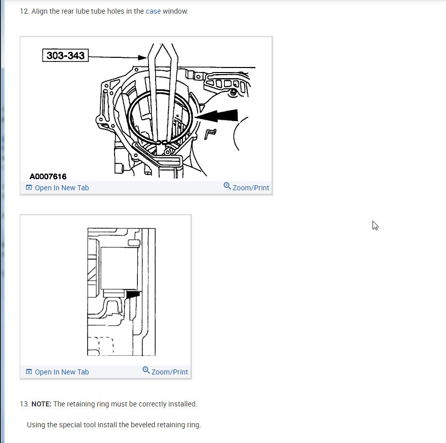

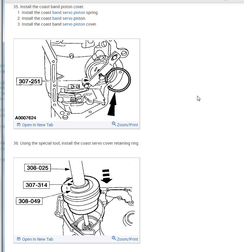

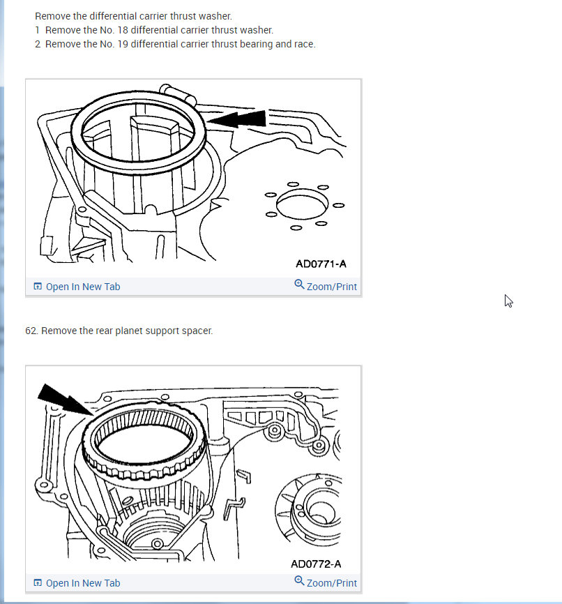

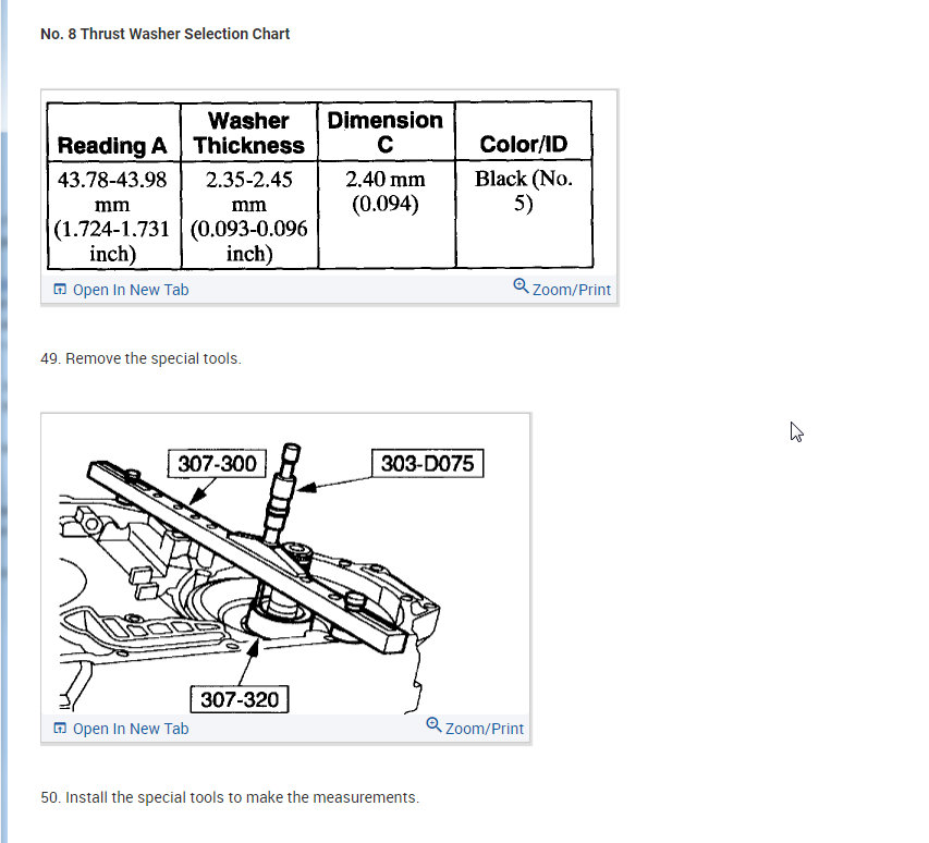

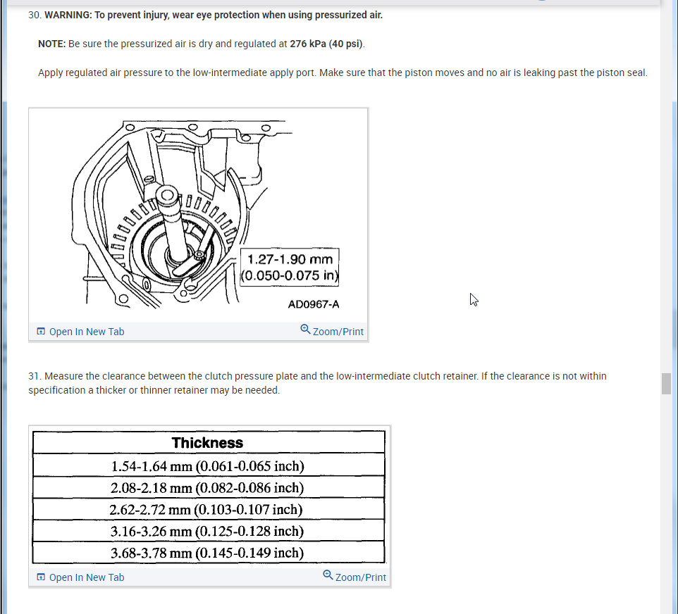

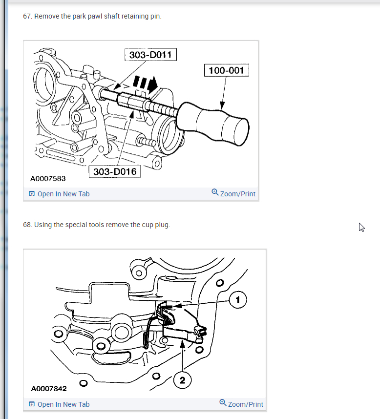

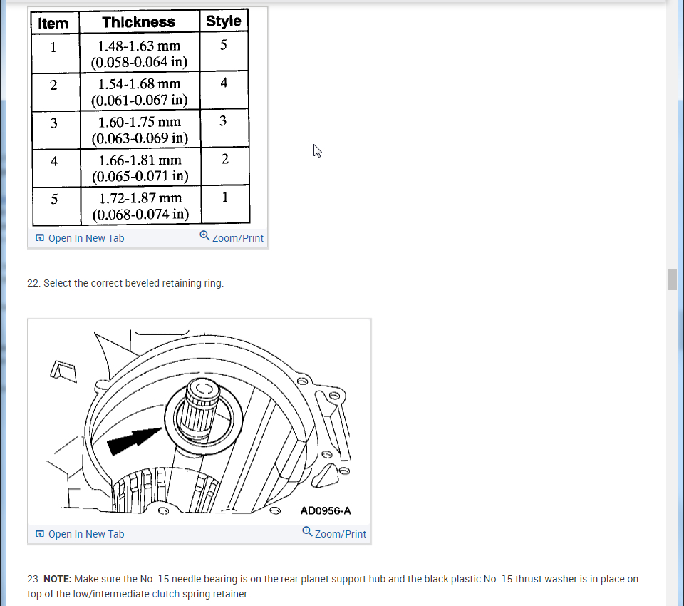

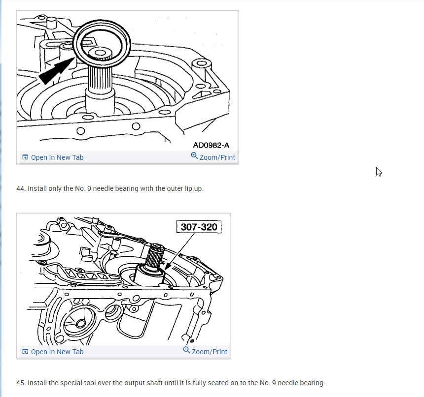

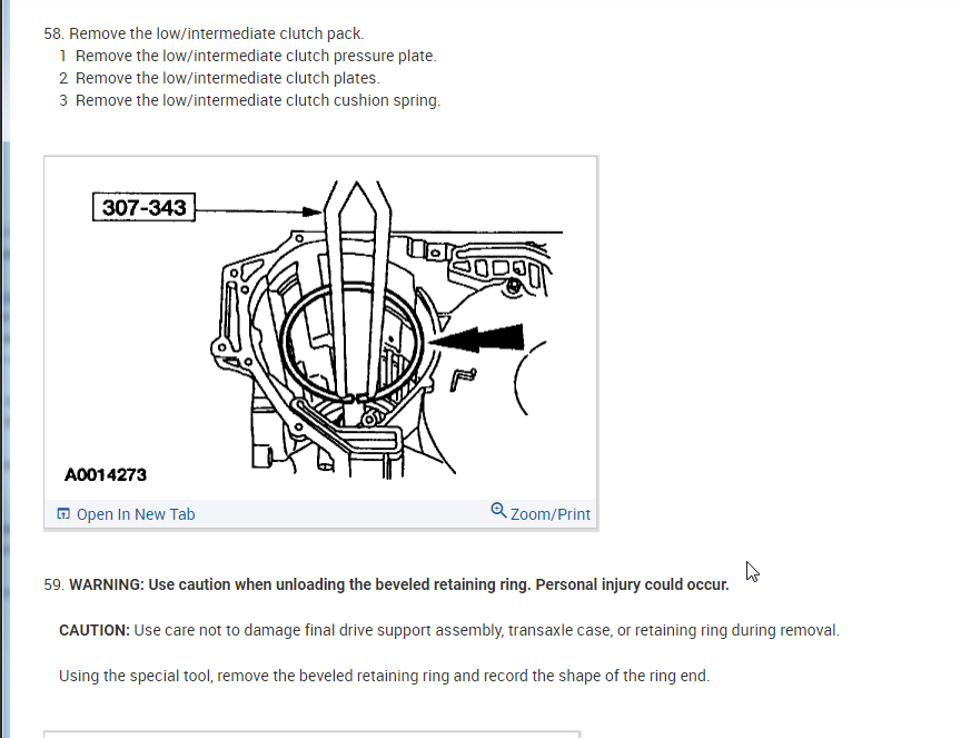

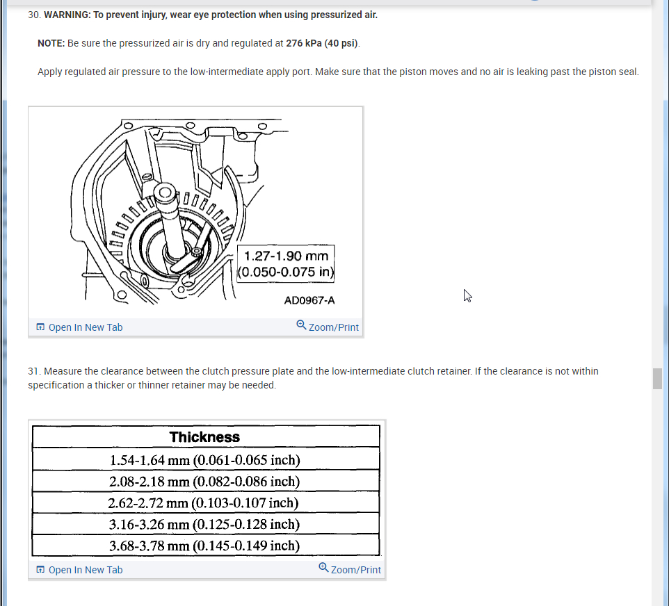

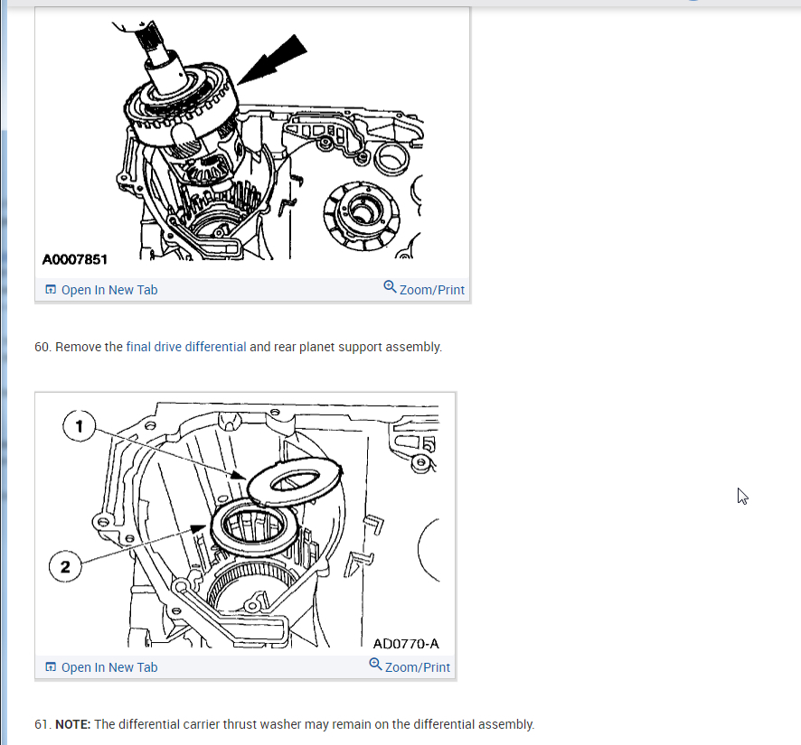

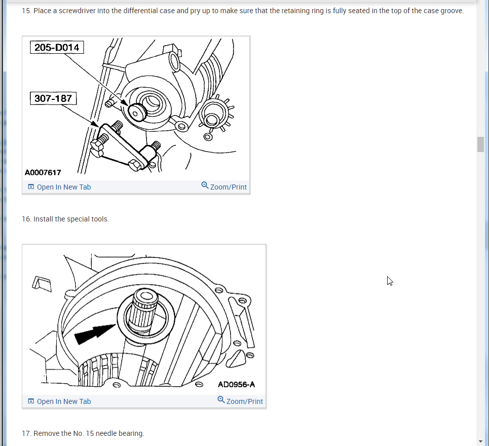

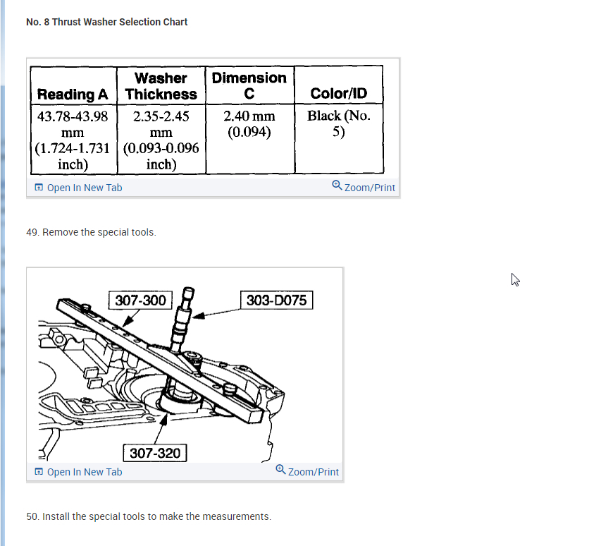

Remove and replace differential carrier bearing on the passenger side of the van listed above.
Apr 7, 2021 at 8:40 AM

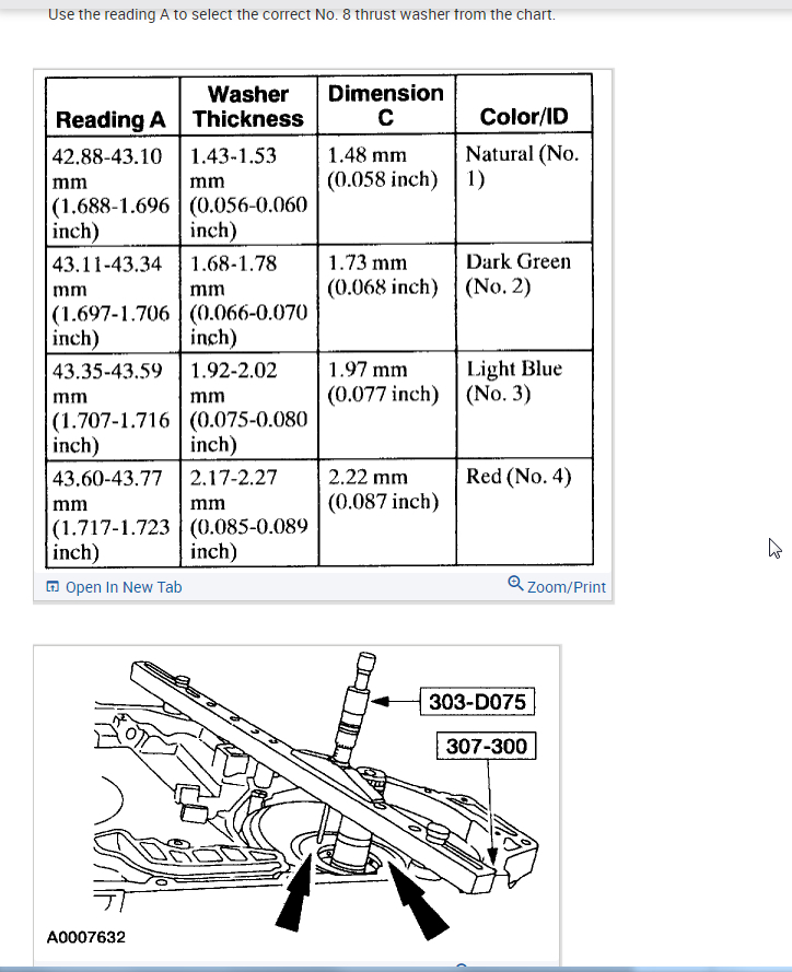

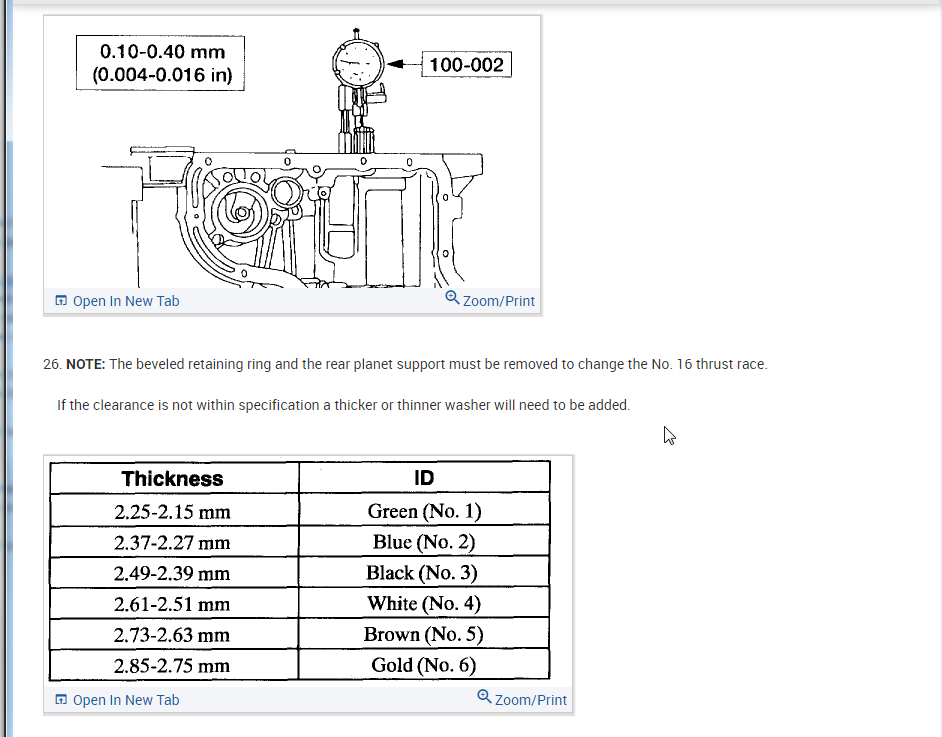

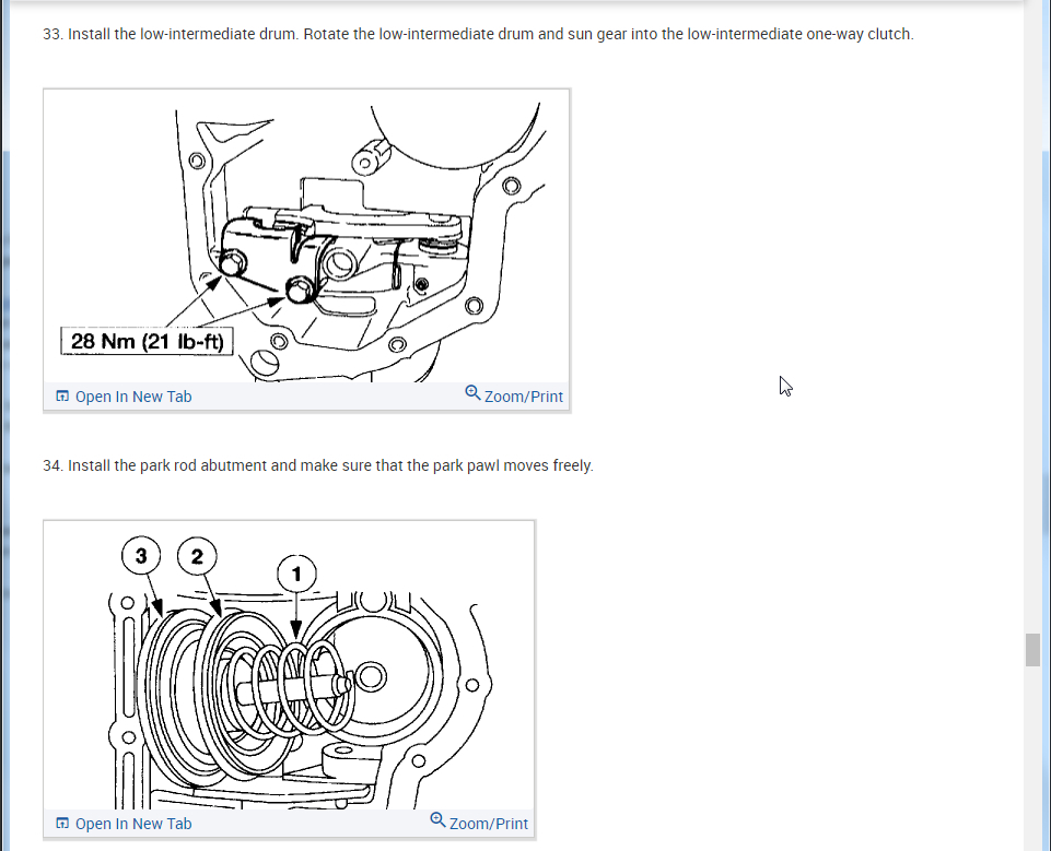

I am attaching the entire process from the manual below on how to remove the final drive assembly and then reinstall it with new trust bearings.
Just make sure you follow the measurement steps closely otherwise you will have noise and wear and just have to pull it back out.
Let us know if you need other info. Thanks
