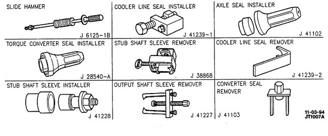

on the passenger side of my 1997 cavalier, the bearing inside the transmission is humming. I'm talking about the one behind the seal on the passenger wheel.is it changable from the outside of the transmission?

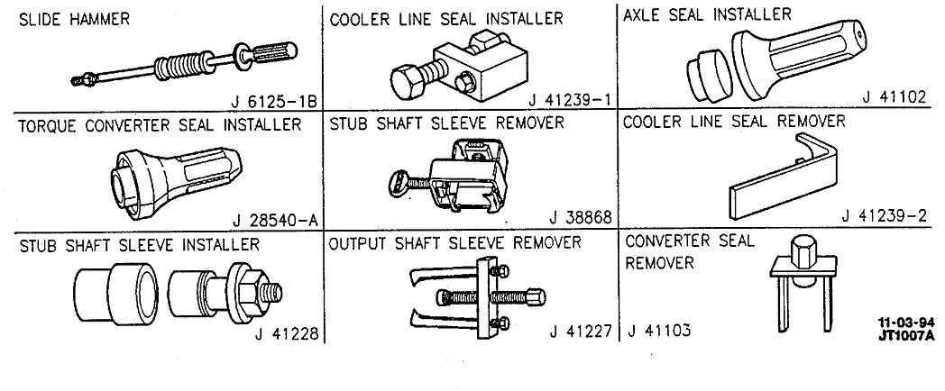

Yes, it can be replaced in-car, but that is not going to solve the noise. The tool you need is number is J 41227 shown in the middle of the bottom row in this drawing.

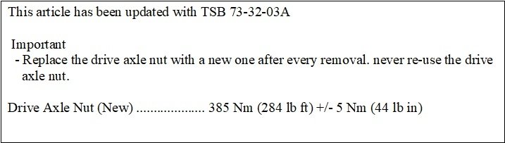

Also be aware that with all types of these wheel bearings, they will instantly become noisy if any vehicle weight is placed on them when the axle nut is not tightened to specs. That even occurs when there's no engine or transmission in the car and you push it across the shop. The new bearing nut must be tightened with a click-type torque wrench before the car is set onto the tires. The most common torque spec is 180 foot-pounds, but a few imports call for considerably less. Some GM vehicles specify a lot more. This is a perfect example, as shown in the second drawing. This is a "torque-to-yield" nut, meaning the threads peel a little when it is tightened. Those nuts are supposed to be replaced after they've been loosened for any service. Most new wheel bearings come with a new nut when they're required. Also note the really high torque spec for your car. They list 284 foot-pounds which is more than most large trucks call for.
