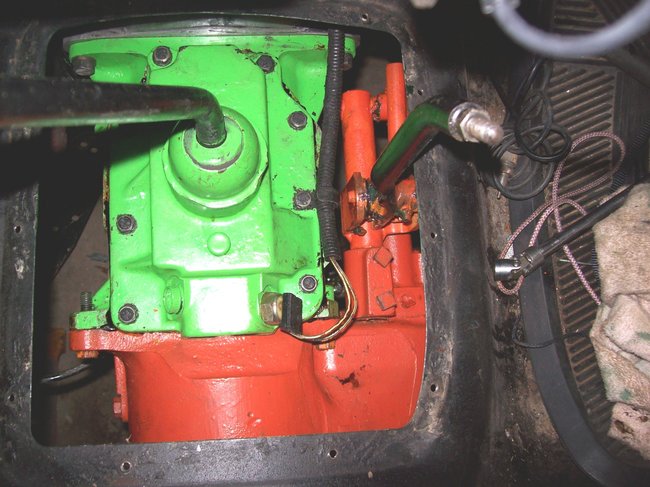

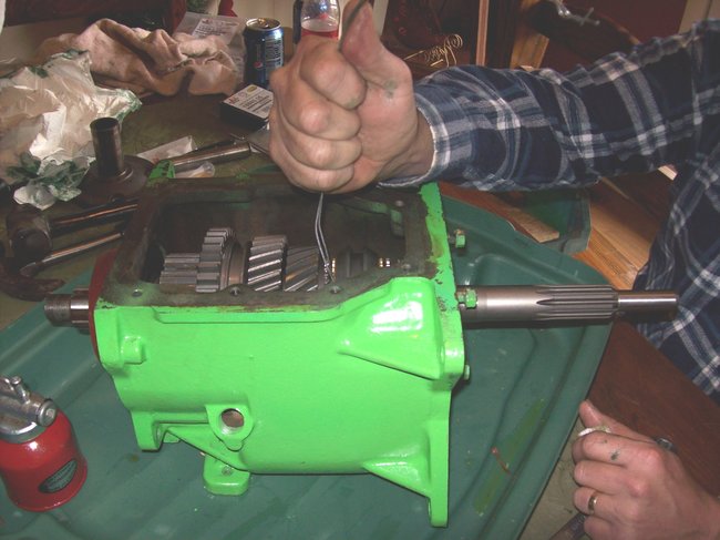

BELOW IS A PIC OF MY 3 SPEED JEEP MANUAL TRANSMISSION WHILE I WAS REBUILDING IT,
YOU CAN SEE THE FILL HOLE ON THE SIDE, BEINGS THAT IT IS A MANUAL TRANNY THERE IS NO FILTER, ON MINE, THERE IS A DRAIN PLUG ON THE BOTTOM.
WHEN MY TRANNY JUICE STARTS TO COME OUT OF THE HOLE, IT IS MAYBE A LITTLE MORE THAN HALF FULL IN THE CASE. THIS IS NORMAL! MY TRANNY SLINGS THE TRANNY JUICE ALL OVER THE INSIDE WHILE IT IS MOVING.
THE ONLY DIFFERENCE IN THE "PROCEDURE" IS
I CAN SIMPLY CRAWL UNDER MINE TO CHECK OR FILL IT!

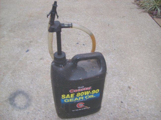

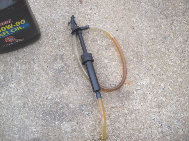

OTHER PIC IS A $5 PUMP FROM AN AUTO PARTS STORE THAT I FILL WITH (NOTE: MY FLUID IS NOT THE SAME AS YOURS!)
