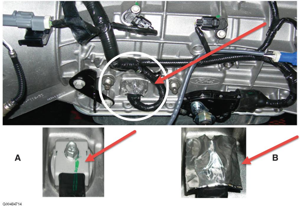

what im gonna do with a P0750, p0753,p0755,p0758, p0760,p0763,p0765, p0768 codes using a ford vcm on a 2008 ford explorer. We already replaced the transmission solenoid pack ,checked the wires for corrossion but still no luck. when I turn the engine the information center says "check parking aid" with the yellow wrench tool sign ON. We already overhauled the transmission. After a reset of the ECU, then I start the engine the warning light tool LITS ON eventhough i havent yet drove the car. which led us to replace the tranny's solenoid pack, but the problem was still there. A bang occurs as if there is no power on the solenoids. Thanks

did you check the battery like I said in last reply a low battery can cause false codes to pop up. the communication module doesn't have much to do with transmission unless you are talking about the pcm-powertrain control module.there is a tsb on certain solenoid problems from the ac drain you migh tcall the dealer to get it fixed as it might do it for free. If your build date is prior to 8/12/2009 this problem would be effected. this has to be removed (connector) then cleand of allwater and have dielectric grease put over it then covered with tape as shown in pictures.

yes, it still has a good battery, i checked on the clamps they are ok. cleaned the harness and fuses as well. there is a good battery voltage on the #3 wire going into the solenoid pack. this is a 5r55s transmission - it is common for these transmission to have a servo bore problem but when it was opened the intermediate bands and servo were ok & not cooked, , when it was scanned it didnt have the "incorrect gear ratio" code as described on its TSB.
