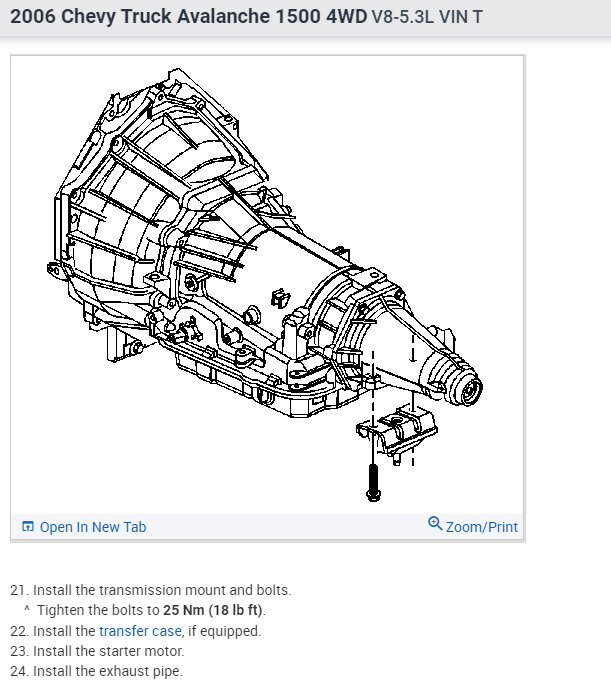

Where i can find transmission and transfer case in Canada and how much it cost and who you suggest best place to replace it?
Thank you so much.

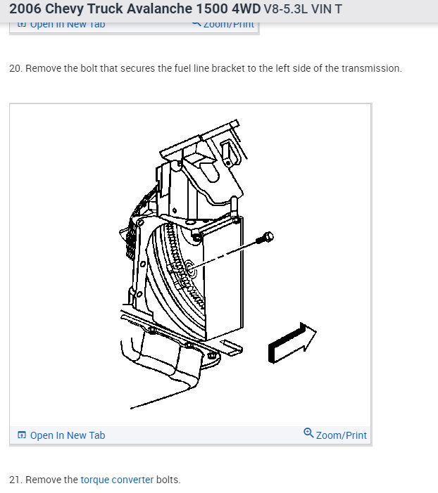

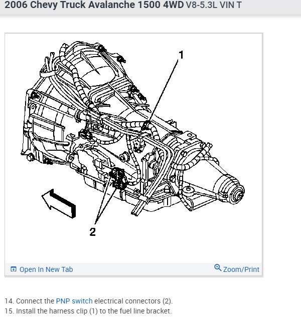

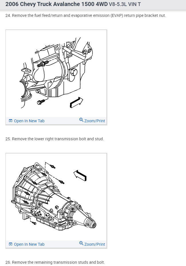

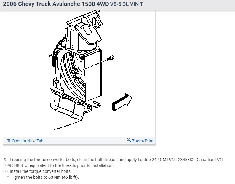

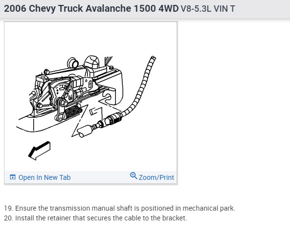

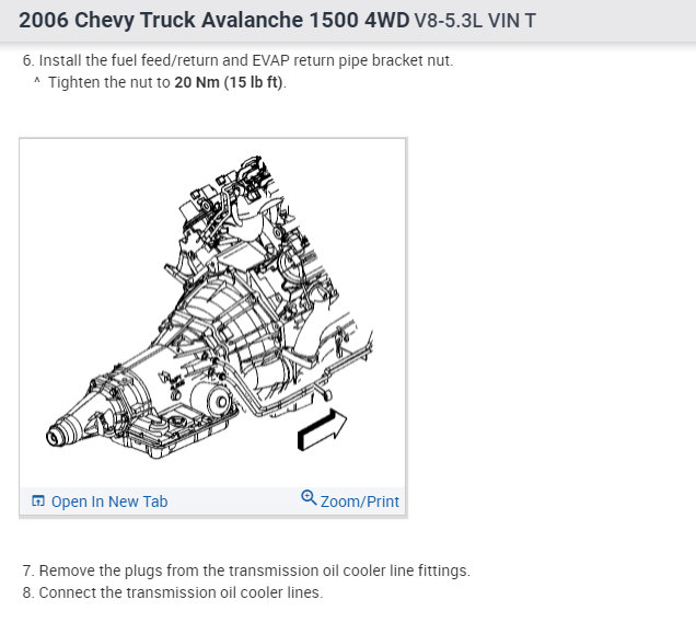

There are many local salvage yards where you can possibly get a used transmission and transfer case. Of course, you can also check with your local Chevy dealer as well.
Here is a good website that has connection to various recycled/used parts:
https://autorecyclers.ca/
The prices will vary depending on the condition.

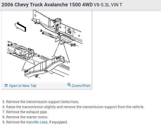

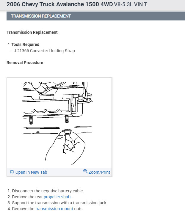

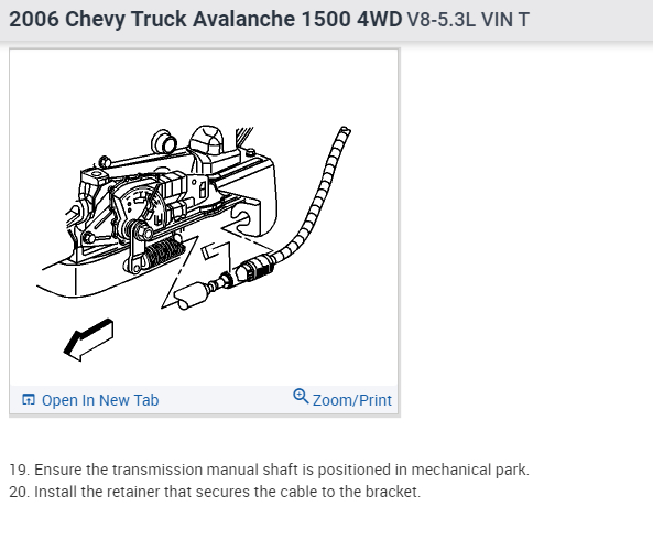

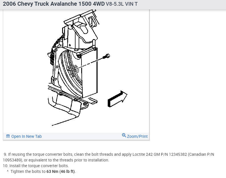

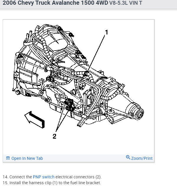

Also, if you have it installed in a shop the cost will depend on their shop rate. On these trucks the typical labor time is 9 hours.

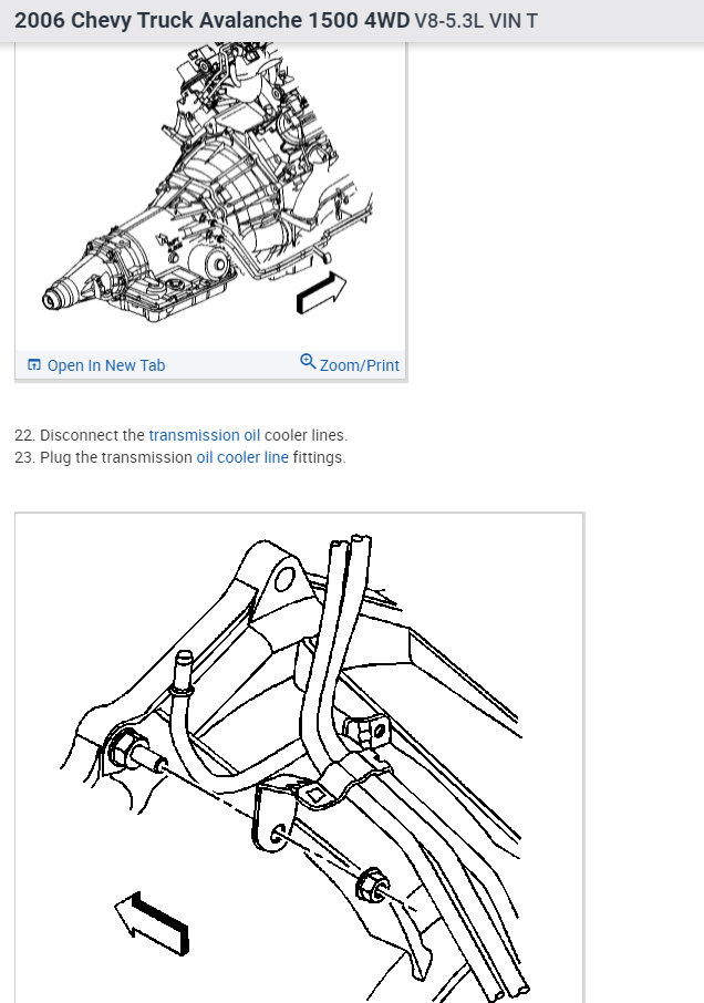

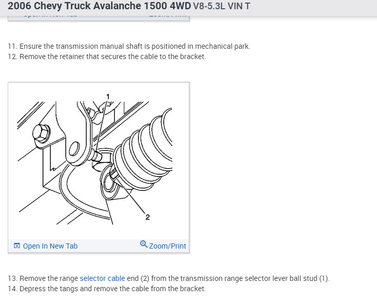

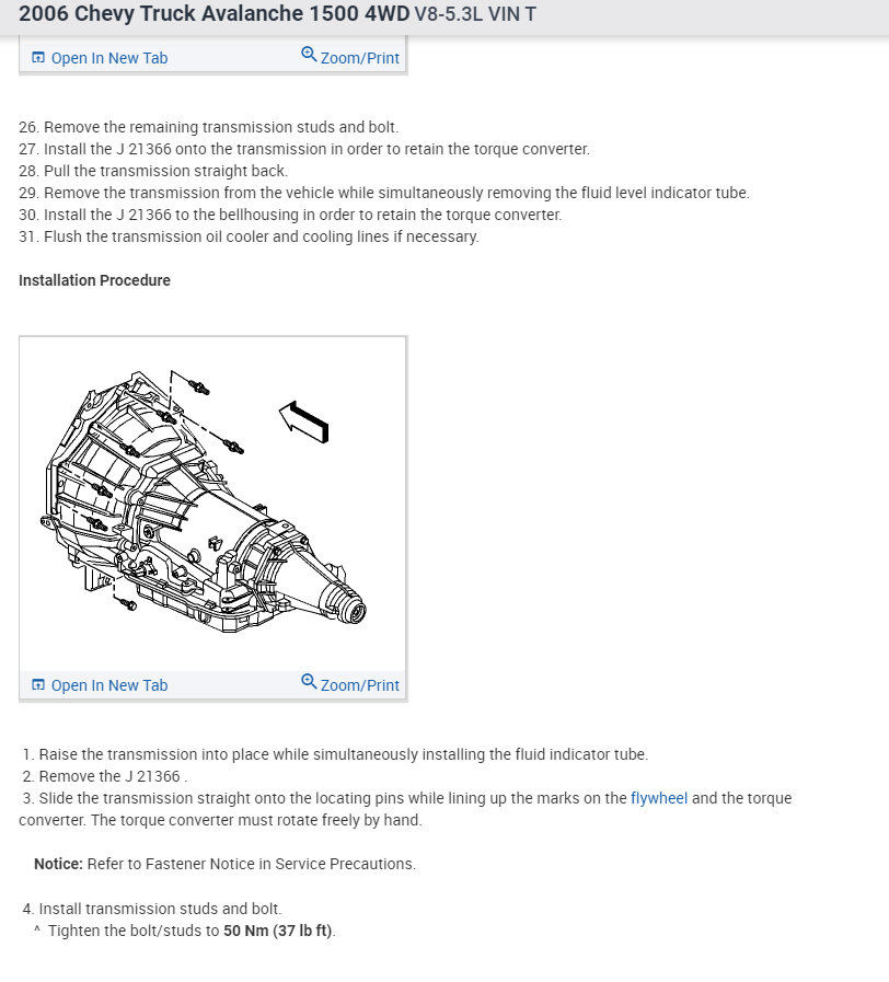

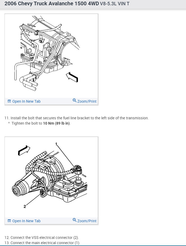

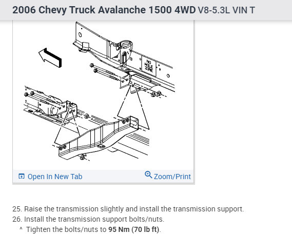

I have attached the transmission replacement procedure below for your reference.
