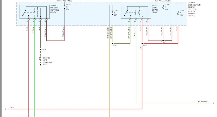

While slowing down I feel a clunk sound, transmission will not go into overdrive
2002 CHRYSLER CONCORDE
157,000 MILES • 3.5L • V6 • 2WD • AUTOMATIC
JESSE FRANK
  • 8 POSTS
Then when I pick up speed again it wont go into overdrive. Have to stop and shut it off then it does good until I slow down again.

Good morning,
Are there any codes in the system?
I would start by changing the fluid and filter in the transmission. It sounds like a valve in the valve body is sticking.

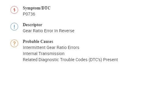

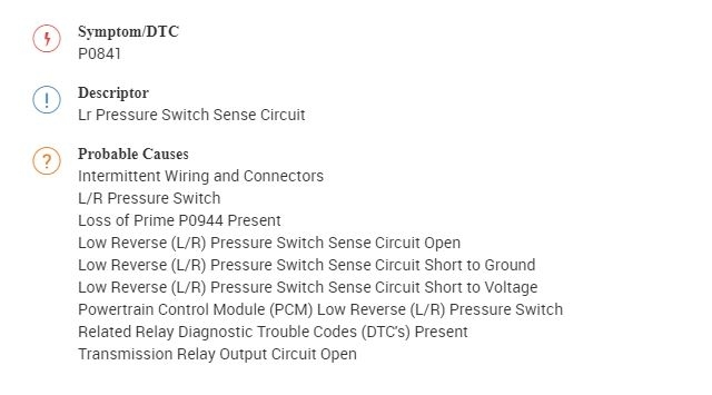

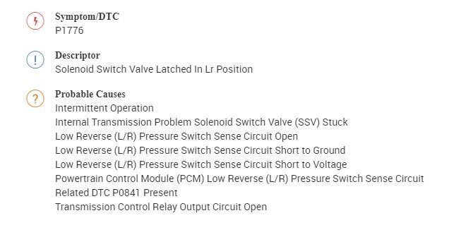

Yes there are codes. Here is what I have: Po736, po841, p1776, p0300, p0700, p0481.
Apr 4, 2020 at 2:03 AM
Thanks.
The 700 is an information code.
the 300 and 481 are engine codes not related to this issue.
I posted the possibilities for the other 3 below. They all indicate electronic controls such such a sensor voltages and returns. You will need an advanced scan tool to monitor the live data for these sensors and solenoids.
The one code for 736 is my concern. It is indicating excessive slipping inside the transmission from worn clutches. This is an indication the transmission will need either a rebuild or replacement.

When I bought the car there was a transmission solenoid. And a transmission filter in the trunk. Should I change all that and new fluids first?
Apr 4, 2020 at 7:26 AM
You can try but I doubt that will resolve it for you.
Sounds like someone was guessing.
